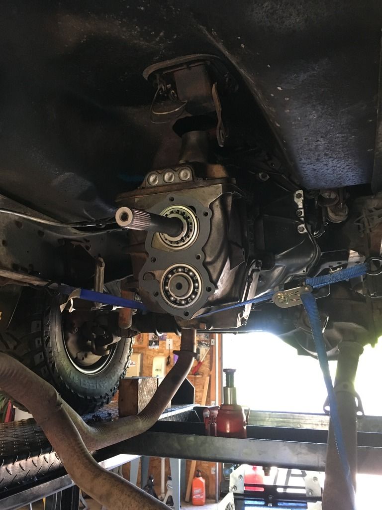

        Got the trans, shifter, and distributor back in this weekend. Still on the list: clean up and install tcase, fill with fluids, weld an exhaust bracket i had to cut, install driveshafts and it should be back on the road (until the next project ). A very useful tip for installing an SM465... Press the clutch pedal while sliding the input shaft home, or it'll never line up!
        After this i plan on doing a fuel filter, new radiator/hoses/coolant, and considering the wrong fluid was in the trans its probably worth a drain/refill on the axles as well. Oh, and dual exhaust.
        This was my clever way of suspending the trans so i could reconnect the exhaust (jack/stands would be in the way)

          Maybe I missed it, but did you only have to change the fluid in the trans to the proper stuff or did it need a rebuild?
          Sent from my XT1080 using Tapatalk
          • #65
            Inspection was fine. Conclusion was the guy had motor oil in the trans instead of gear oil and it wasnt thick enough to prevent the trans from making some pretty significant noises once hot. I managed to find the correct 85w-90 gl-4 gear oil (cant use gl-5) so hopefully this solves the problem. if not then thats just the way it is, i dont need to worry about it.
