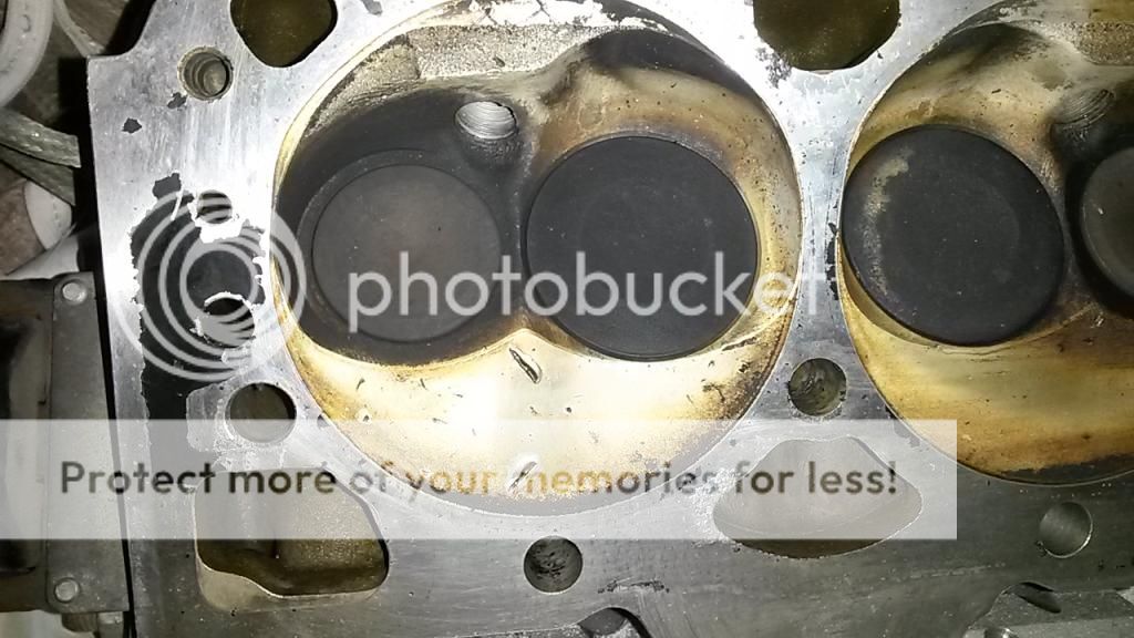

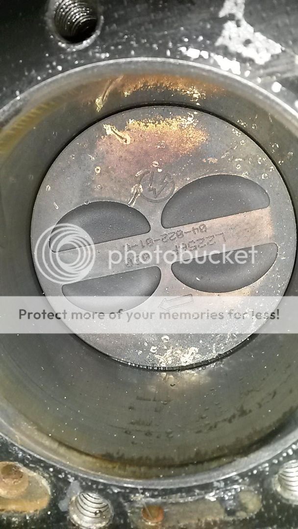

            • Here are a couple of pics of the other head and piston:
              As you can see, these were damaged as well, though not nearly as bad. The piston definitely needs to be replaced, and those two deep indents in the head need to be fixed.
