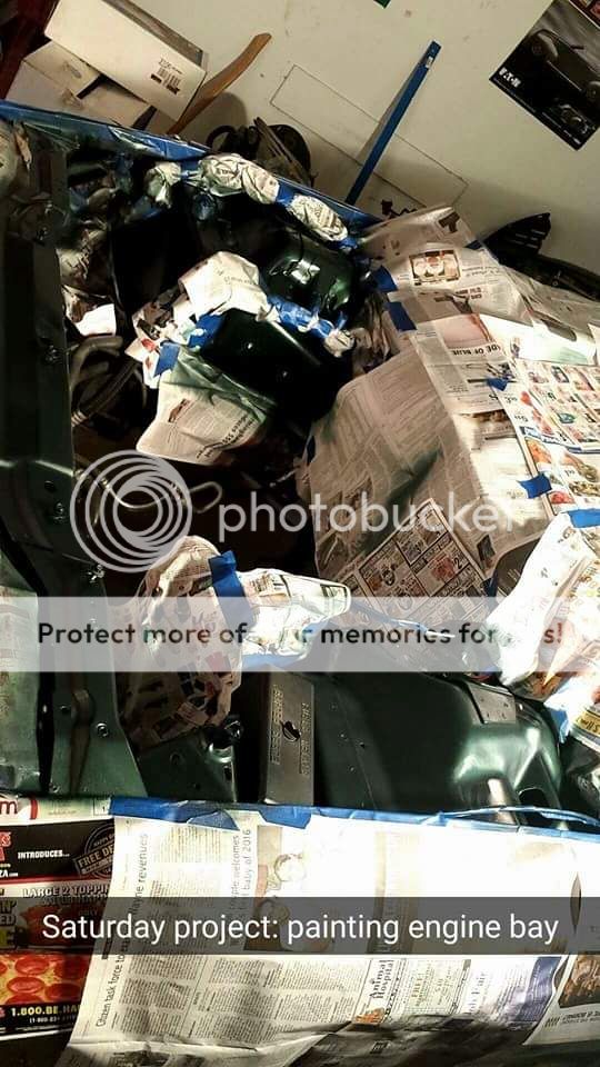

                                Did some painting in the engine bay:

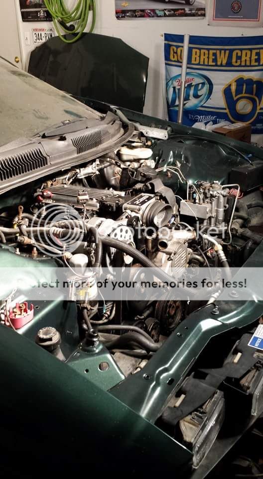

                                And finally, on Sunday afternoon I got the engine back in!
                                The ambitious plan is to get this thing back on the road in time to take it to my friend's wedding in Wisconsin, which is on June 11th. Now that the engine's in, I can really get cranking on getting everything connected and whatnot, especially now that I have a good heater setup in my garage.
