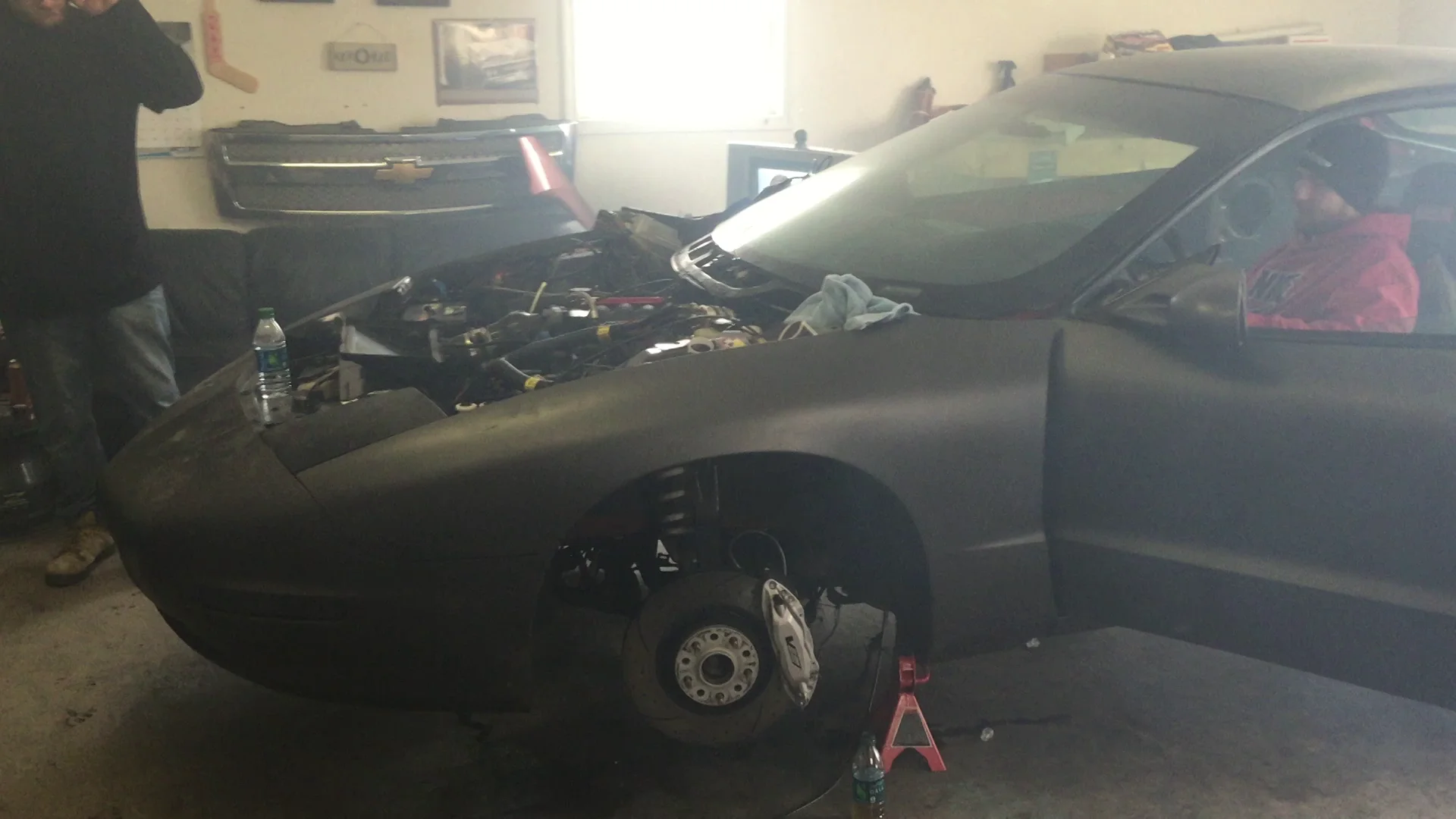

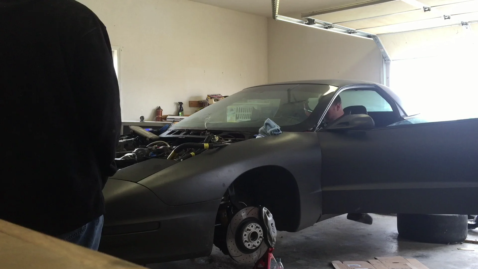

IT'S ALIVE!!! this was the first fire up, it had a huge vacuum leak so it's was struggling to stay going. It's open headers right now, I've got a ORY and a Magnaflow 6" race muffler that's going to go on it eventually.
This was after we plugged the vac leak and got it to idle smoothly. Only CELs it's got right now if for trans stuff because it thinks it's an auto. I've got to replace the clutch master cylinder, cut the rad support to fit a SLP lid, and then put the radiator back in and it'll be ready for the road!!

I think you need to change Tach Output Resolution High and Low values to 3 to work with the LT1 tach.

i won't be doing the tuning myself, but i'll pass the message along. the tach was working, in the second vid it sat at about 1k then dropped to 400rpms to idle. i'm not sure if that's accurate though with what you mentioned not done.sigpic

400 is way too low of a reading, you should be almost twice that at idle on the tach. 3/3 should put you close, LS1 is 6/6 hi and low for the tach.

ok thank you, i sent my buddy with HPT a text reminding him to do that. i thought it seemed low.sigpic
