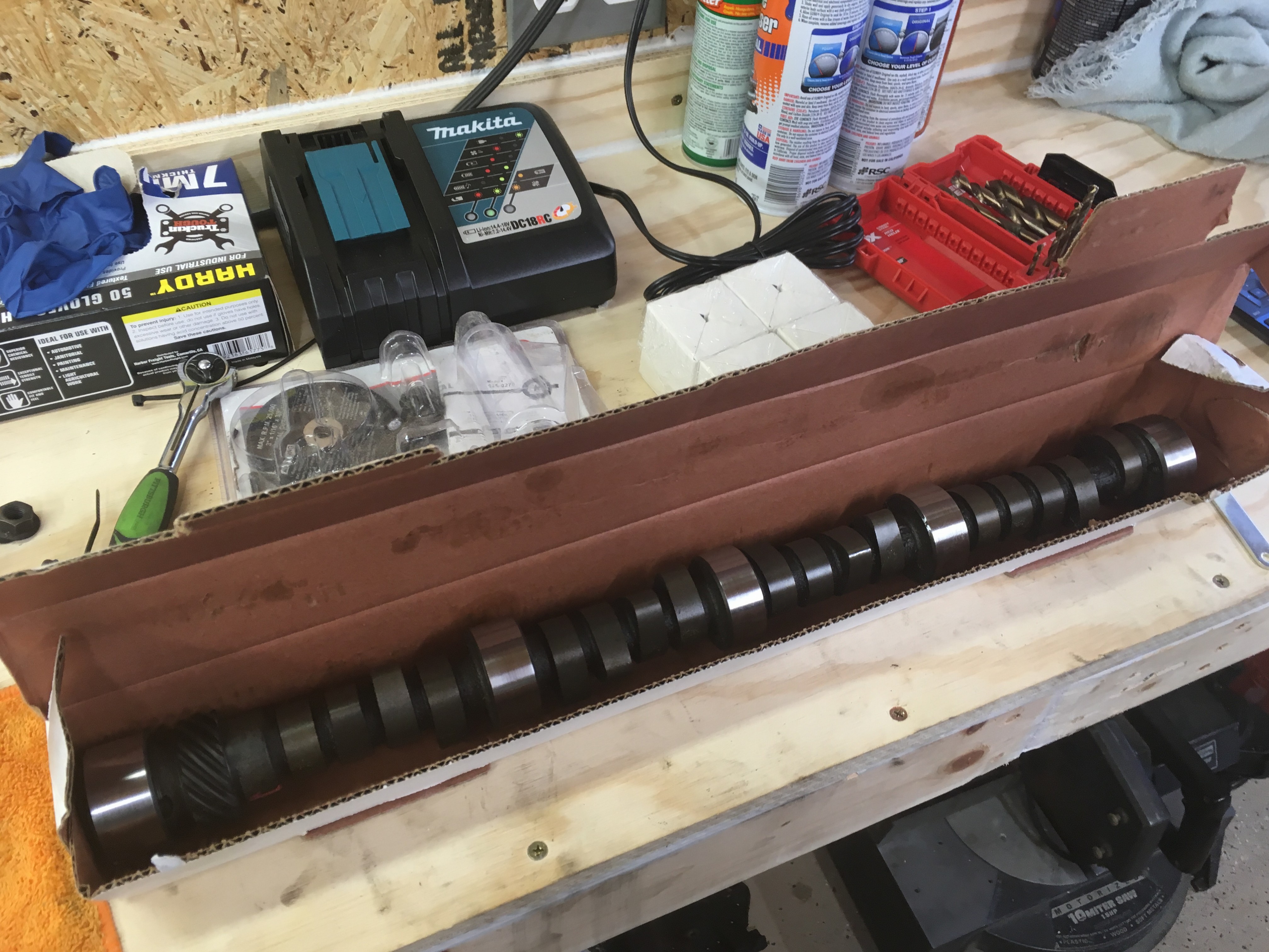

          • 204/214 cam has been SHIPT! ... Oopsie.
            • I hate those accidental purchases like that. I guess the only thing you can do is accidentally install it!
              • Gotta love summit. Cam and lifters at my door less than 24 hours from making the order.
                • Excellence!
                  • Small progress from last night, torn down even further. And a bump stick.
                    • So is that a Summit cam?

                        • Kyle, yes its a summit cam that is essentially a regrind of an Edelbrock performer towing grind.

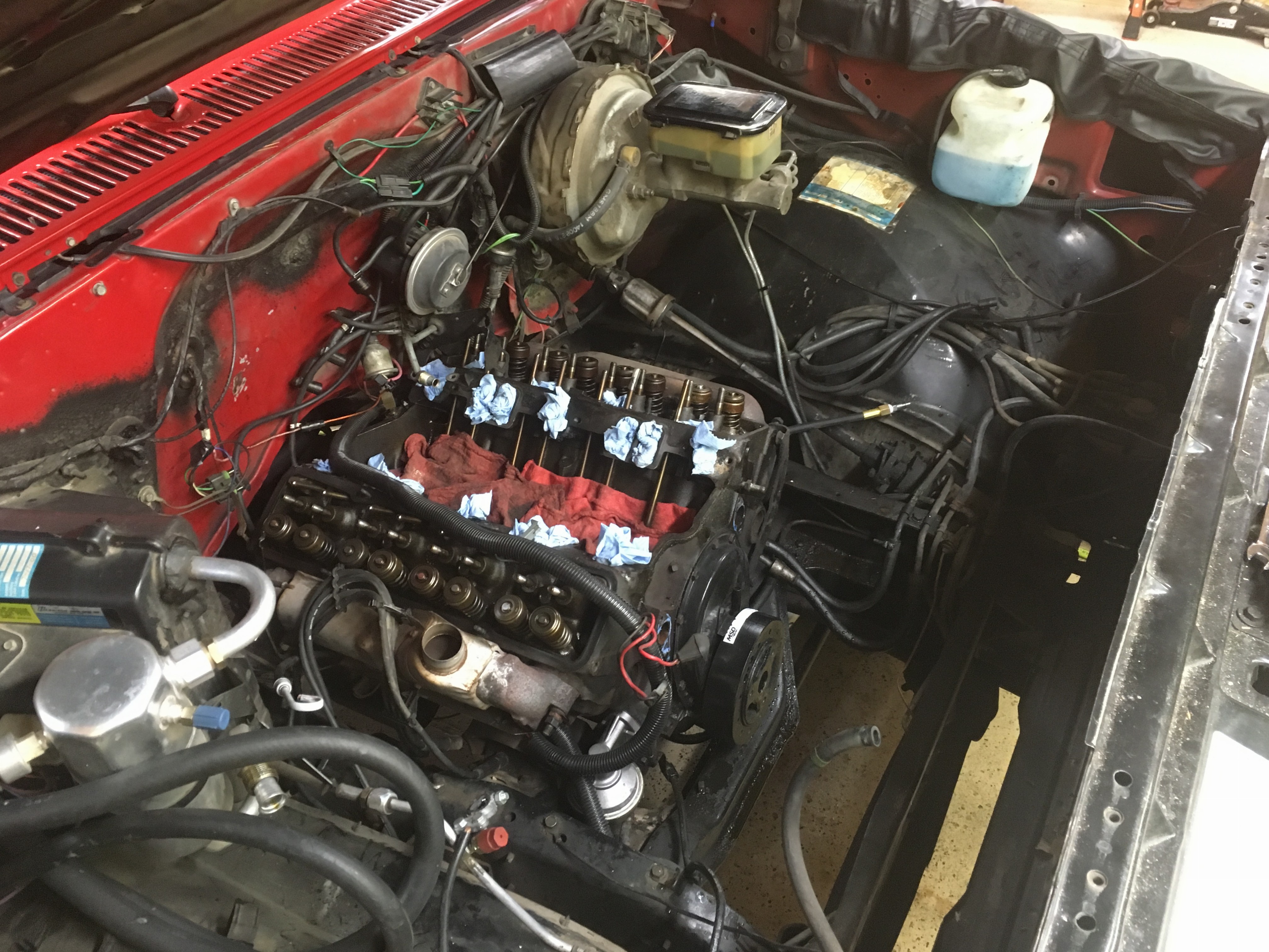

                          Yesterday I got the cam out and 13 of the 16 valve seals replaced. I'm going to have to fabricate a lower profile valve spring tool to get the last three seals. (brake booster is in the way). Thought I was going to have to cut the center bar of the core support to get the cam out but i managed to muscle it out of the way enough to spare it.

                            • Maybe? Thats probably just about the amount of room I have there but I'm also having a hard time picturing how that unit works. what does it hook to and how do you access the locks?
