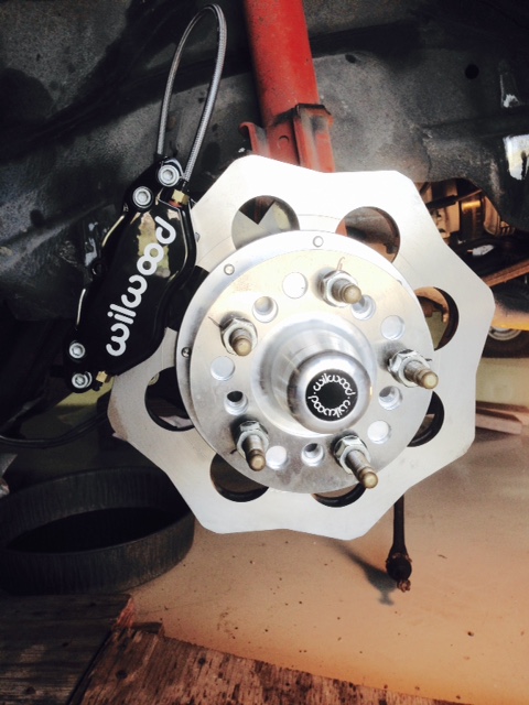

                          • Not much has been done other than some number crunching. It seems it could be possible to get the car to hit 3100lbs with a full tank of fuel. That would require lightweight Wilwood calipers and scalloped rotors, Bogart 17" wheels (5lbs less per wheel than CCWs), lithium battery and hollow front bar. Little things that would also help would be getting rid of the seat sliders, converting to a 2.25" rear spring, and draining the wiper fluid reservoir which I am already doing. The rest of it is just at the bottom of the list for further development and very questionable on when it gets done. Definitely won't be this year or next. The car weighed in at 3202lb with a bit over 3/8 tank of fuel and the heavy Chinese wheels before it broke. Between the Penskes, CCWs, and wiper fluid that should be a ~50lb drop, but a full tank will add back 40-50lbs.
                            Bearing races don't seem to want to come out of the housing this time around so I need a bigger drift. Other than that put in orders for parts I'll need for the Penske upgrade as well as the brake proportioning valve.
                            1994 Z28 - 2002 M3 - 2015 1.0T Mileage Accumulator
                            • Originally posted by landstuhltaylor View Post
                              I've heard the lightweight Wilwoods (Superlites) suck for continued usage, or at least that's what I've been told.
                              Been looking at a TCE brake kit to upgrade my Cobalt, which uses DP6s (so not the Superlites), but I keep hearing mixed feedback. I think those - but with a pad that isn't junk (i.e. not the BP10s) would be perfectly fine.
                              • Yeah I've read that the Dynalites won't cut it but the Dynapros should. I know they would be fine for a normal autocross, just not sure about a ProSolo where the car gets hot lapped for 4 shorter runs. The rule requires a rotor of at least the stock diameter and thickness as well as keeping the ebrake, so that at least helps make sure you still retain a somewhat usable brake. You also aren't allowed to modify the spindle which rules out everything from Strange or Aerospace.
                                Would be something like this:
                                I still have to find some seeds for a money tree and wait for that to grow first though.
