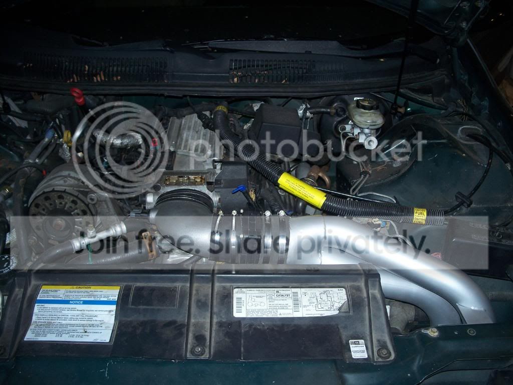

                      I got everything mocked up under the hood:

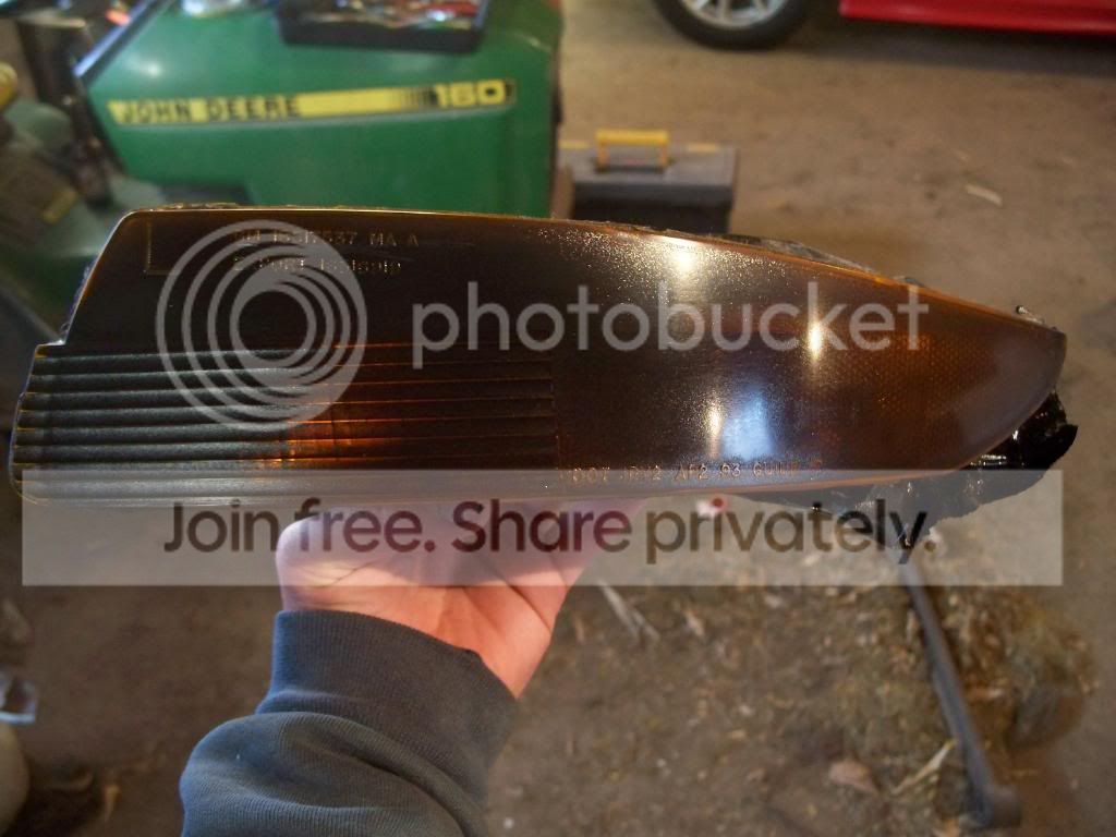

                      I also got to work tinting my turn signals.
                      At first:
                      then successive coats:
                      To show the contrast:
                      I've since applied two coats of clear coat. I'm not entirely pleased of how it looks so far. I feel like it should be smoother...

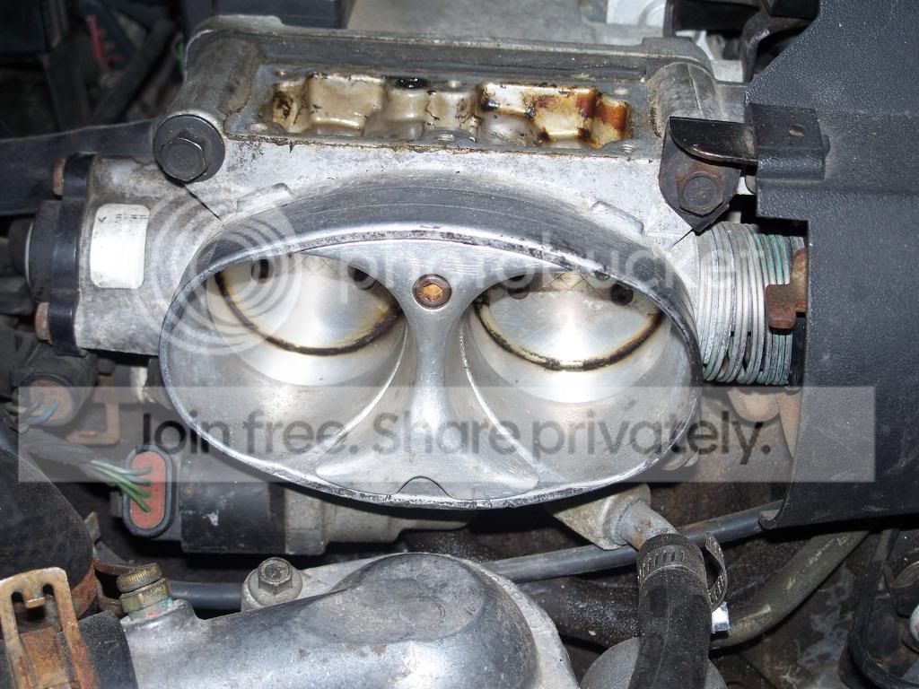

                        • other than all the stupid niteshade stuff, I got a little bit done today. I finally got that nut in the mail, so I could install the throttle body airfoil:
                          I also installed the new intake elbow and CAI:

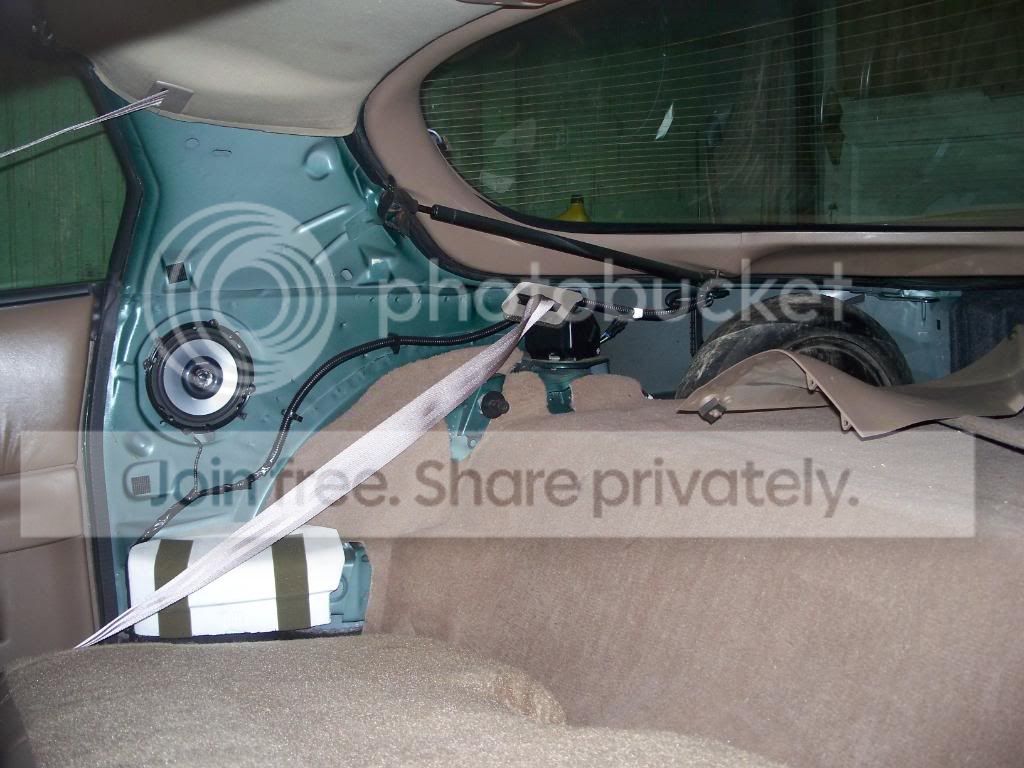

                          I also got the interior pretty much ripped apart enough to get at the top bolts for the rear shocks.
