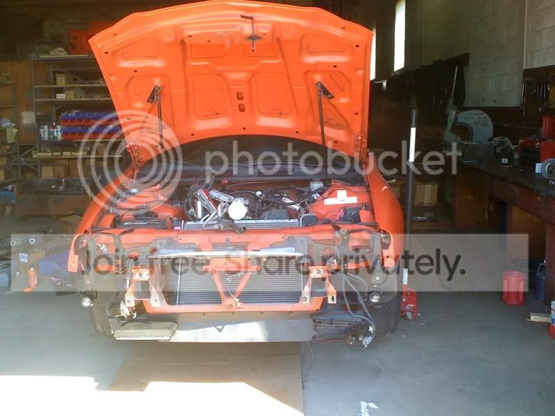

                        Quick question, what do you mean you had yours mounted dope style? I'm throwing the chrs1313 on next weekend when I get home and im scratching where to throw this cooler.
                        All "Dope style" means is the cooler is mounted horizontally.
                        You can actually see where my cooler is bolted directly to my air dam in this picture.
