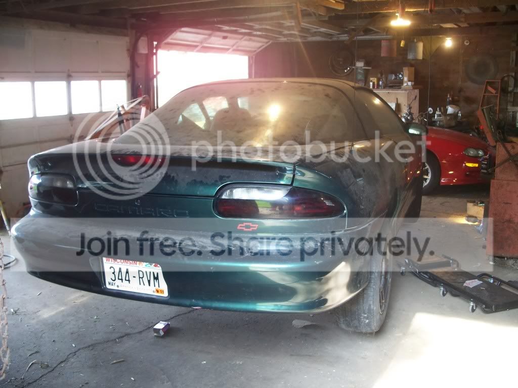

                Pics, by popular demand:
                First time it's been off the jackstands in a couple months:
                Moving it out of the garage:
                Now...the problems. Big ones. First, whenever I shift out of park, the thing backfires like crazy only out of the driver's side header. Also, we seem to have a vacuum leak somewhere, because when I turn the car off, there's an audible hissing that continues for five seconds or so until it dies down. I took the car for a drive for about a mile on the road. I couldn't get over 20 mph (just a guess, because my speedometer doesn't work). Revs would increase, but the thing wouldn't accelerate. I have no power steering. The car doesn't move in reverse. It still rolls when the car is in park. I can't even get the shifter all the way to 1. Other than that, everything's great.
