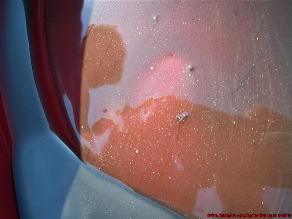

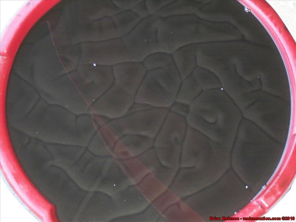

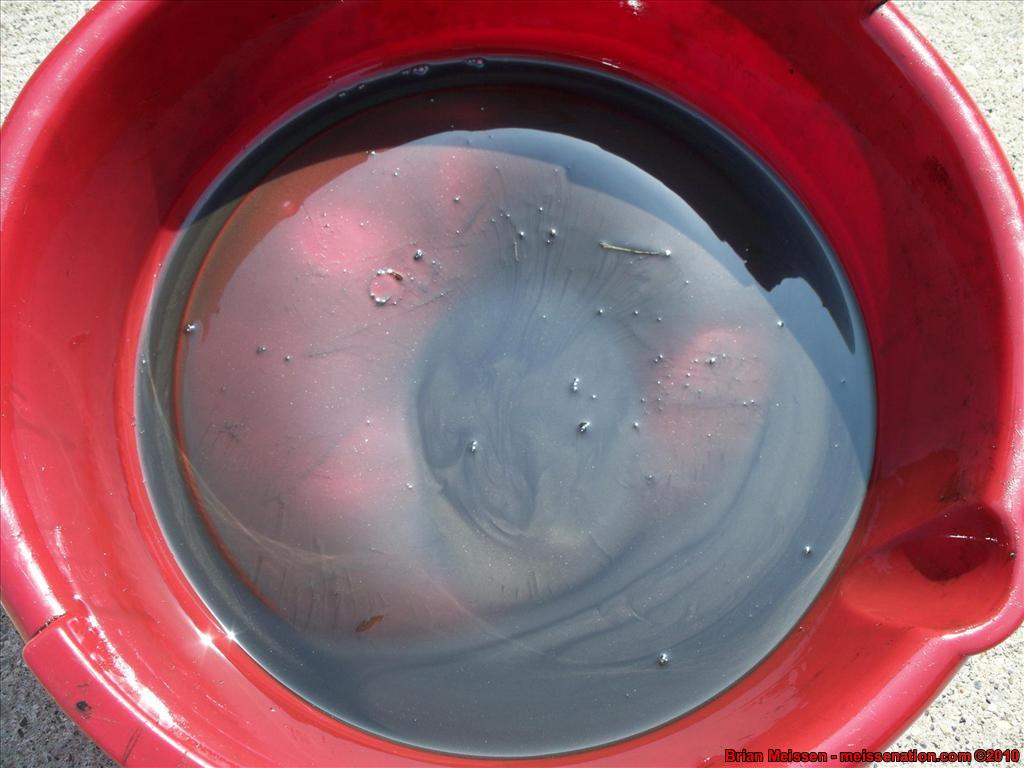

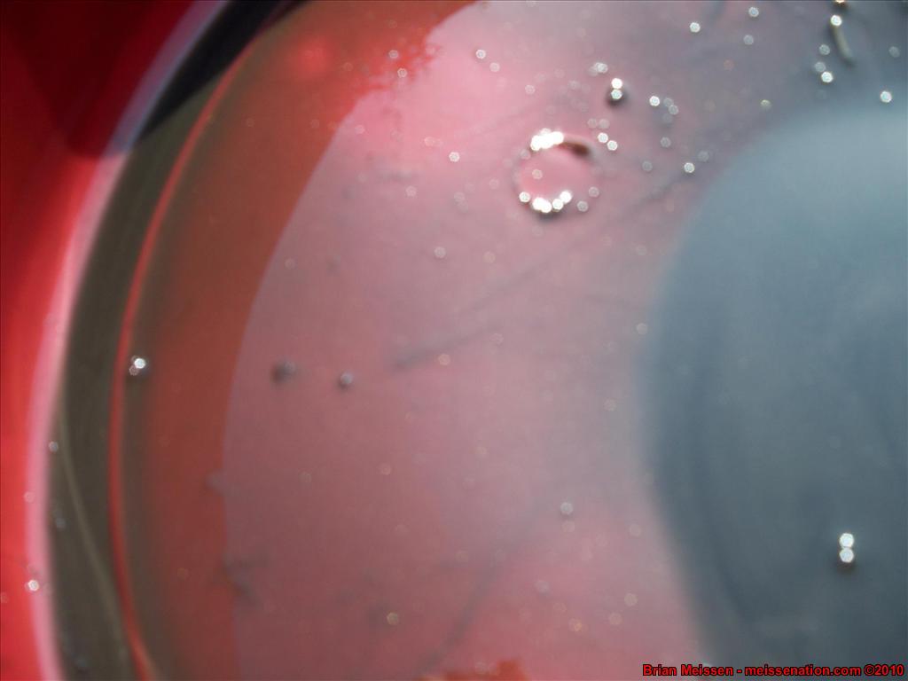

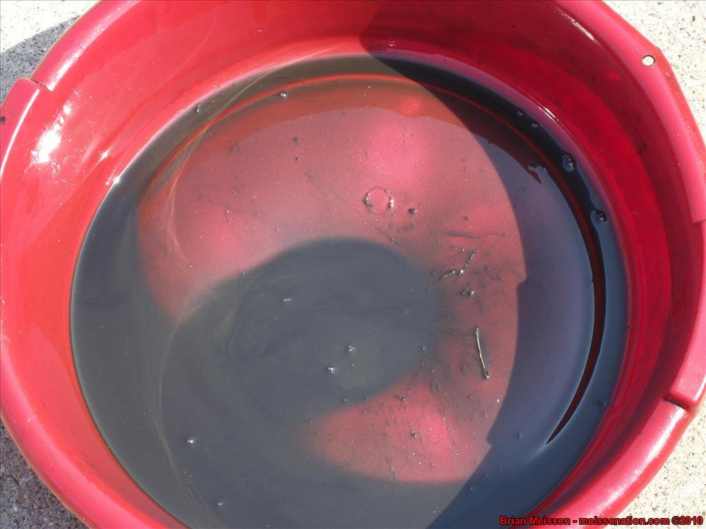

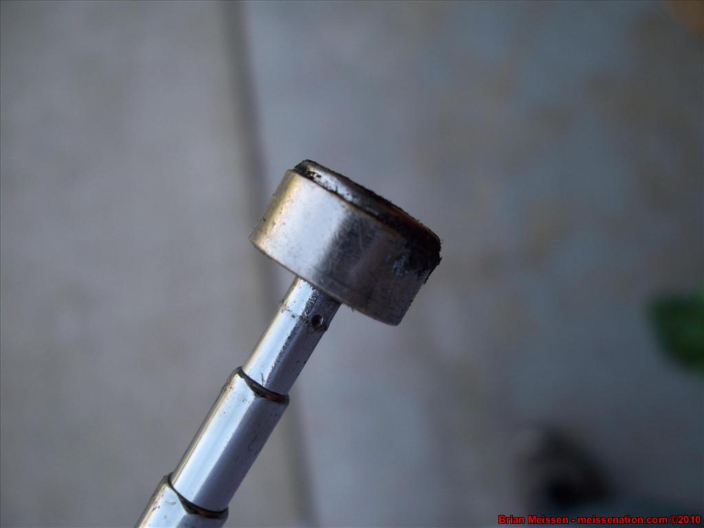

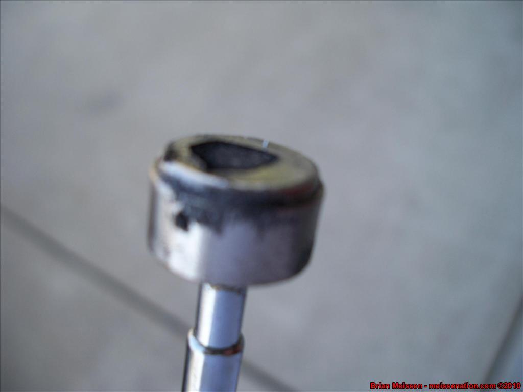

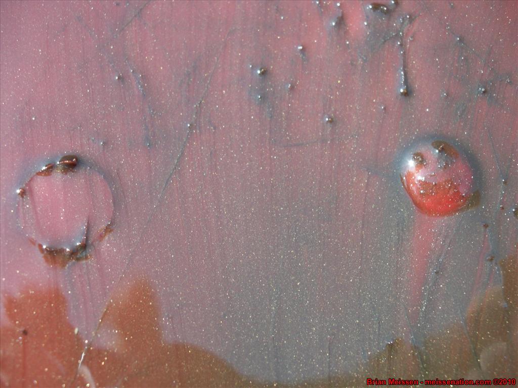

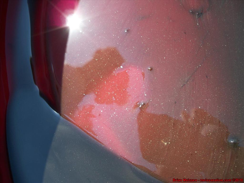

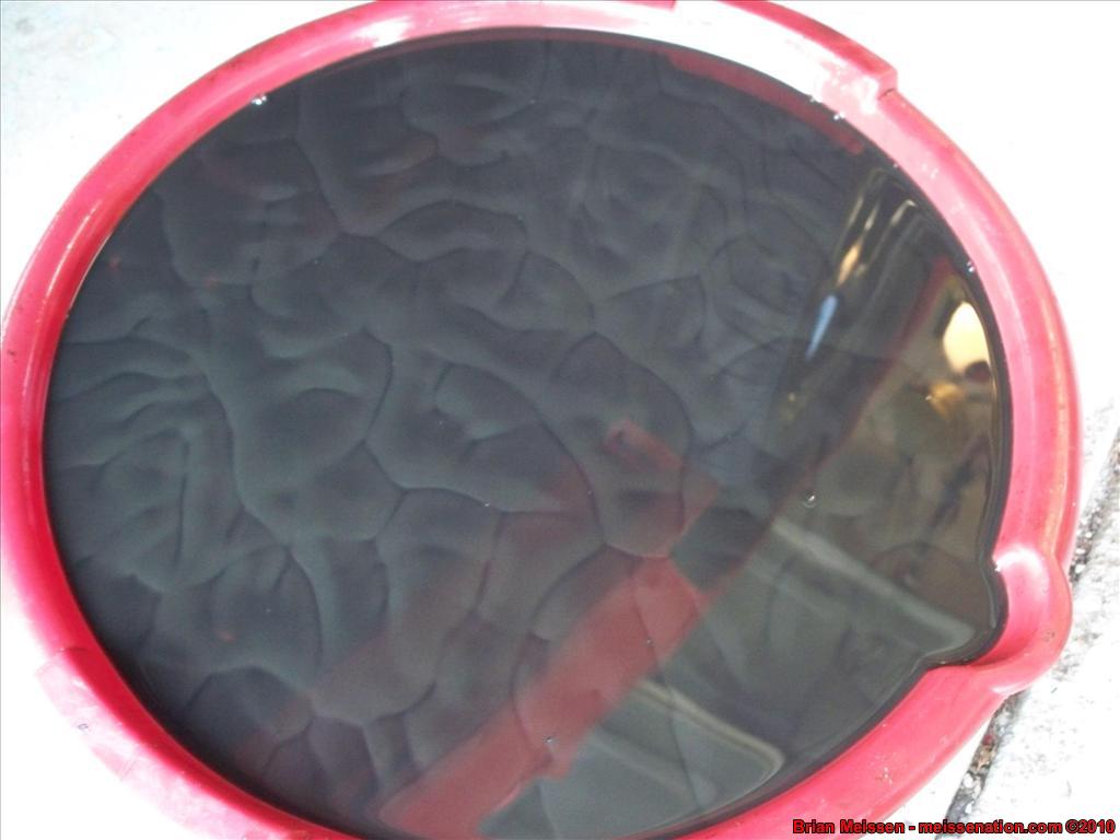

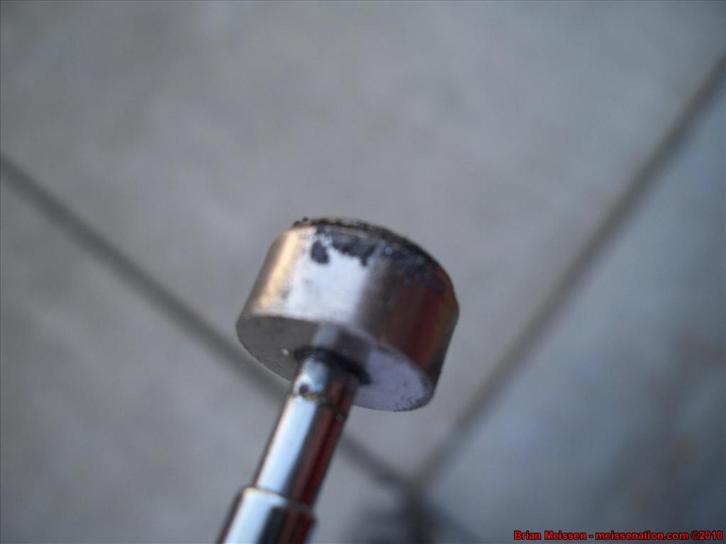

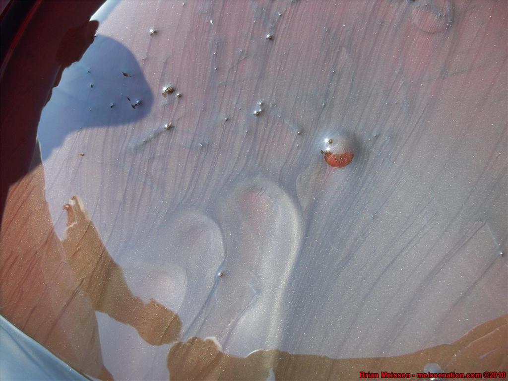

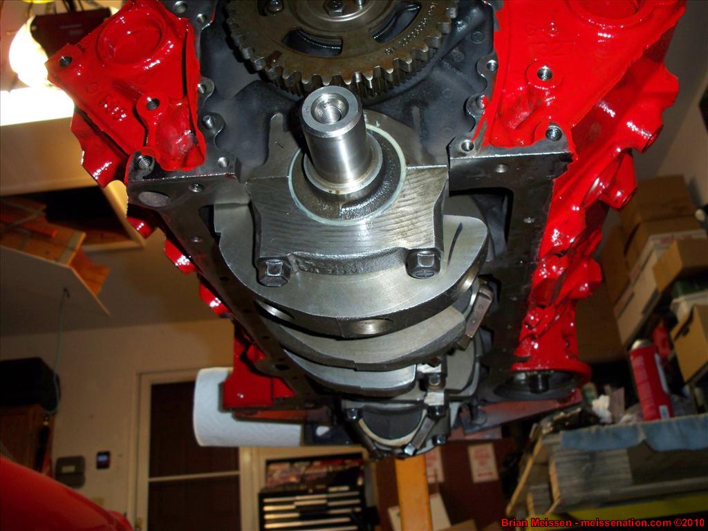

    Drained the oil, gold metal flakes all over. Bearings are bad and there's some silver particles in the oil filter ("maybe from the cam break-in?" is what Joel thought). Anyway, I'll let the pictures do the talking...

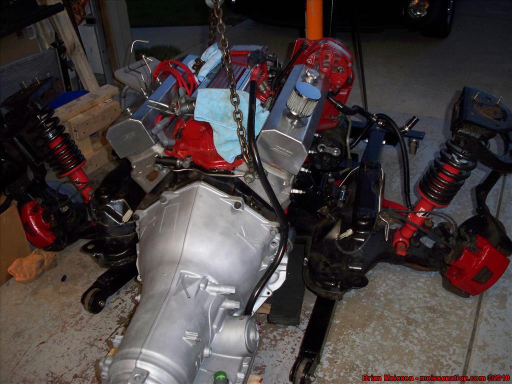

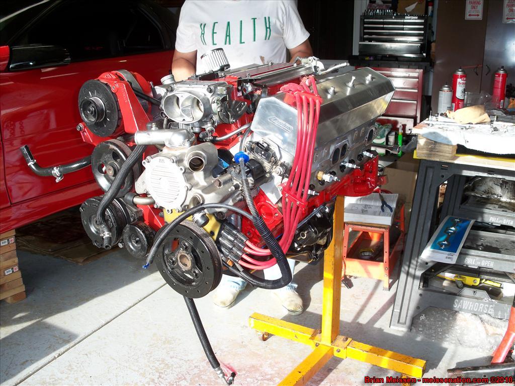

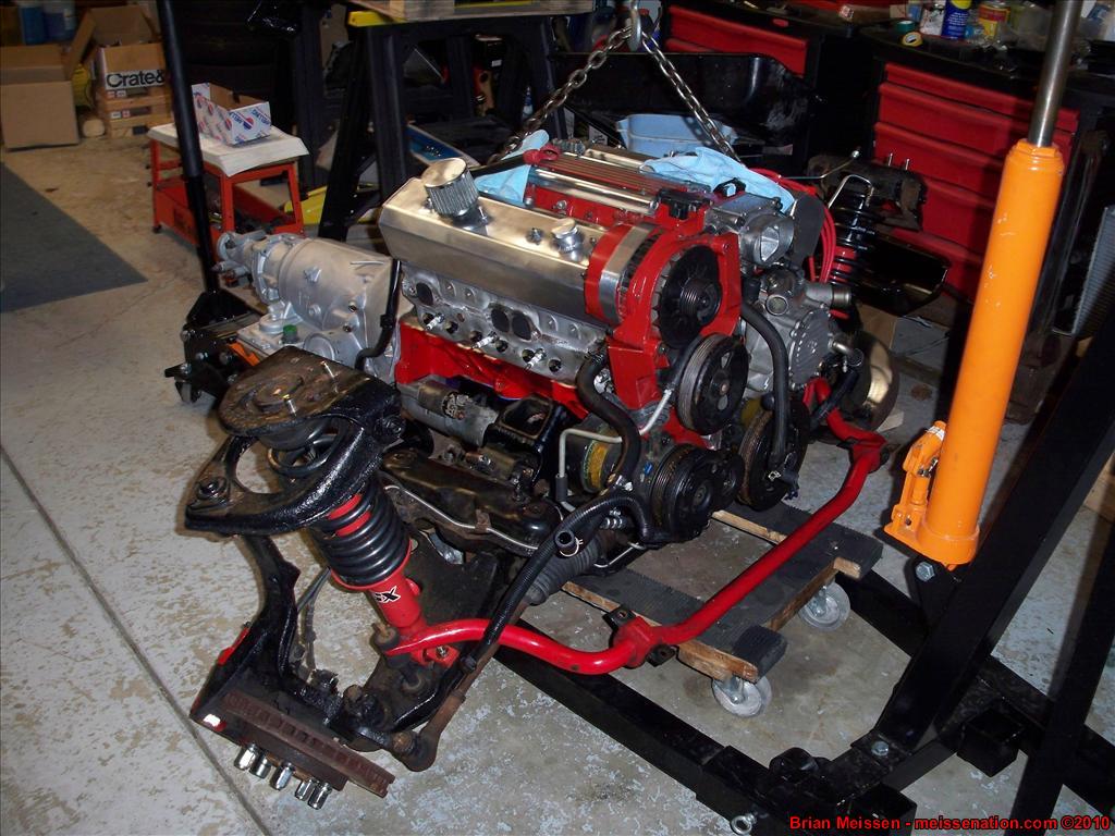

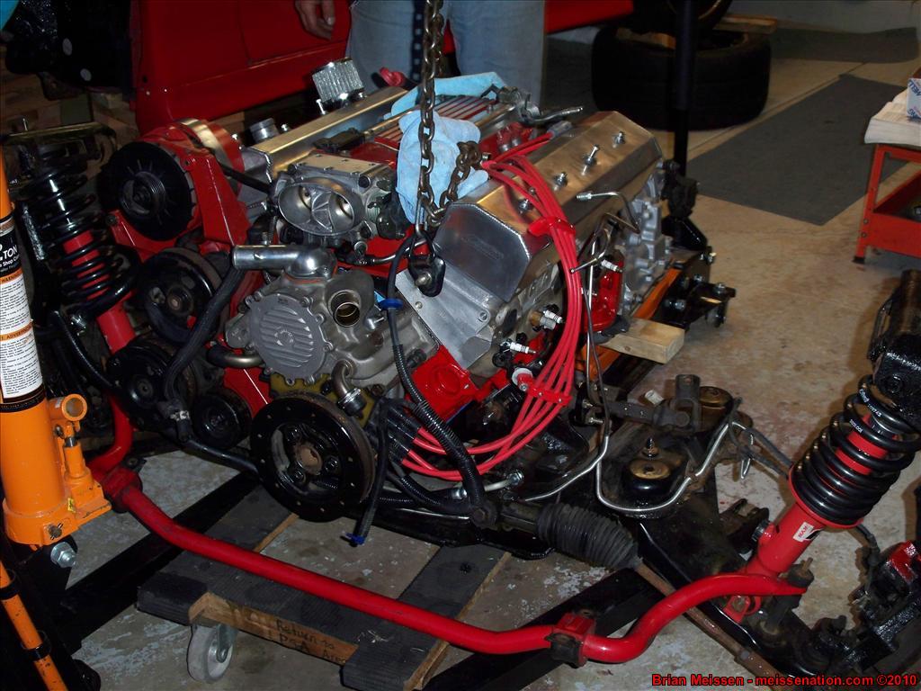

    I want to definitely send a big THANK YOU to Craig and Jon - they were a HUGE help with helping my dad and I haul ass on getting the LT1 back together. We received the LT1 on Wednesday the 13th, Thursday we went to the Red Wings game, Friday, Saturday, and Sunday we hauled ass and had the LT1 installed and tried starting it on Sunday night. It wouldn't start, was back firing through the intake.
    And that's where the problems started - Although everyone will say it's impossible to do it, I was able to successfully install the Optispark with the dowel in the wrong slot. I indexed it wrong, apparently, and I hardly used any force to push the Optispark into place... it just slipped right in. So, Monday the 18th we tore the front of the engine down to get to the opti. What really helped was I took the cover of the optispark off so I could see where the rotor was. Then I was able to hold the rotor in the correct position so the dowel would go into the CORRECT slot. We started it Monday night but it was backfiring still and it was too late to keep trying to fire it up and get it running right.
    Tuesday the 19th we figured it out that we had two of the spark wires (3 and 5) reversed, so we swapped those and that fixed the problem - the car was running alright but we could also hear a banging noise.
    Wednesday Craig came over and we were able to figure out that it the banging noise was coming from the dustpan so we thought that the flexplate was cracked.
    Thursday I had class.
    Friday we didn't do much of anything with it... I can't really remember why but whatever reason we just took the night off.
    Saturday we found out it wasn't that the flexplate was cracked it was the weight on the engine side of the flexplate was sticking out too far and there wasn't enough clearance to the starter so it was whacking against the starter as it spun. We took the starter out, took a grinder to it, and reinstalled the starter. We gave it just enough clearance for the flexplate's weight and TADA it was running great! Did a LOT of data logging along the way to make sure it was running OK and everything was good.
    Lowered it down onto all four tires and then took the videos above.
    Talked to Steve yesterday and he said it was safe to drive out there so we did. Hopefully should get it back tomorrow night.
    Also, I need to give a big THANK YOU to Kyle and Joel for giving me tons of advice along the way. When I ran into all the problems Dr LT1 earned his name and helped me out a shit ton.
    So, big thanks to my dad, Angie, Craig, Jon, Dan, Kyle, and Joel for all their help. Another big thanks to Ryan [ThreeHonks], Jeff [DetroitMuscle], Kyle [MP81], and Liz [..y'all know who she is..], for keeping the secret. Ryan found my "help!" thread on LTxTech.com and Jeff caught my dad buying o2 sensors and spark plugs at O'Reillys and put two and two together.

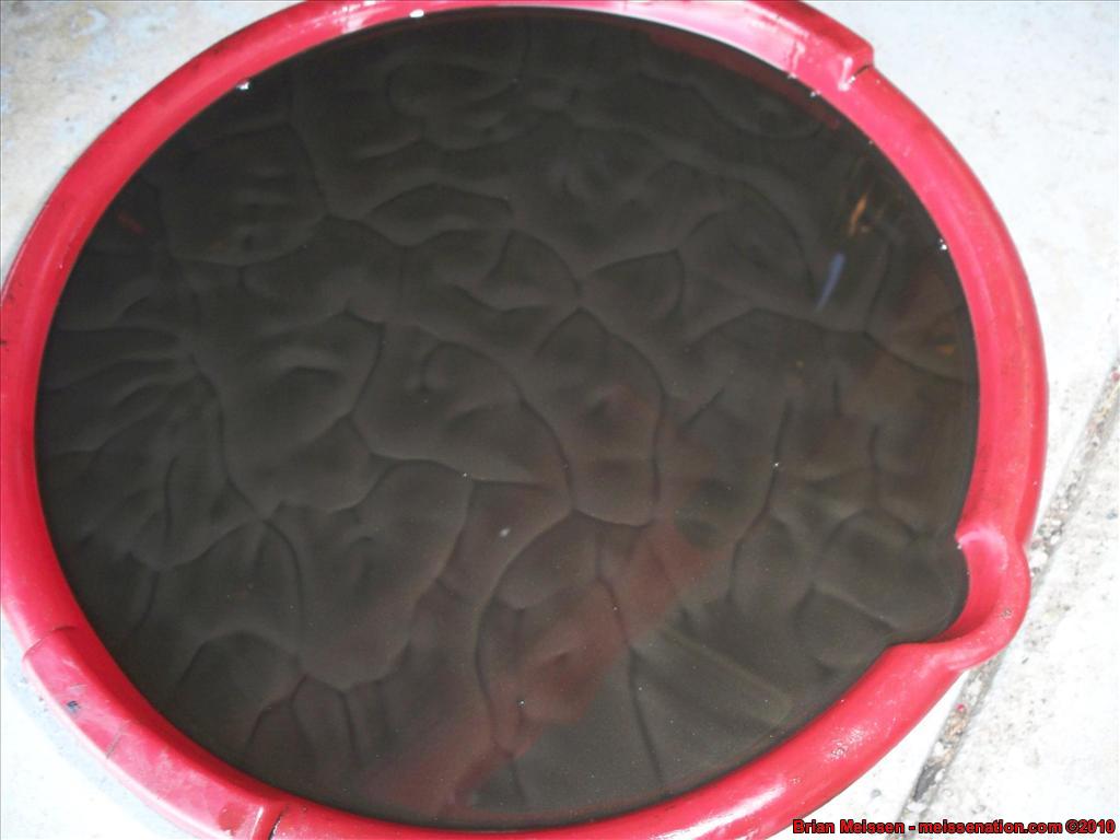

            The "veins" that you can see in the pictures of the oil in the pan leads us to believe there was gas in the oil caused from my impatience of starting the car and running it with the 30# injectors before giving Steve adequate time to get out there and flash the PCM. Gas got past the rings, into the oil, messed with the lubrication and caused unnatural wear on the bearings. While we can not explain the oil pressure issue 100%, we think that's a second issue that compounded our problems but the main issue is those bearings.
            That said, while I backed the car into the garage, there was no knock, no unnatural noises, no whining, squeaking, etc. When I first started it, there was a little clatter noise but the last time it was ran before it was shut off the oil pressure was in the red - probably should've primed the oil before actually firing it up today to move the car. When we got the car in the garage, we opened the hood and my dad opened the throttle a little bit (not a high rev, just enough to bring the rpm's up to 2 grand at the very most). We didn't hear any knocks or anything.
            So, at this point, without checking the bearings, our thoughts are that we wore/scored the bearings to the point that we took a part that had 60,000 miles of wear and tear on it and now it's at the equivalent of 200,000 miles.
            And here's the idea my dad had: Put fresh oil back into the engine, let it run and warm up, then drain the oil again. Now.. we know there's going to be the gold dust in there because we can't really "flush" the oil all out and put fresh oil in with no more dust. But, if there's not as much dust, no knocks, and no oil pressure issues, we might be able to limp the car around and play it by ear at least until the Meet & Greet. After the Meet & Greet, depending on how it's driving, then we can tear it down and replace the bearings then.
            We called Craig to put him up to date and on his own he said "At this point, I think what you need to do is put fresh oil in it, let it run, drain it out, check for the dust and then go from there."

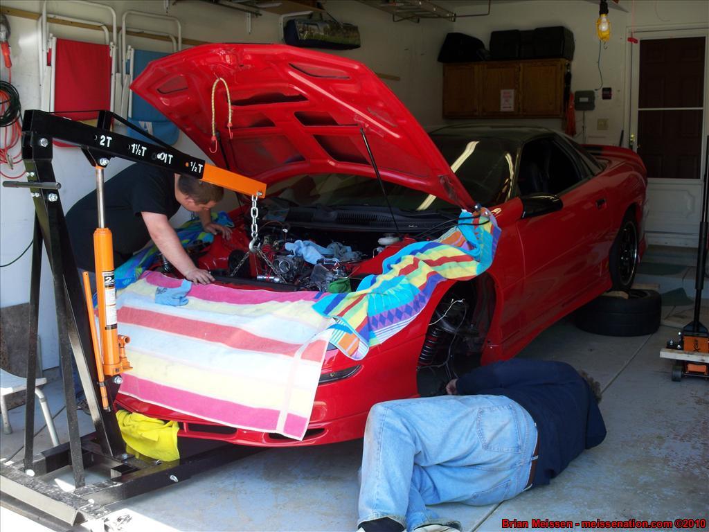

            Depending on how much dust we see when we drain the oil the 2nd time, at that point we can try lifting the engine up off the motor mounts with the cherry picker, drop the oil pan, check a couple bearings to see how bad they're worn, and check the oil pickup tube too.

                      Oh man, this is bad news. Changing the oil won't do squat...your bearings are toast. Pull the motor out and tear it down....figure out what went wrong. Running the car more will only hurt the engine more, fresh oil or not.

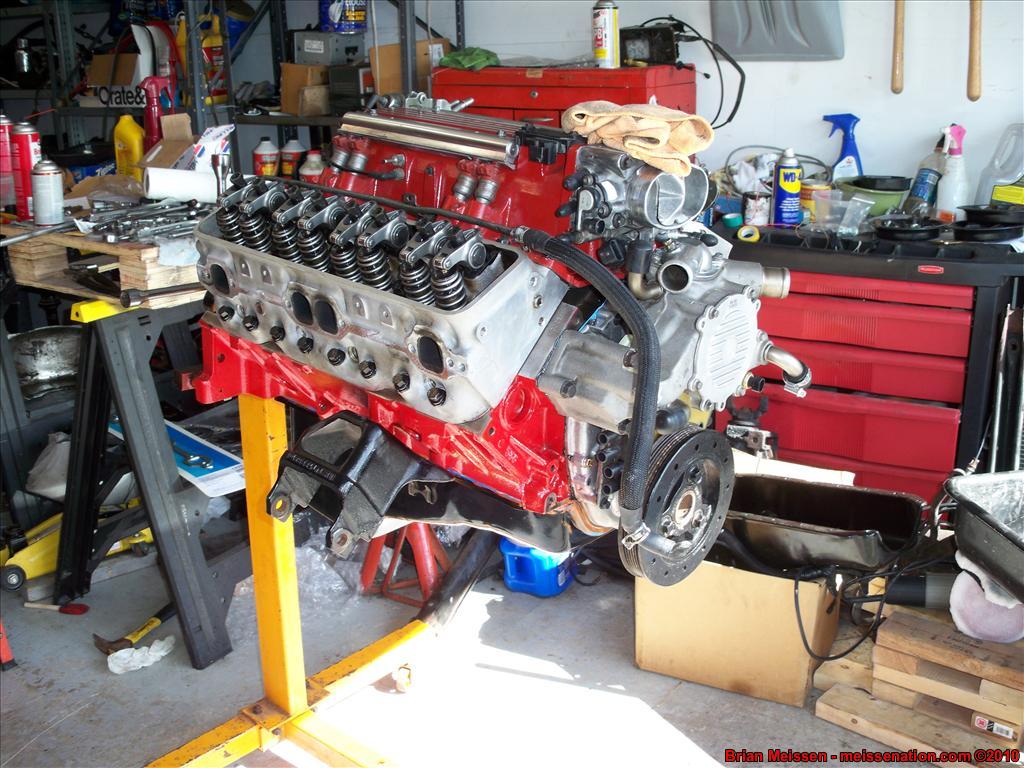

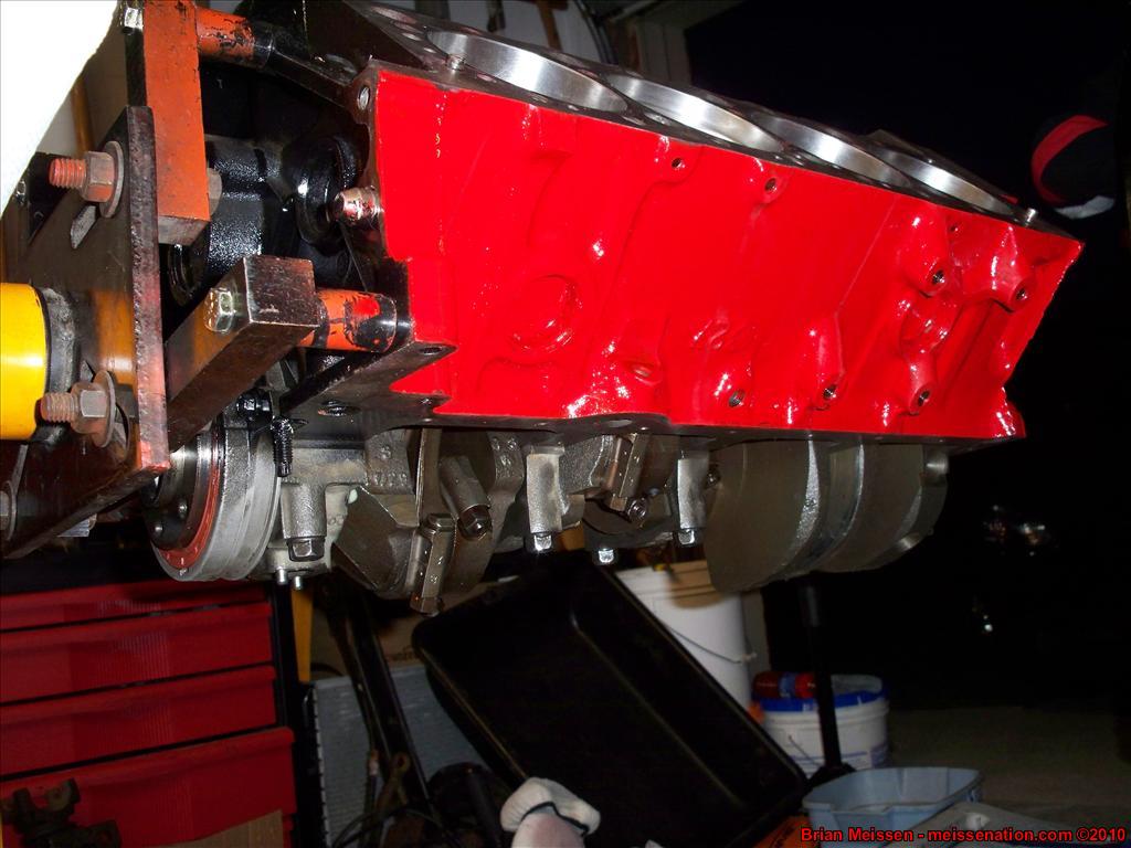

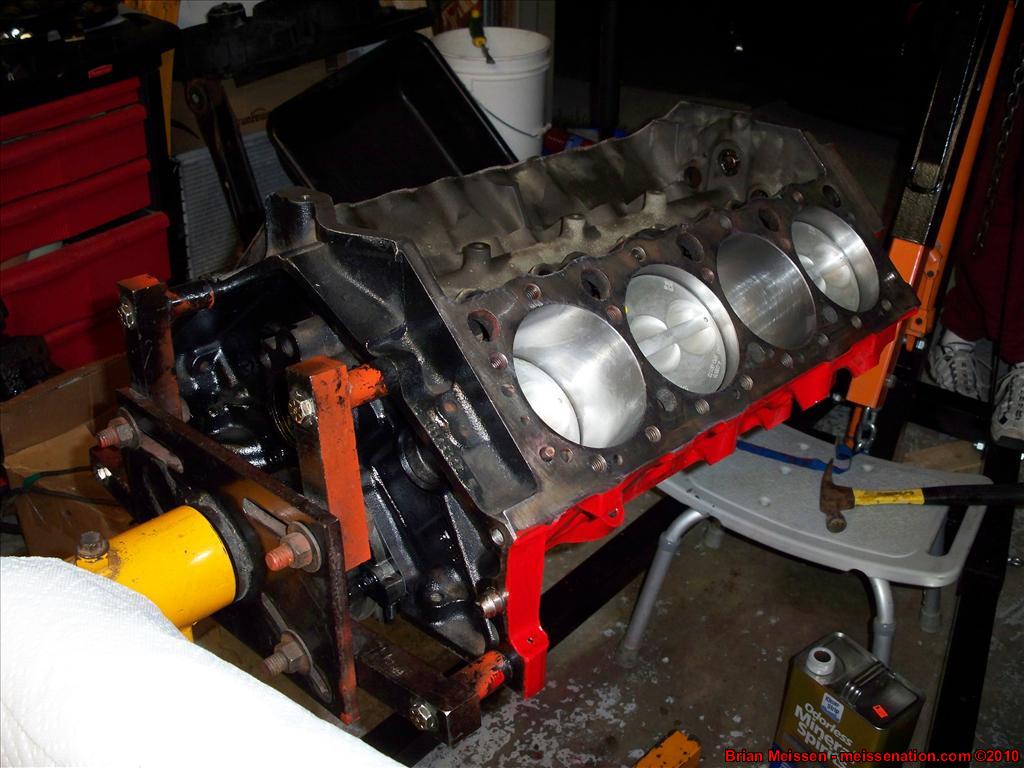

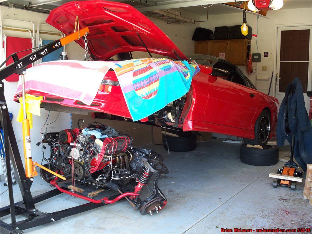

                              Well, tomorrow we're going to drop the engine out the bottom again.
                              We haven't 100% decided "how far" we are going to go.
                              Part of me wants to just yank the crank out, take the crank to get machined if it's scored at all, replace the bearings to match the crank, and then put her back together with a new oil pump and tacked pickup tube just for insurance... after this there's no way I don't want to have that insurance.
                              Another part of me thinks shit while I'm there I should replace the piston rings... if I'm doing that, I might as well replace the pistons.
                              Another part of me (and hearing Sean's opinion on it) is to take it all the way down to the bare block and take it to be machined and spec'd out to make sure the block is good... like Sean said, it'd suck if there's something with the specs of the block that isn't right and we redo the bearings and have more issues.
