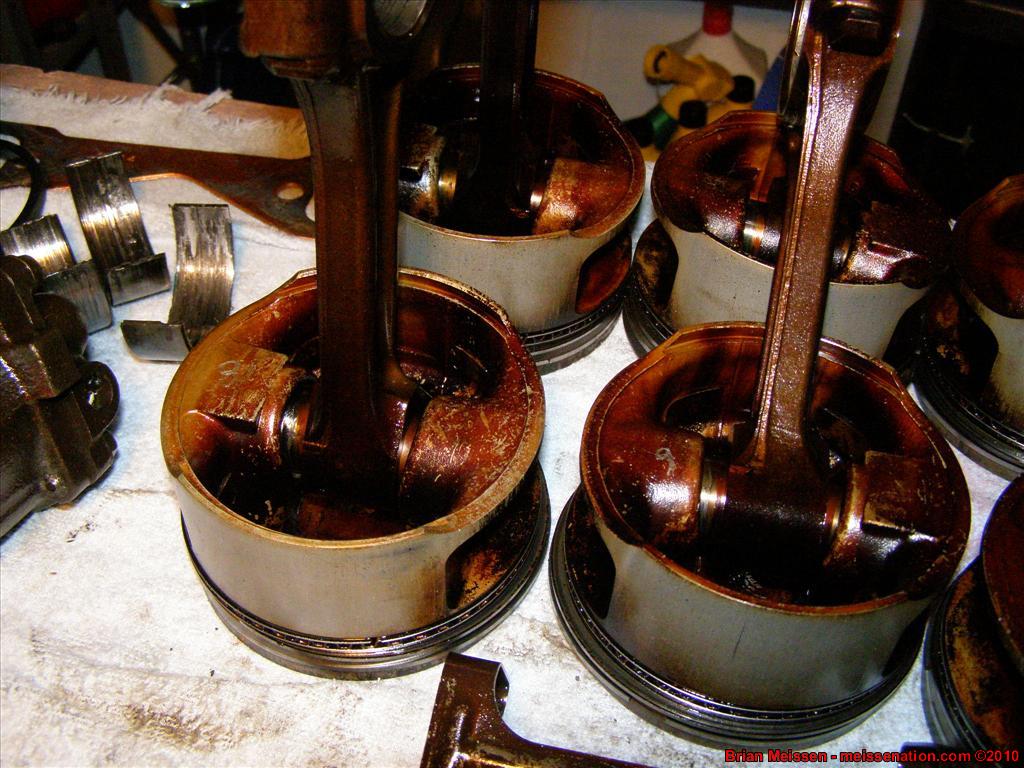

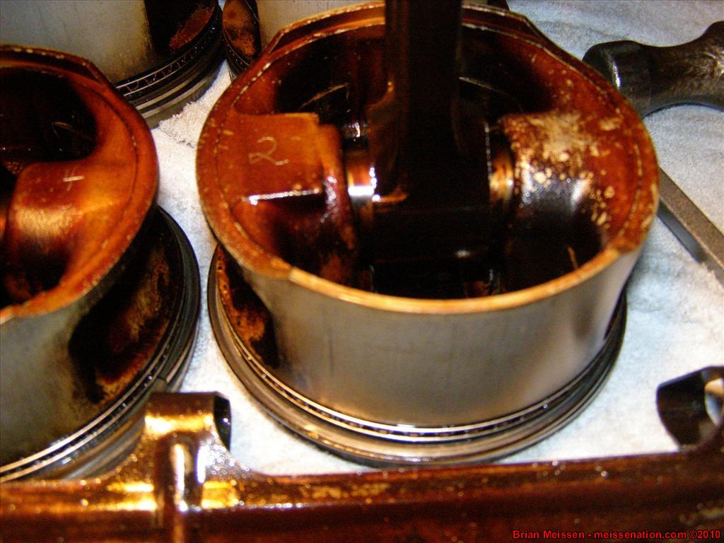

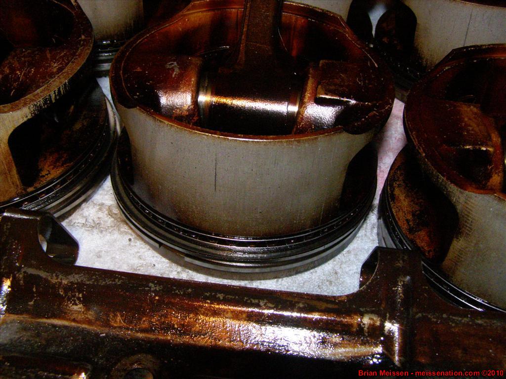

    I've got a thread on CamaroZ28 and they said if the fuel was washing past the rings that the cylinder walls would be really effed up worse than the pictures look. That leaves me completely stumped - there was definitely fuel in the oil.. you could smell the fuel in the oil, in the heads, etc. The question is - what are the possibilities for fuel getting into the oil? I thought the only way was piston rings..

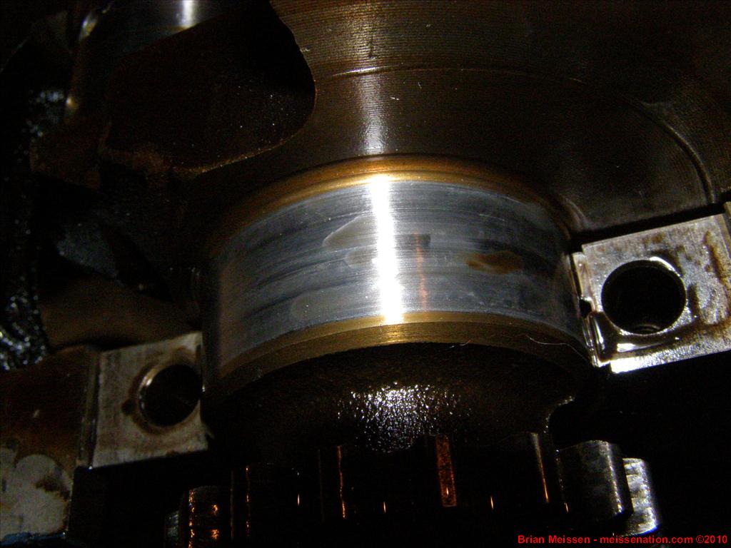

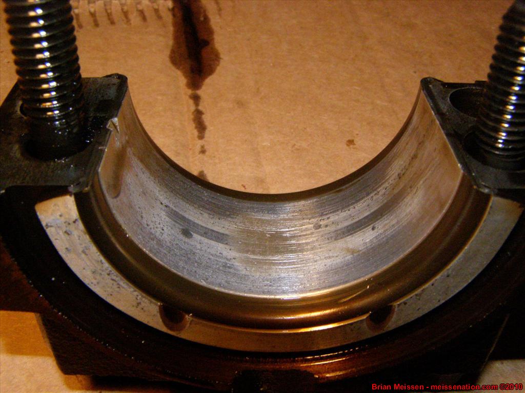

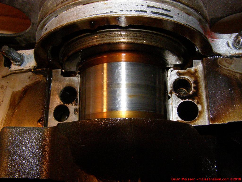

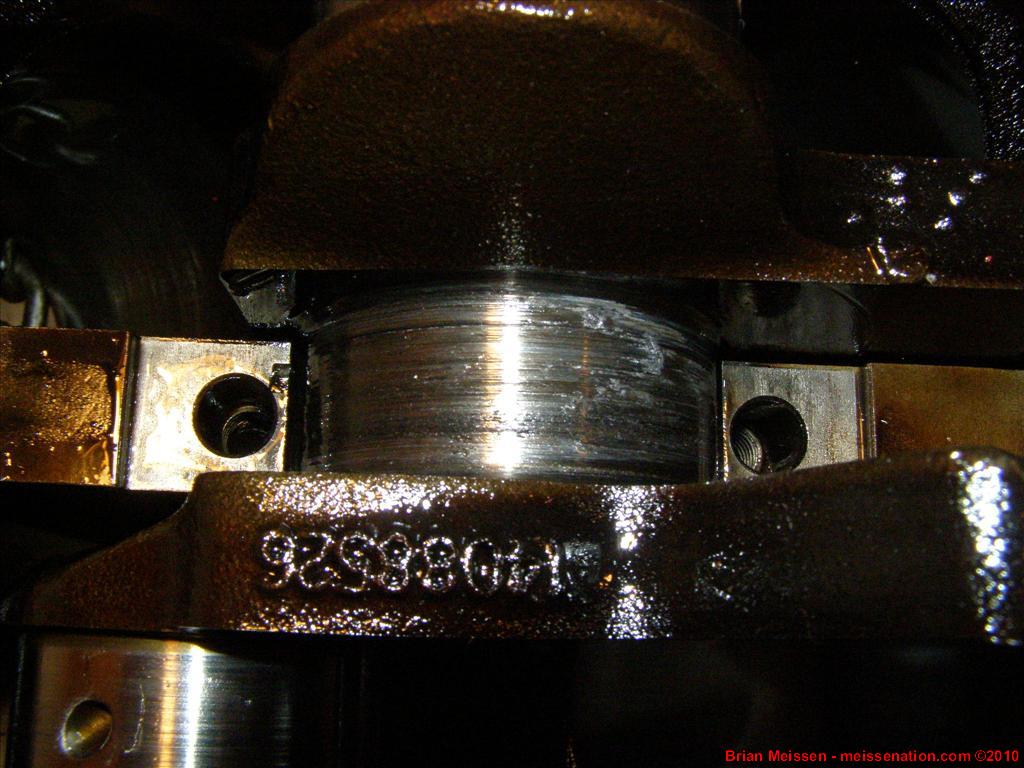

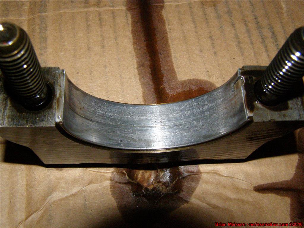

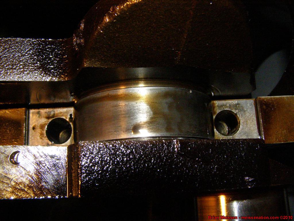

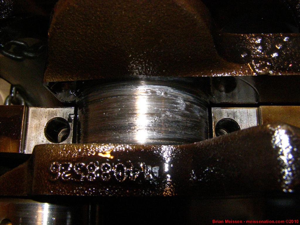

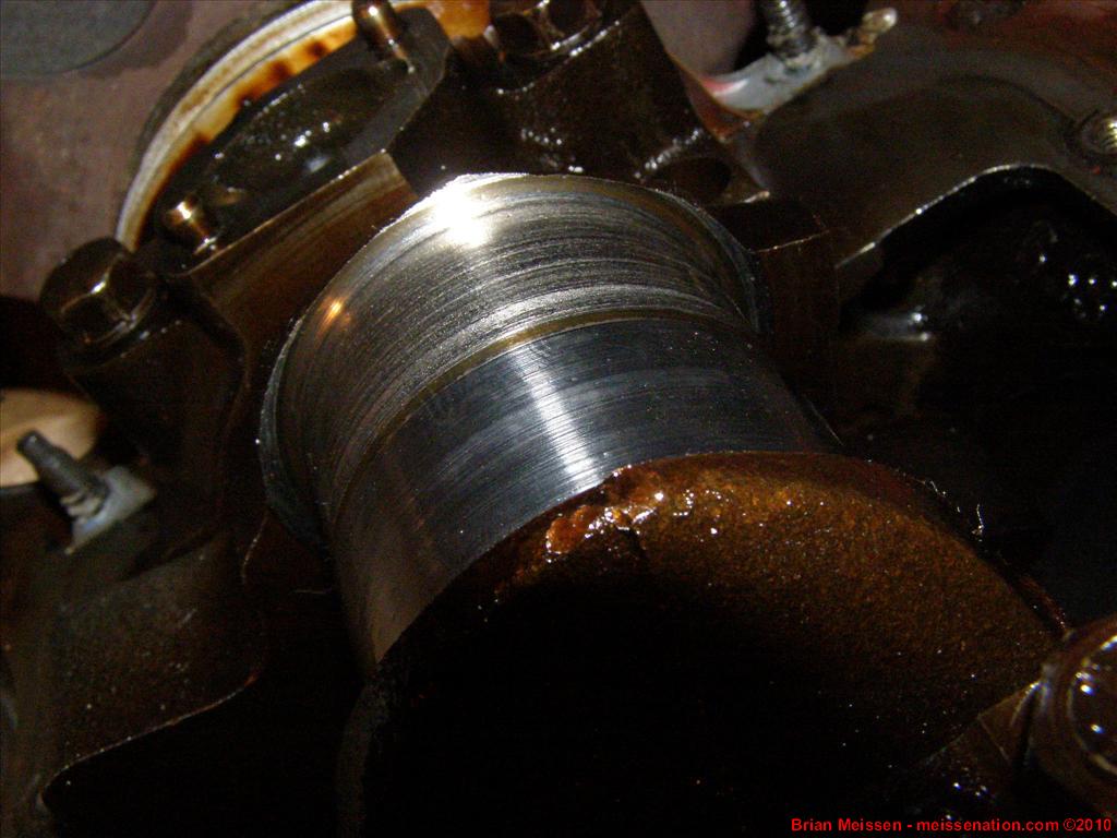

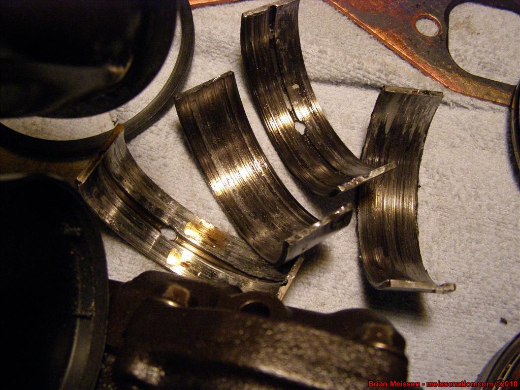

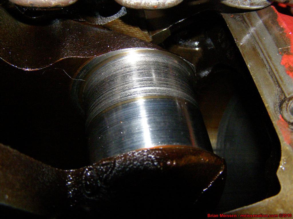

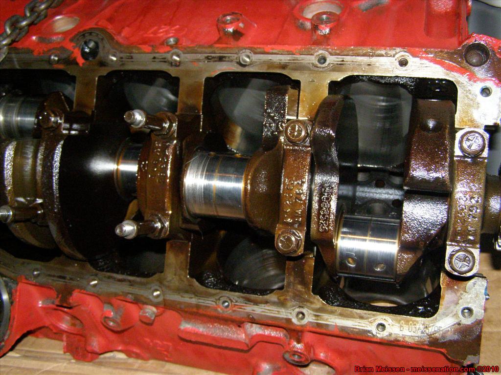

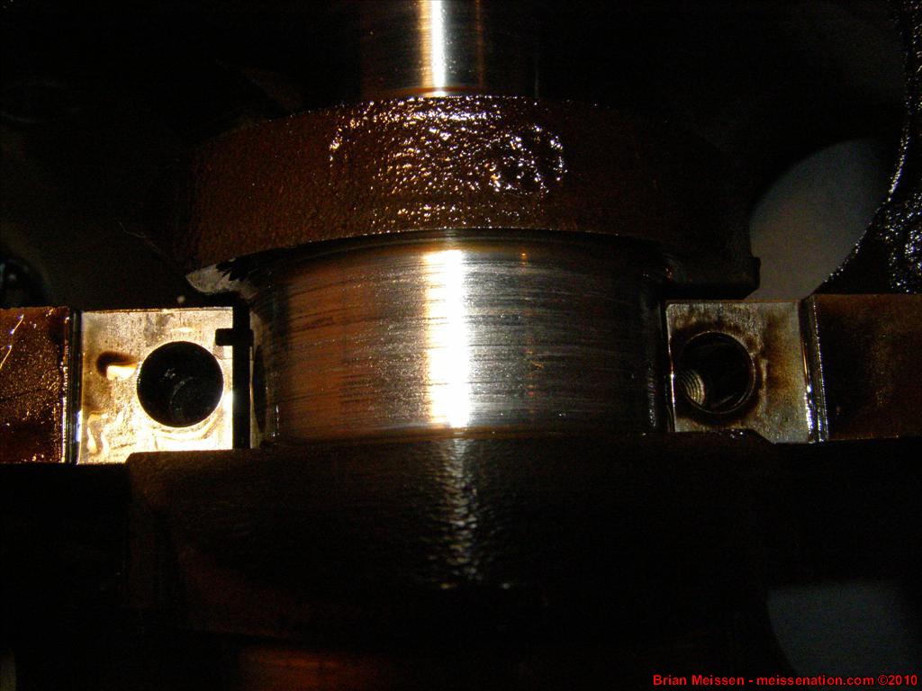

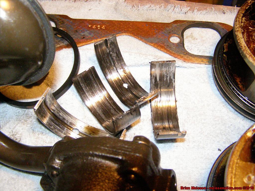

          Main bearing # 5 had wear and scouring not turned. the worst wear and damage was Rod journal #8 bearing turned and rod journal worn down .020 -.025. Odd part is same Journal, is rod #7 didn't turn and hardly any wear. Understand I'm being visual, not using a micometer.
          Main bearing 2,3 turned worn, rod bearing 4 turned. the other rod bearing and journals look great.
          All the piston, wrist pins and rings look fine. Cylinder wall appear fine.
          From your experience would you think problem stated at rod bearing 8 and the rest was a result of that damage escalating. the worst main was #2 then 3, the crank journal for #2 was really scoured. none of the other journals were scratched or scoured.
          So, let me know what you think.

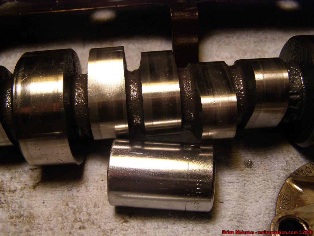

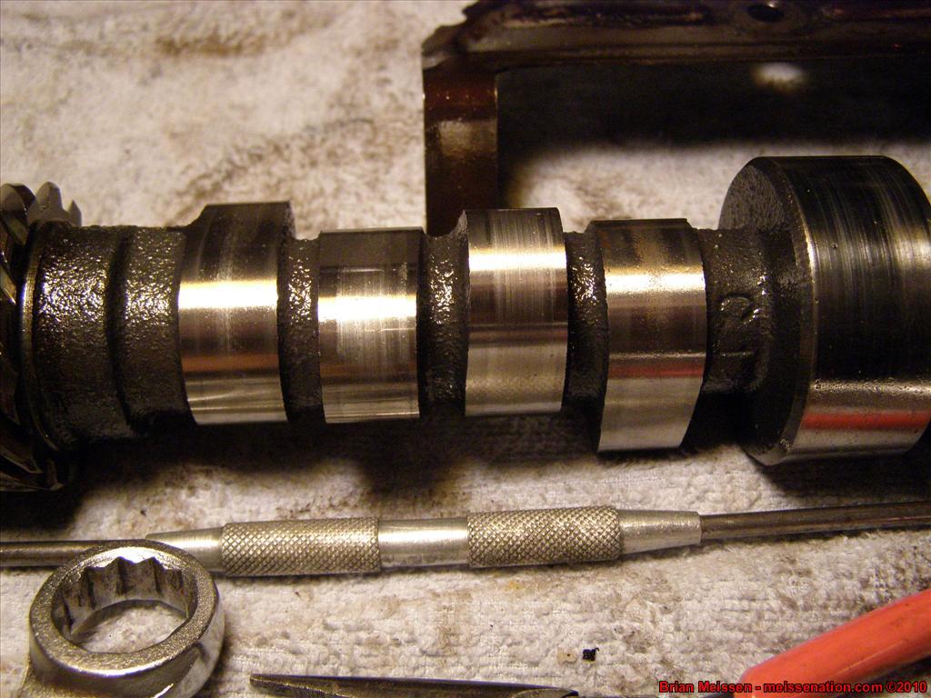

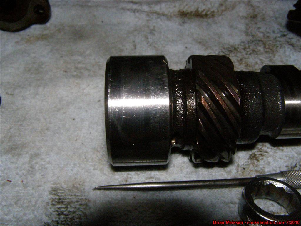

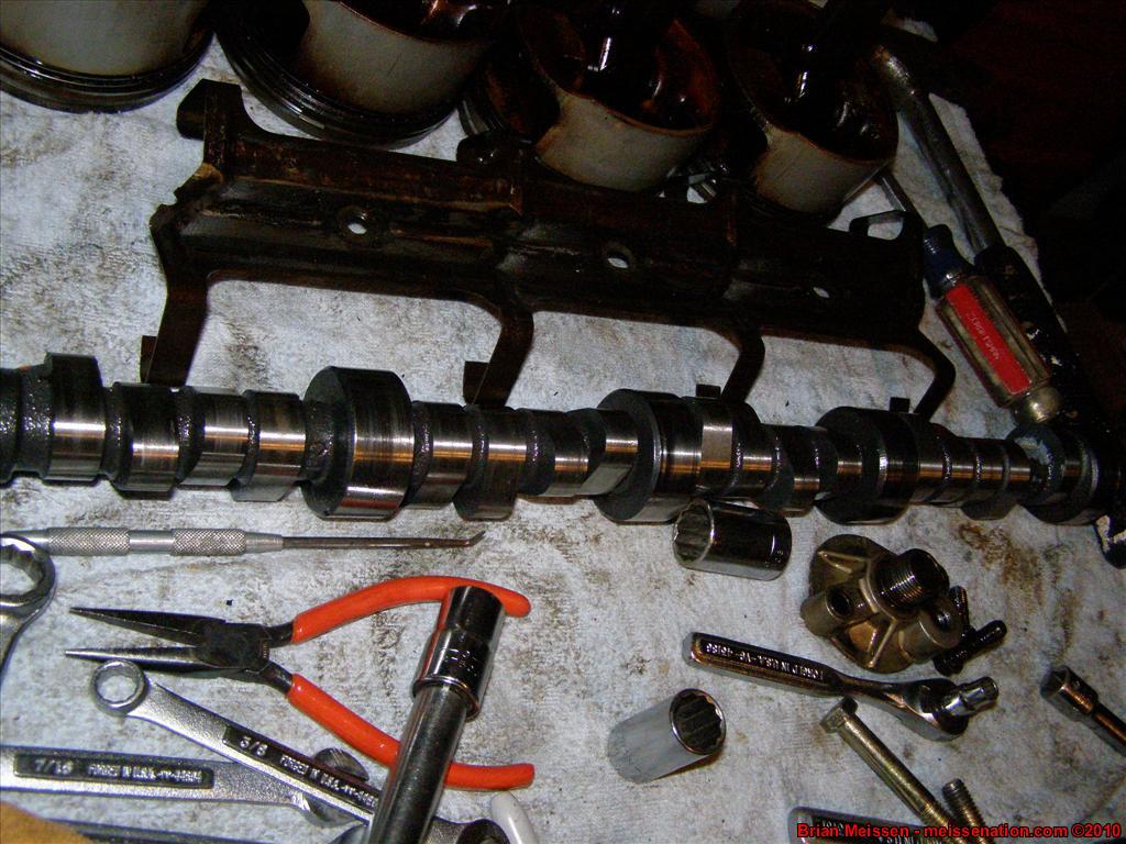

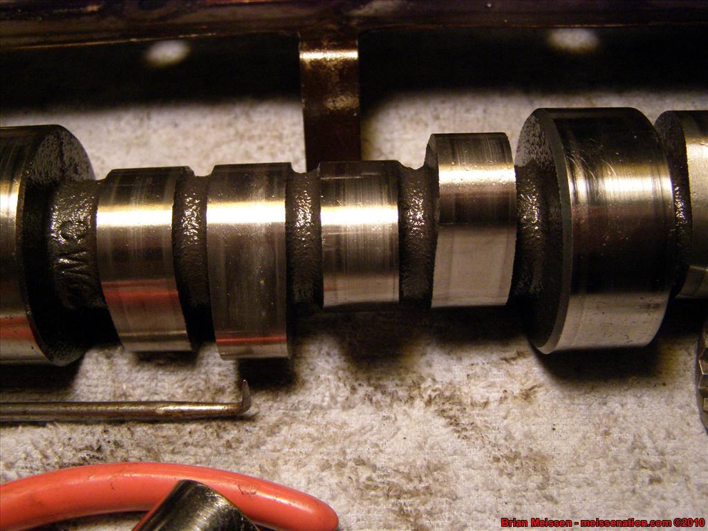

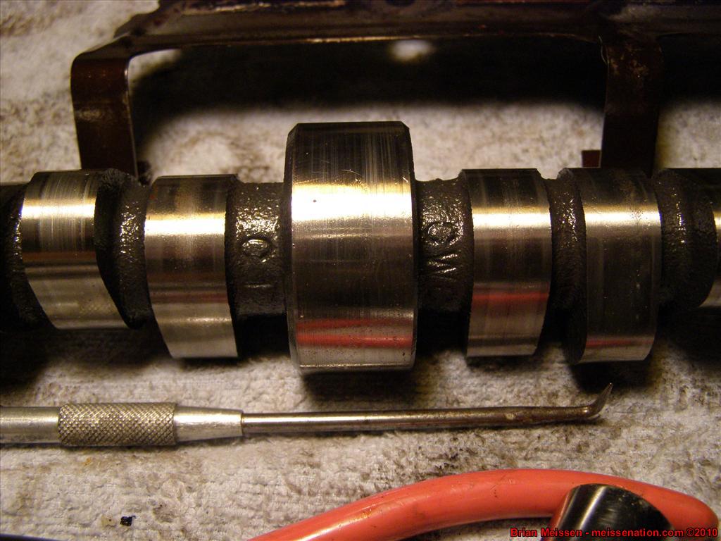

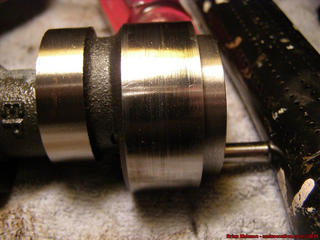

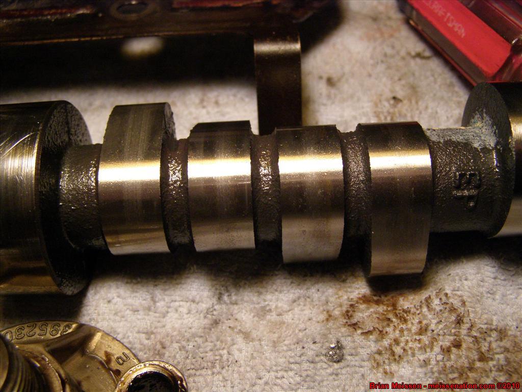

            • BTW - before anyone says anything about the cam - I ran my fingernail over each surface and you can't feel any scoring - it's perfectly smooth all the way across.
              • nice work! and wow your sig and avatar are very distracting!
                  Brian, at the risk of sounding harsh, do you really want to trust your engine to how it feels with your finger nail? I sounds like you are desperately trying to convince yourself that you don't want to believe what your eyes are seeing.
                  The lines and marks you see on the cam lobes and bearing journals are from those metal particles that were in your oil being crushed under the lifter rollers and getting squished in the cam bearings. What you see is the beginnings of a breakdown of the surfaces. This will not heal itself, it can only get worse.
                  If I found that kind of wear indication in a part of a machine I was fixing at work, I would definitely replace it. I know that's not what you want to hear. But, in the end, it's your engine and you will have to make the final call.
                  Larry,
                  It looks to me like the problems started with a lubrication issue. But, it's really hard to tell. Once one bearing surface started to go, the metal contamination started and it progressed from there.

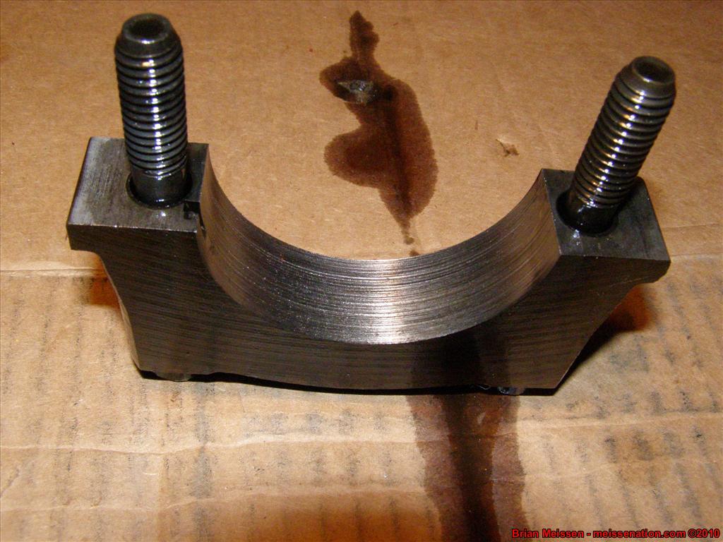

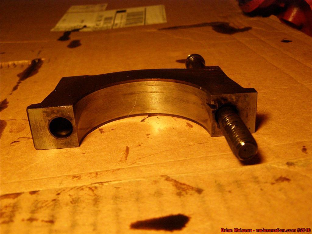

                  I would be concerned about that bearing cap in pic #20. The new bearing insert needs to fit properly.
                  Once the crank gets ground and the new bearings go in, then it's all about cleanliness during assembly and making sure the oil galleries and passages are clear and unrestricted. Make sure the oil passages in the crank journals are clean and clear, as well.
                  Don't forget to pre-lube the engine by spinning the oil pump before you try to start it. (I'm not exactly sure how you do that on an LT-1) It's pretty easy on an old style small block.

                    • I would replace that cam B!
                      Like Doug said, that cam isn't going to heal it's self.
                      A line hone is needed for sure on that block.
                      • We're taking the cam to the machine shop tomorrow to see. I'm just trying to convince you guys that haven't physically held the cam or seen it in person. Pictures don't do the cam justice - everyone that has seen the cam in person has said that the machine shop should be able to polish the cam to good as new and that it just looks like the pattern where the lifters are rolling against the cam.
