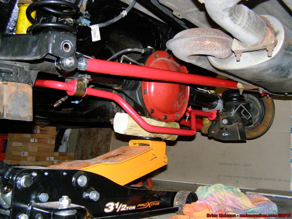

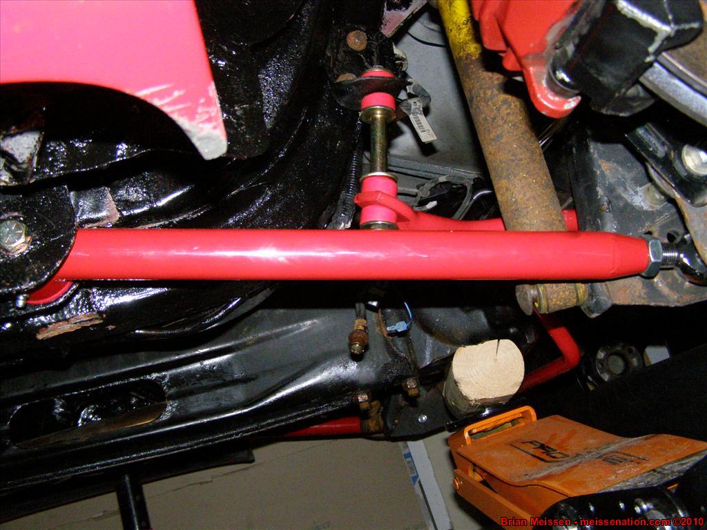

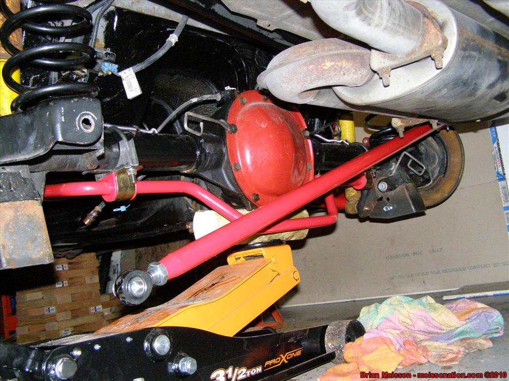

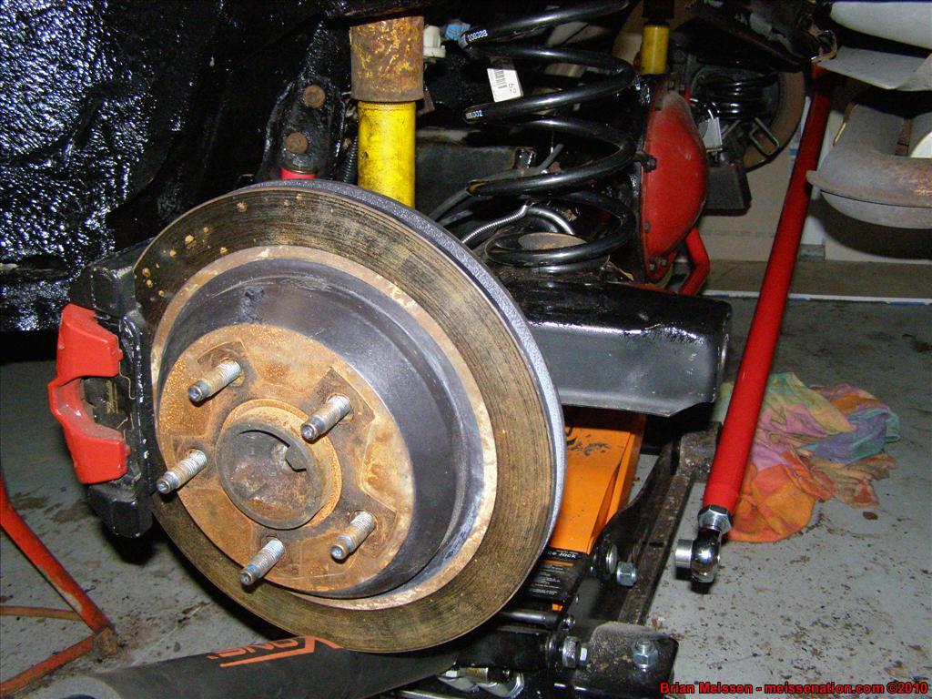

                      Got the rear end mostly in today!!! Still have more work to do, but we had to make a lot of runs to get the right bolts and stuff.

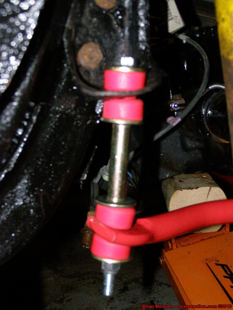

                      By the way - I would definitely NOT recommend using Energy Suspension's rear sway bar bushing kit. The bolt they give you is a good 1-2" too short. Kyle has comparison pics. I had to go to Murrays and buy a new rear sway bar bushing kit ($10) just so I could use the proper length bolt from that kit with the poly urethane bushings.
                      • Look'n good! Keeping the old shocks?

                          • Here's the comparison...
                            • isnt that intentional for a more effective sway bar?
                              • yeah thats what I thought.
