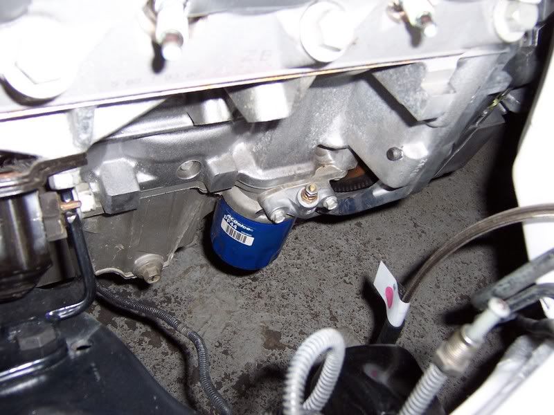

      Progress seems to be slowing down somewhat.
      Here you can see it better, it's on the bottom side of the block passage on the driver side...Here you can see the pump back on the motor showing the new steam vent location

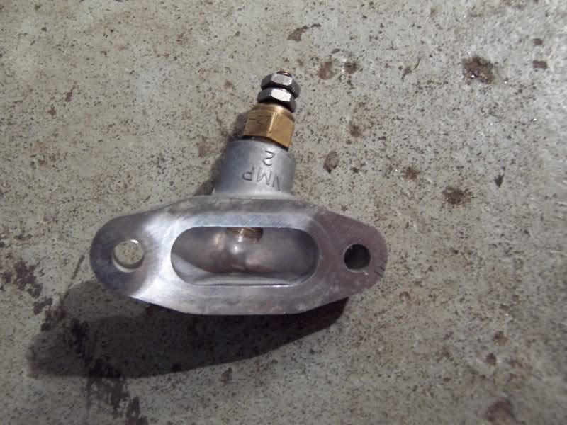

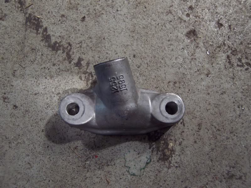

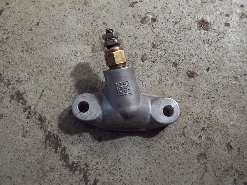

        Here are some pictures of the oil pressure bypass cover that I modified to use with oil temp sender. This was a piece of cake to do...anyone who is thinking about adding an oil temp guage (highly recommended) to thier LS1's, this is the way to do it.
        Here is the stock cover
        Here is the sender mounted in it after I drilled and tapped the housing out for a 1/8 NPT
        Check out the NMP logo on the back of the housing. That stands for Nelson Metal Products...I used to work for them when the design for the LS1 was underway. I was on an engineering team that actually developed the two piece Y-body (corvette) oil pan. I wish there was a way I could have fit that Y-body pan on my car...it's an awesome piece...plus it would be kinda fitting too

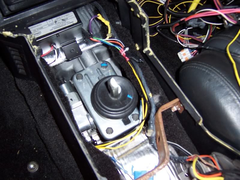

                Pic before I put the center console back together.....just filled the trans with fluid through the shifter hole...much easier that way!
