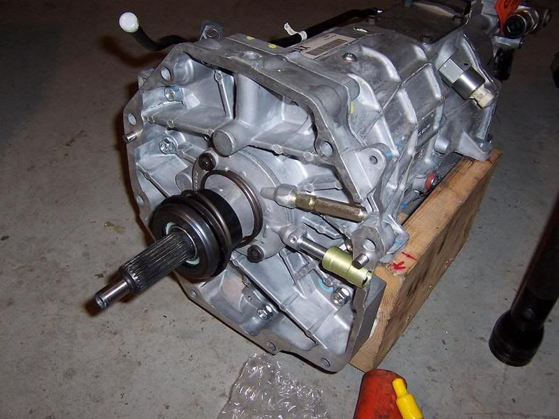

                  Been a slow week as far as progress goes.....
                  Pic of throwout bearing installed on trans....

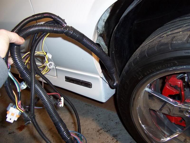

                  This is a pic of how I wanted to run the new harness....but alss it is just to short to make this work.

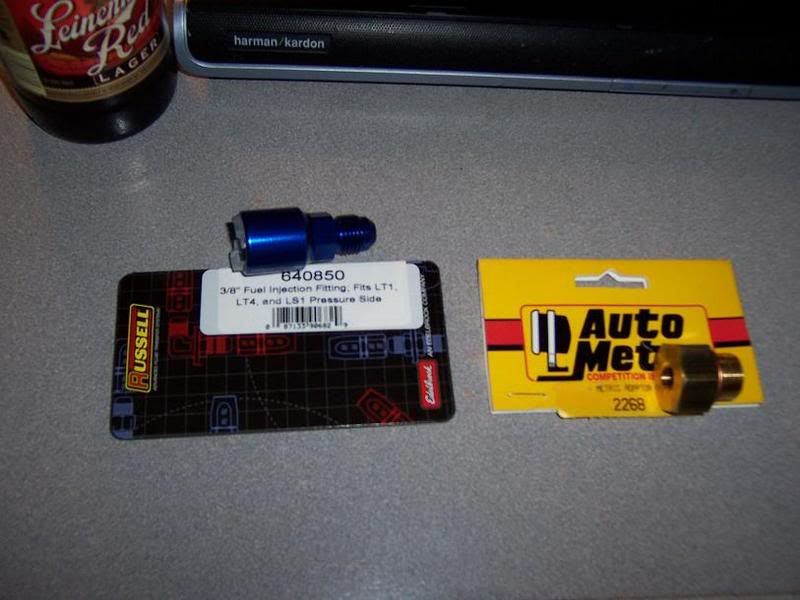

                      Check these little babies out! These are a couple adaptors that I got from Summit today
                      The Russell fitting (640850) will let me hook up my -6 braided fuel line to the quick disconnect fuel rail fitting on the LS1. The other fitting is a metric to pipe tap adaptor made by Autometer (2268 ) This will let me remove the stock oil pressure sender (for gauge) on the back of the motor and replace it with a sender that will work with my gauge. It adapts from M16x1.5 to 1/8" NPT and even comes with a new crush ring.
                      Thought I would post these up in case anyone out there might need these in the future for a swap they might be doing.
                      I am also going to drill and tap out the stock cover on the oil ports right above the oil filter to accept an oil temp guage. The only thing left as far fittings go will be to figure out what I am going to do with a water temp sender.
