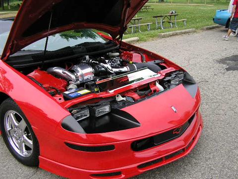

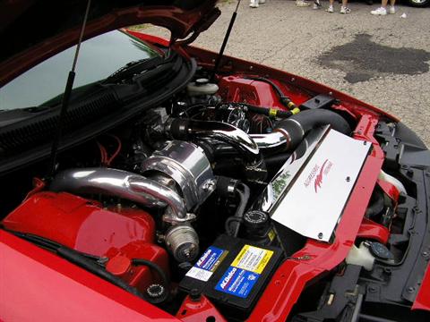

                        Hello I am Derek with the powerdyne supercharger kit, as stated view that link for details. I am debating taking it off the car and selling the complete kit to have some spare money for college and save up for a v8. Kit has worked flawlessly on my stock motor with only injectors upgraded from stock. Definately gives the car a huge kick, truly a fun car to drive now. Ive only had it on since last fall so it probably has under 5k miles on it, maybe under 3k. Kit was entirely custom put together by us based on the kit that used to be sold from RKsport. we improved the kit by adding a bolt that makes belt tensioning a breeze. PM me if you are interested, ill sell it for the right price
                        here is the link to my thread, it is really long but it shows as we upgraded parts and progressed to the final kit I have now. http://www.mifbody.com/vbulletin/sho...t=supercharger
