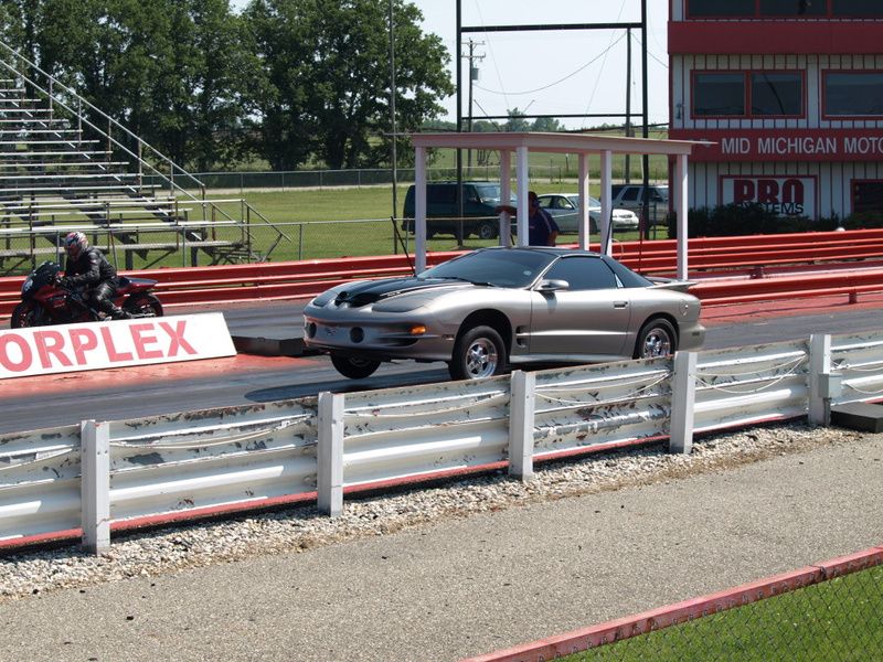

                      Front I have QA1 12 way adjustable coilovers with 315 lb springs, no swaybar.
                      Rear: Double adjustable tubular chromoly LCA's, Spohn chassis mount adjustable torque arm with DS loop, Spohn Anti roll rear drag sway bar(all previous parts have poly bushings), weld in sub frame connectors, QA1 12 way Adjustable shocks(unsure of springs, but not stock), adj panhard bar, weld in LCA relocation brackets, 8 point roll bar..
                      I've included a before and after pic from the track.. 1st pic is minimal suspension work, 2nd pic is in current form.. Proof is in the pudding...
