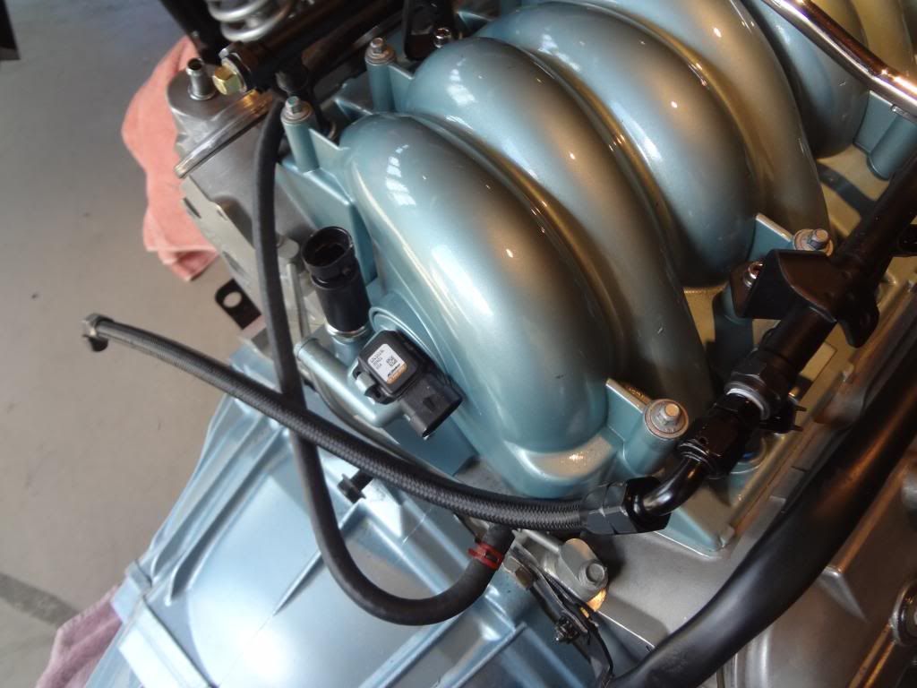

    Ok, been awhile but it's coming.
    Modified stock fuel rail to support a return line. I did this so I could still retain my fuel rail covers.
    Loaded easy. once you do it a couple of times.........
    Yes, it was safe.

    Originally posted by nascarnate326 View Post
    Did you rebuild what you had or are there differences this time around?
    Forged dished pistons & rods. New cam, lifters, pushrods, trunnion kit for rockers. Ported my oil pump. Dual Walbro's 255's in tank with heavy duty 30amp wiring and a Hobbs switch.
    More detailing and painting that needed to be done. Pulled the Plasti-dip off the rockers and fascias and sprayed House of Colors hot rod black on them. Potentially, going to modify the rear hatch and repaint if time allows.
    Steering wheel work and radio control buttons will operate the line-lock and exhaust cut-out, hopefully if I can get the relays straight.
    That's all, I hope!
