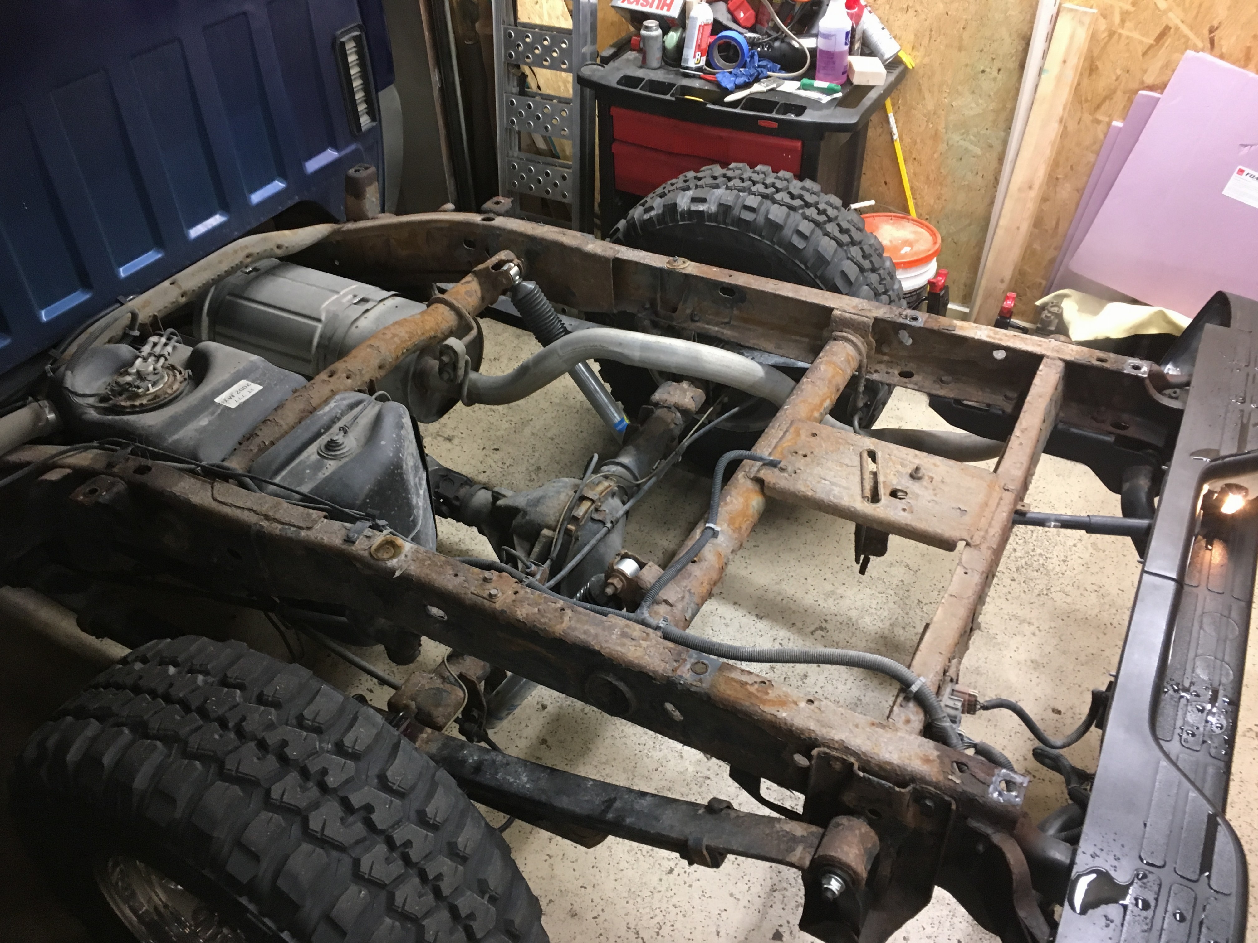

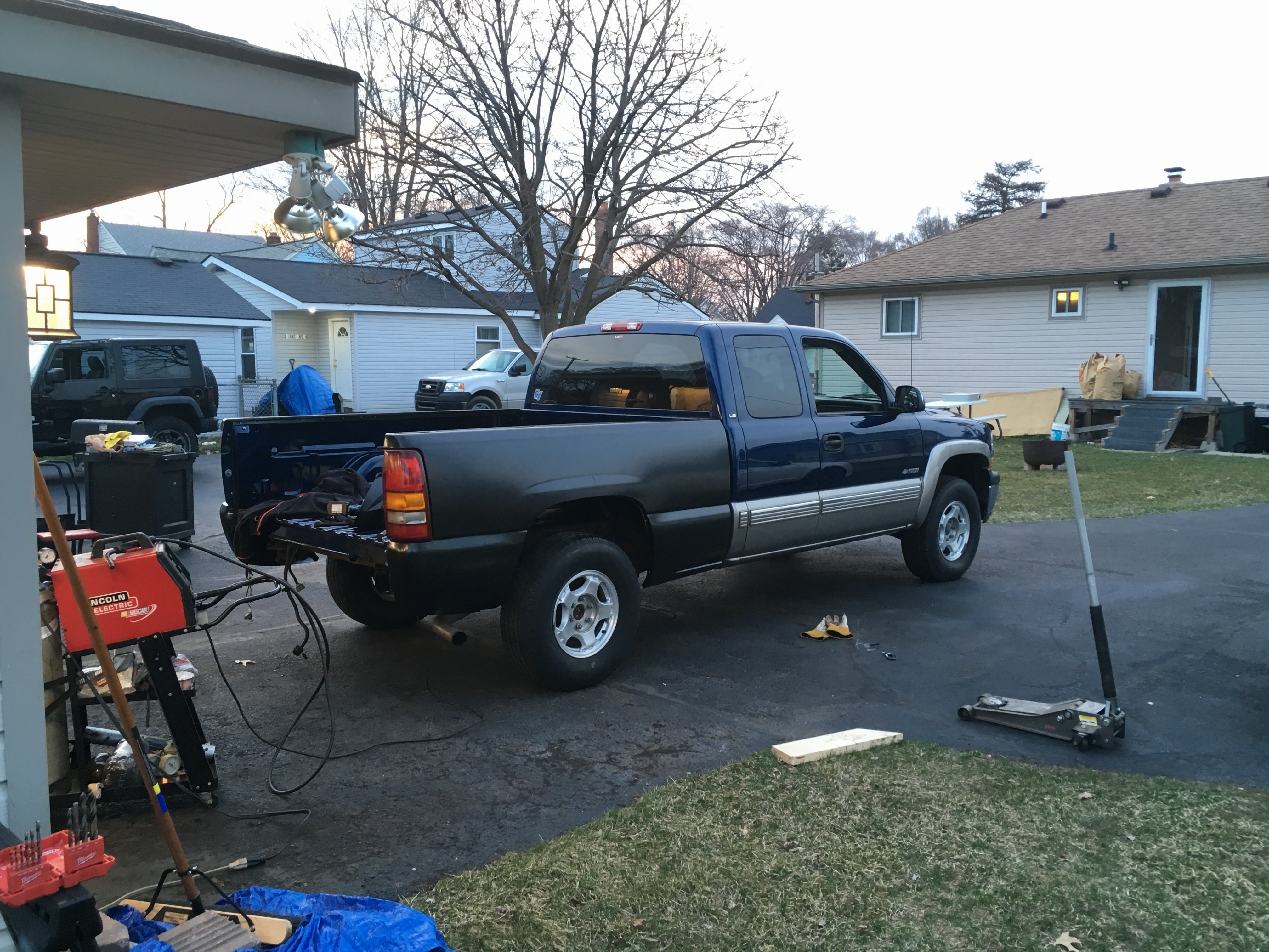

    This is what it looked like when i pulled the bed off, and sitting outside the past couple months probably hasn't done it any favors. Hopefully i will get it indoors again soon.

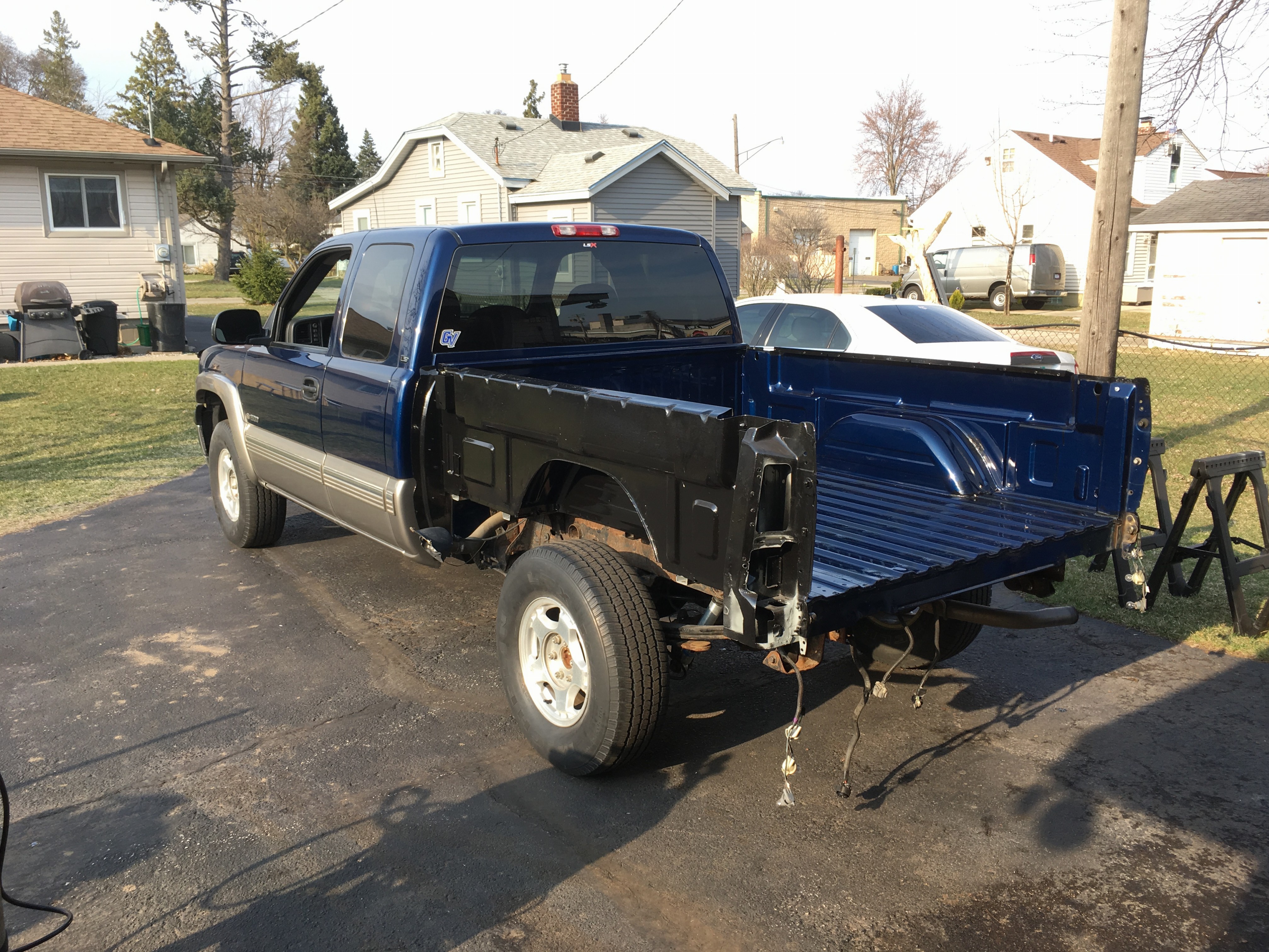

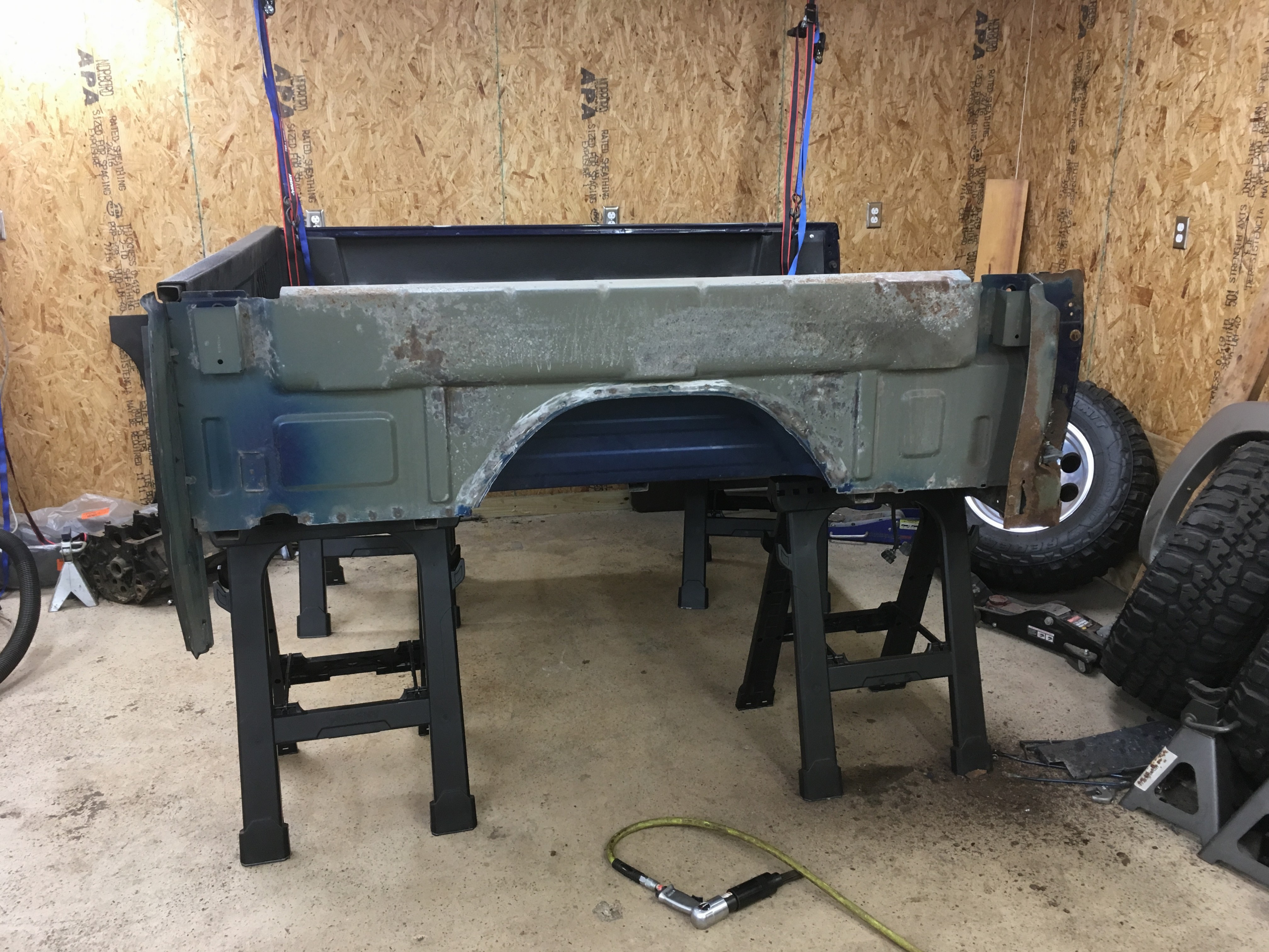

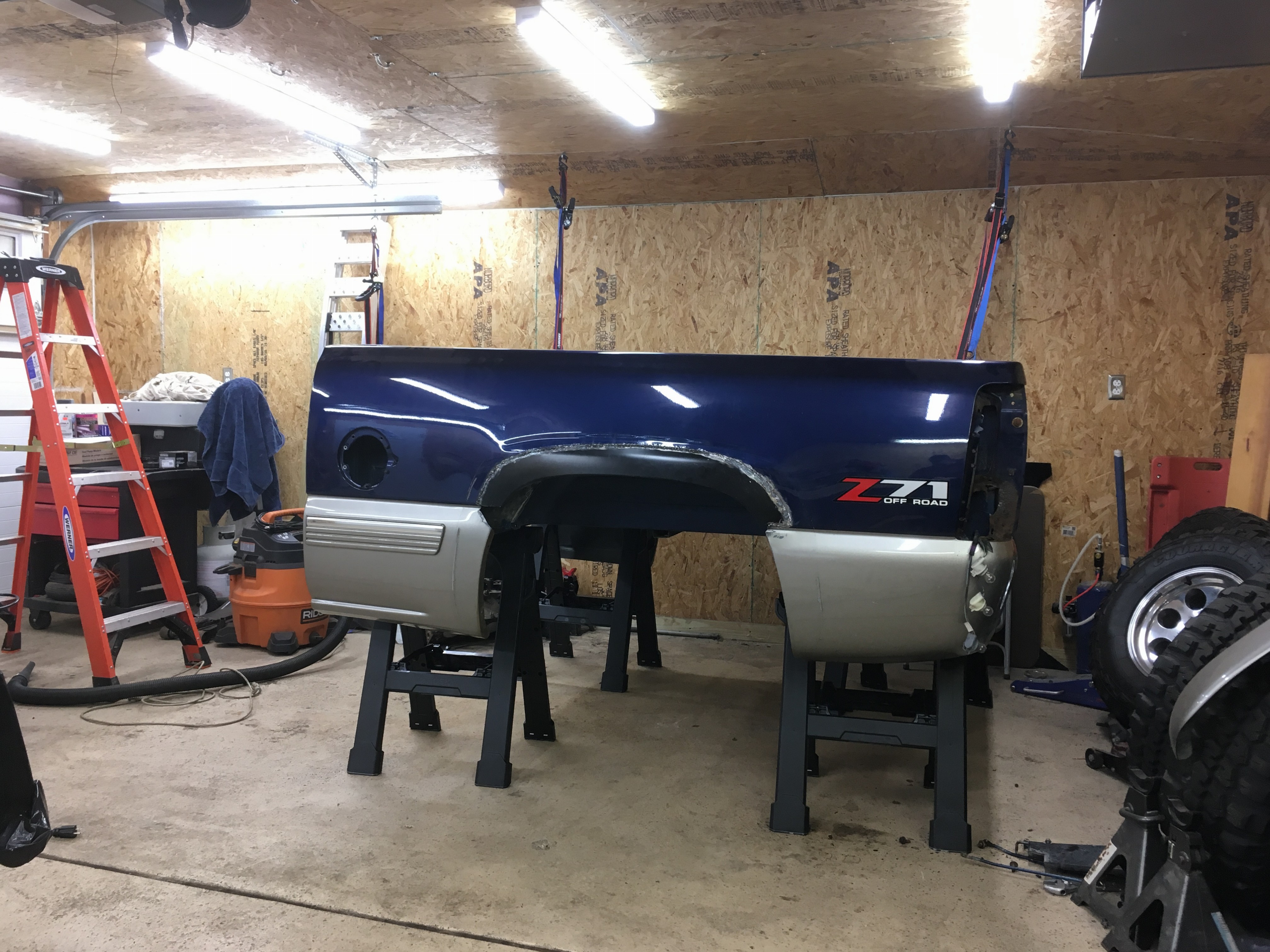

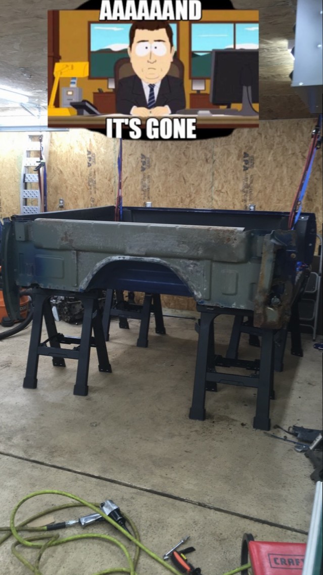

              Got the momentum back on this project today. Took less than an hour to get the bedside off and i suspect putting a new one back on wont take much longer. This was the right way to go, it lets me take care of all that rust i couldnt get to with the bedside on, and i bought a bad ass metal scaler to make quick work of it. hoping a few more nights in the garage and I'll be ready to dump it at the body shop for paint and wash my hands of it. I'm thinking about hanging the passenger bedside in my living room as wall art. Too bachelor of a move?

                One of my favorite moments in South Park to use as a gif!

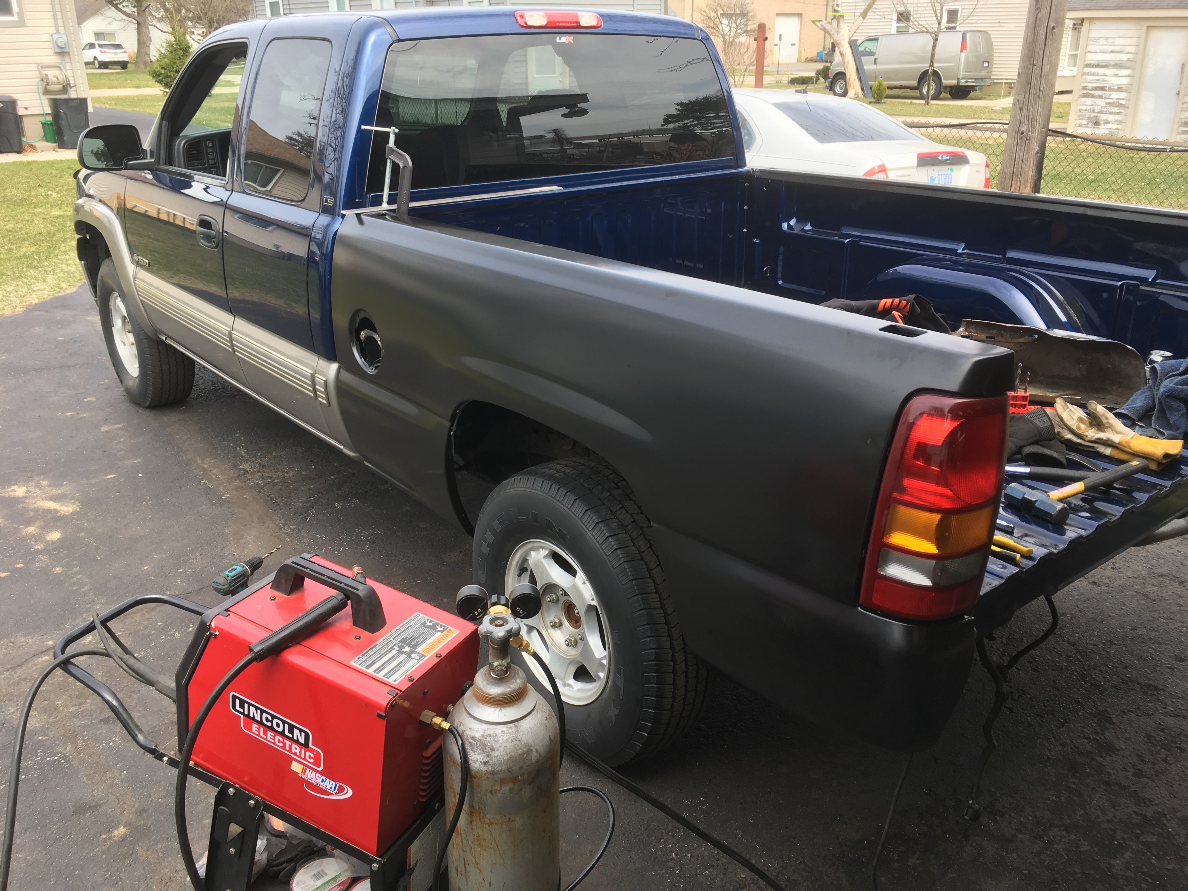

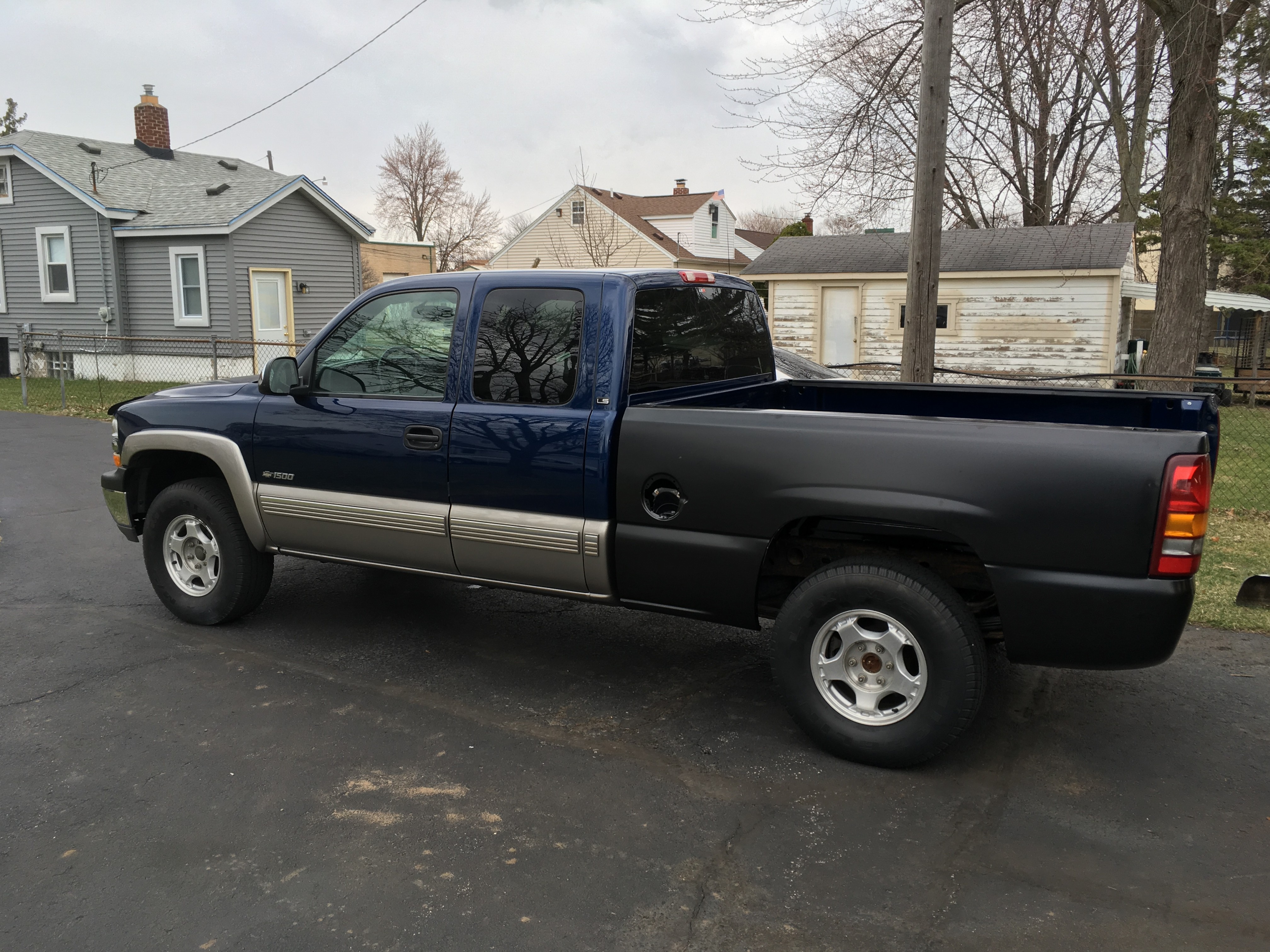

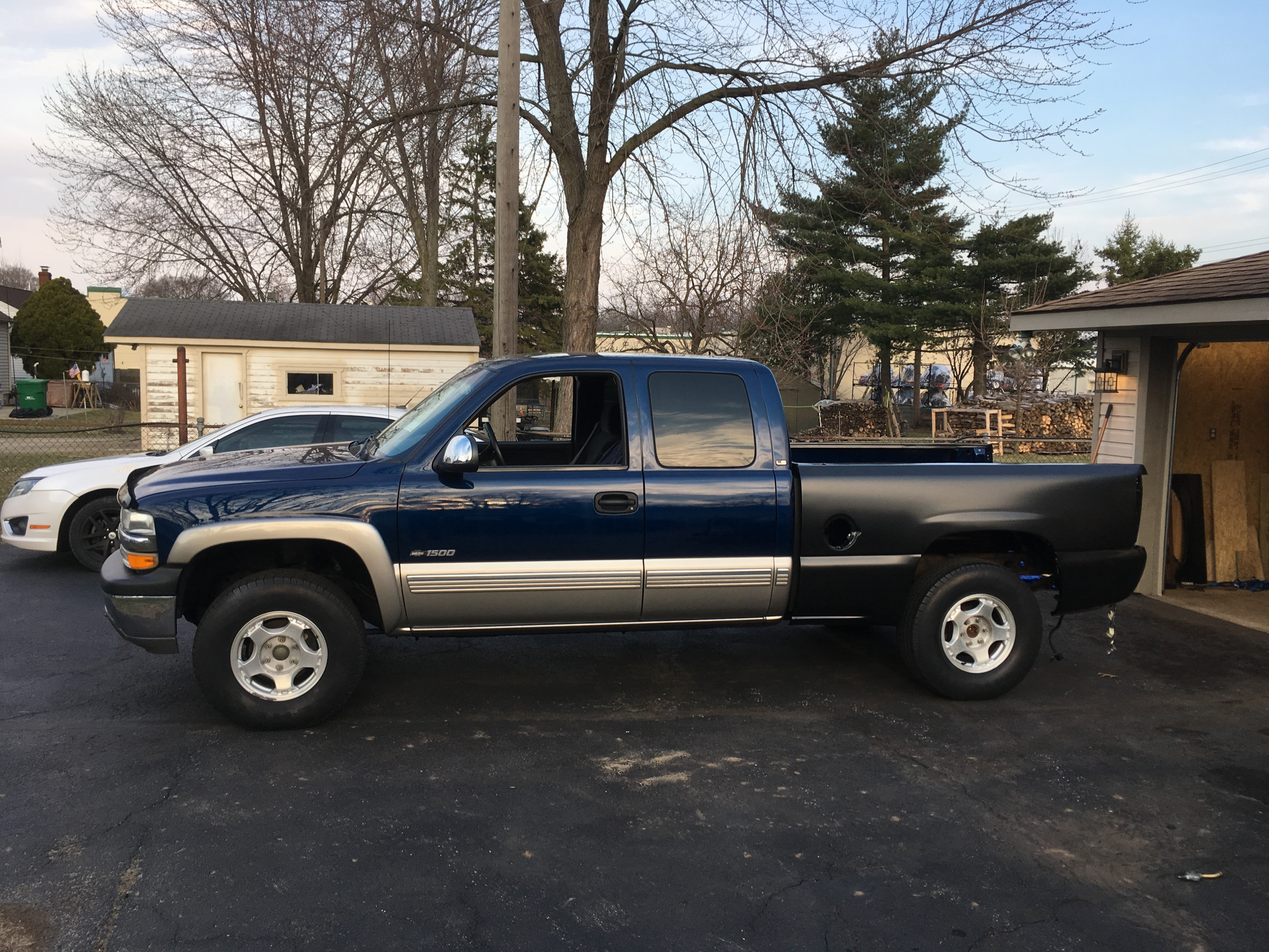

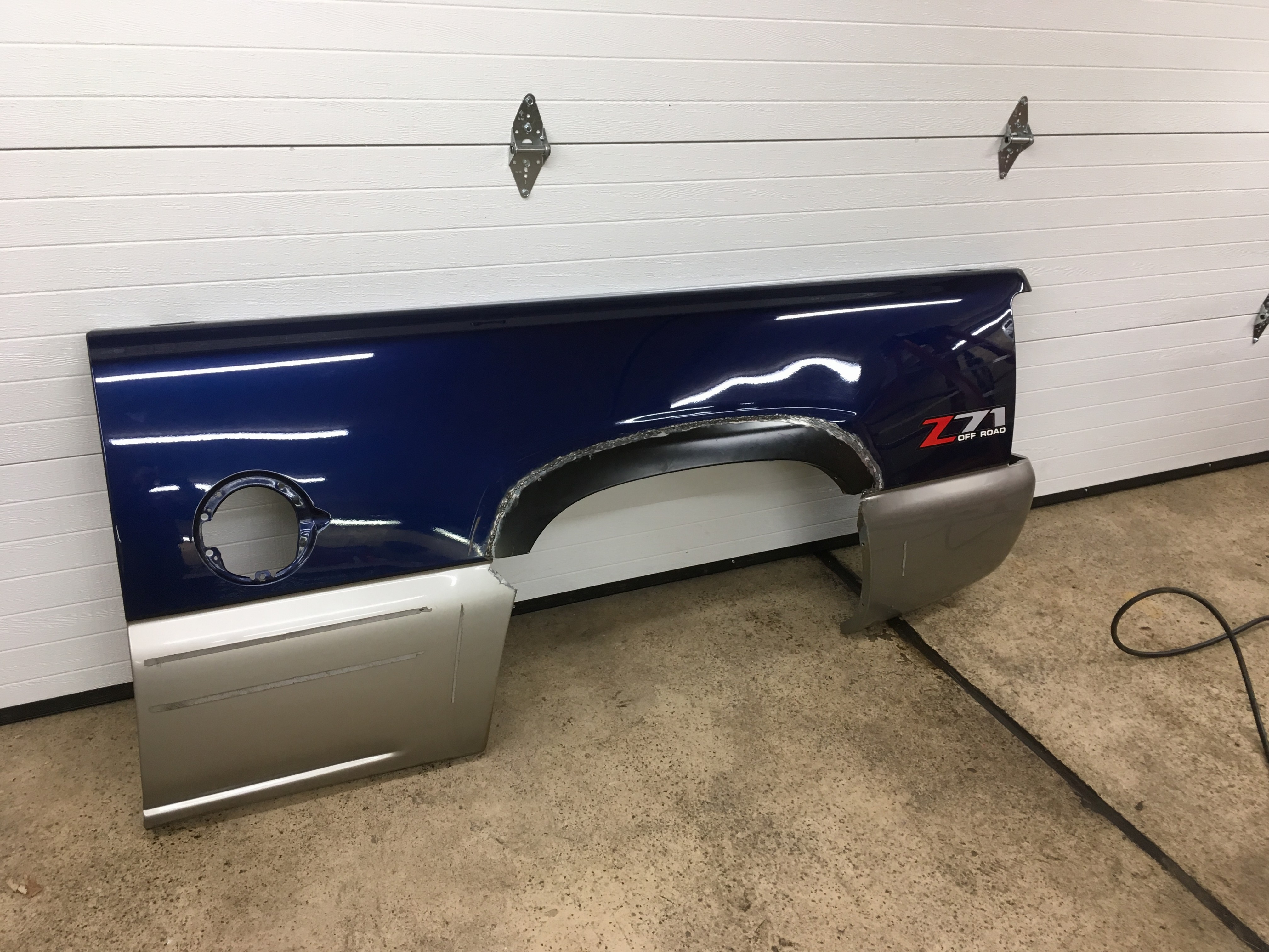

                    image_59750.jpgimage_59747.jpgimage_59751.jpgimage_59749.jpgimage_59748.jpgimage_59746.jpgimage_59752.jpg Some more progress. My goal is to have this back together and be daily driving it by May 1st. In the last week and half I've done:
                    -Coated one inner bedside with painted with 2 coats of POR15.
                    -Got the hitch and bumper assembly off and apart. Hitch is still solid unlike how it appeared but will be replaced with a new class 5 anyway. Bumper needs a new main brace and a couple brackets which should be here today.
                    -The new bedsides came in last night and my heart sunk when I saw how they were tossed onto a shipping pallet. Thankfully i lucked out with only a minor ding exactly where the body molding will cover it up but I'll have Curt fill it in anyway. Not worth the hassle of returning.
                    With any luck I'll have at least one of the bedsides completely finished this weekend. Hopefully more.
