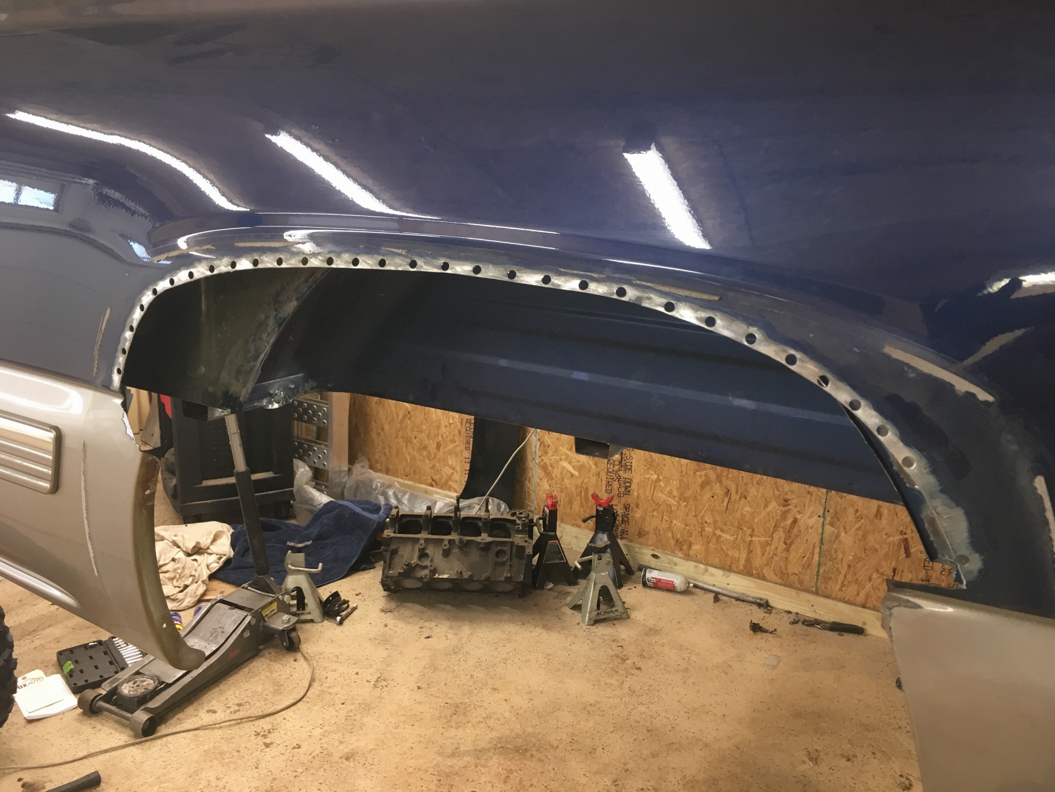

      Anyone a body guy by trade here? Wondering what the recommended method is to seal up a plug/flange weld. Since this steel is so thin and easy to warp, and the fact that this seam will be hidden under the flare, I decided to flange the bedside and do a seam/plug-weld joint instead of the typical stitch weld. It worked in the sense that it seems much stronger and doesn't seem prone to warping. However now that I have this tacked into place I'm thinking about the bare metal that will be inside this seam, and wondering how prone it will be to rusting inside out. In theory if i seal it externally 100% the bare metal inside should never be an issue. I could undo my 3-4 tack welds and spray the joint with weld-through primer. Not sure if its worth the headache or not, welding with the primer might be a lot messier. I could also try to leave just enough gap on the outside to "fill" the seam with paint, but not sure how well that would work.

        Use the Zinc weld-through primer.
        We use that in similar situations when reworking the Fiat Doblo into the Ram ProMaster City.
          Thanks, It doesn't make the weld splatter or burn through or anything like that?
            No, I don't believe so - assembly plants tend to get whiny about that kind of stuff, but I see it used pretty widely in a lot of the car TV shows as well. It's good stuff.
              You can use a weld threw primer on the inside. Before you weld it in. But if your concerned about the inside rusting... you can take the body plugs out of the inner wheel well, and coat inside. Or take the tail light out, and use cavity wax with a long wand.

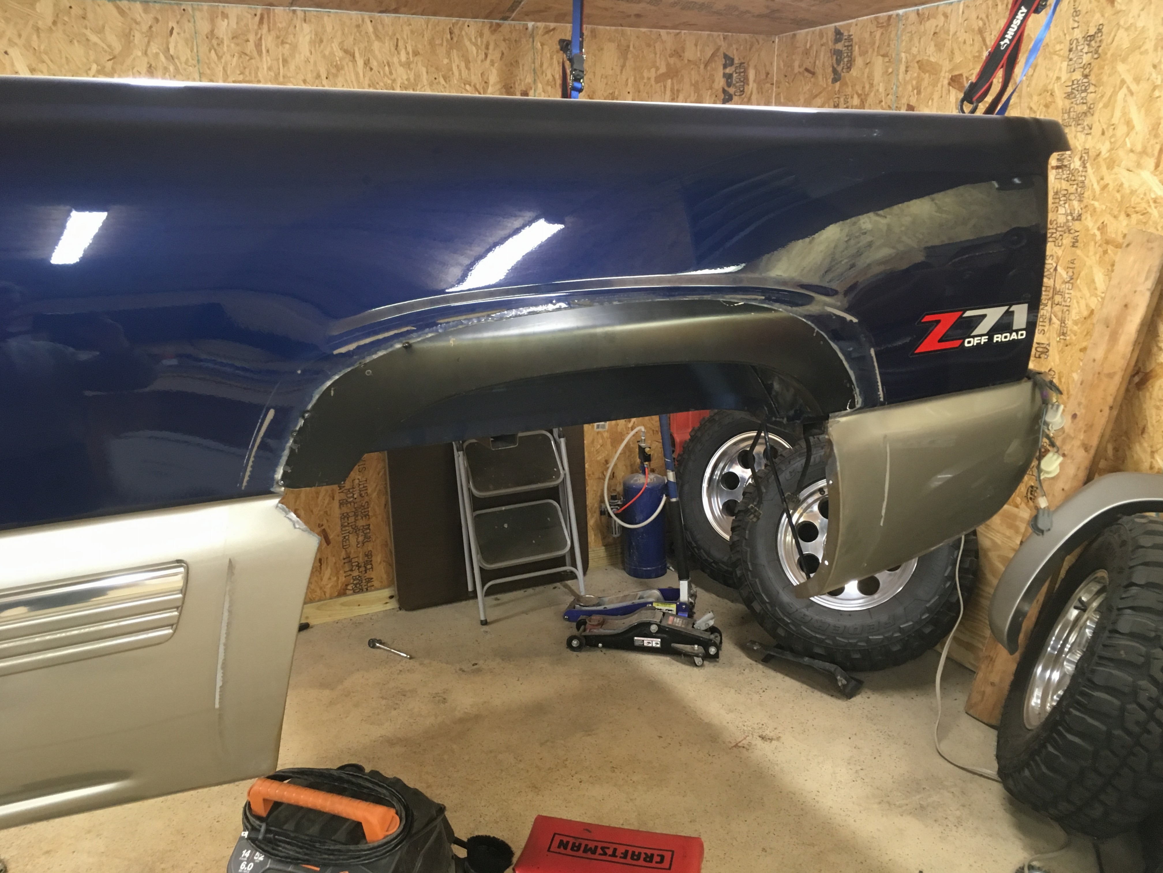

                So when I started this project in December I thought I was going to have this thing back together by the end of January. I guess its a good thing I haven't made a career of scoping projects. Over the last month and a half ive invested several hours wokring on just a single patch panel. I'm sure I could have avoided much of that time spent with more experience in bodywork, but thats half the reason I wanted to dive into this. Unfortunately I'm now at the point i think its best to cut my losses on patching these bedsides. I was trying to balance a thin line between shitty welds, or good welds that would warp the panel, neither of which were acceptable. Long story short, its warped pretty bad. Even if I were to just deal with the wavyness in the panel, the weld seam is gonna come back to haunt me. Slapping on a full bed side is just sounding a LOT easier at this point.
                So in summary it looks like im in for all new bed sides, new front fenders (I happened to score a set for $40, so that's a win!), and at that point it might as well be a complete paint job. That also isn't including some frame repair that might be needed. You could say I've bitten off a little more than I can chew with this one I'm probably going to take a breather from this project and switch back to the K10 for a while since I'm probably closer to the finish line on that one.

                      Thanks! You know, its almost tempting to cut the patch out and see if the panel straightens itself, then i could glue another one in and save it. But i think chances are, the warping is into the original panel even without the welds pulling on it.
