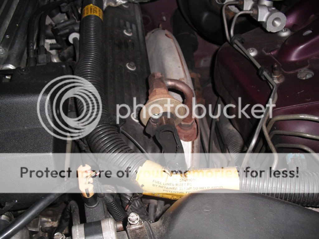

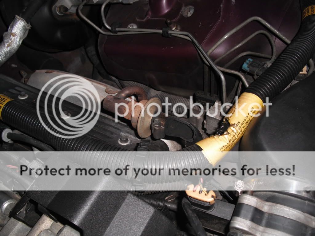

    Damned good reason to delete your AIR pump if you haven't already. Being that our LT1s are getting "up there" in age - the valves that the AIR pump uses can fail. If the valve fails, it lets HOT EXHAUST GAS out into the rubber hose which can catch fire / melt.
    This guy only drove for 10 minutes - just think if he continued driving longer. The plastic around the fuel lines already melted... 10, 20 minutes longer and you'd have fuel blasting all over your engine and right onto those super hot exhaust and intake manifold.

    damn!! that could have turned out bad!!

      Melted right over the fuel line, nice.
        Yeah exactly - with our cars getting older these valves are going to get more prone to failure.

            I always thought plastic fuel lines were just a bad idea to begin with. That could have been a nasty fire should he have not caught it in time.
