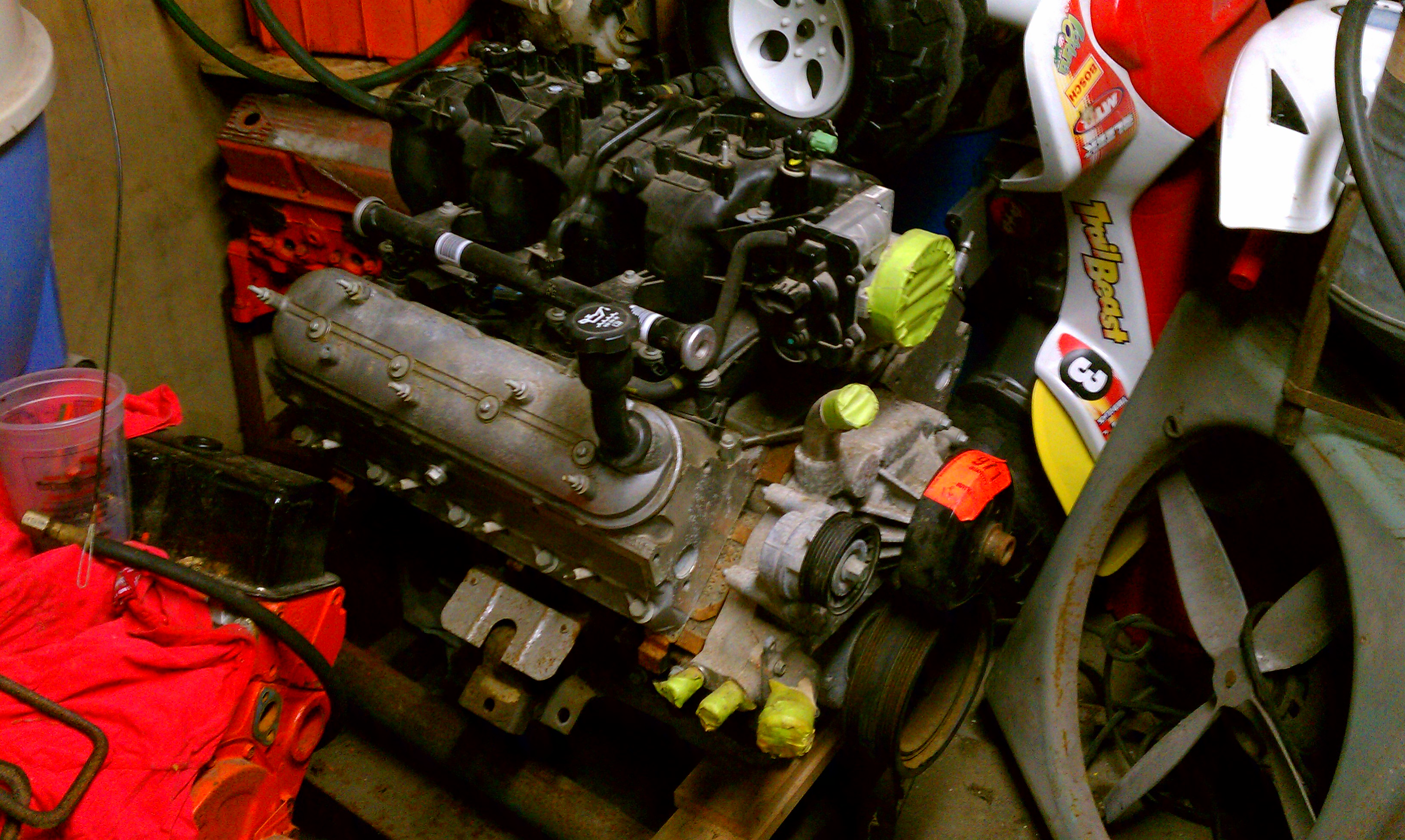

            Just got back.
            Motor looks good and clean, block is casting number 12551364, which could be an lq4 or lq9. Im assuming its an lq4. Externally is there any way to tell the difference?
            Ran into one thing that really worries me, it has an electronic throttle body, while I dont give 2 shits about the actual throttle body, they started putting the 58x reluctor wheel in them when they started putting the electronic throttle bodys on them, or somewhere in that time frame. If thats the case I need to find another motor. Does anyone know if theres any way to tell what type of motor this (24x/58x) is without pulling the pan? I assume its a 24x the more I think about it as the cam sensor is in the back of the block, not the front cover, can someone confirm.
            Last thing, got to talking to the guy, he honestly doesnt know the mileage on the motor. It does look to be in good shape, but have no idea, and this scares me, I dont want another 5.3 incident....
            Thoughts?

                  Buy it. That thing looks clean, if its rear cam sensor its 24X. Don't worry bout rings and bearings, they'll be fine. Once you get that stocker cam out you'll get a better view of things
