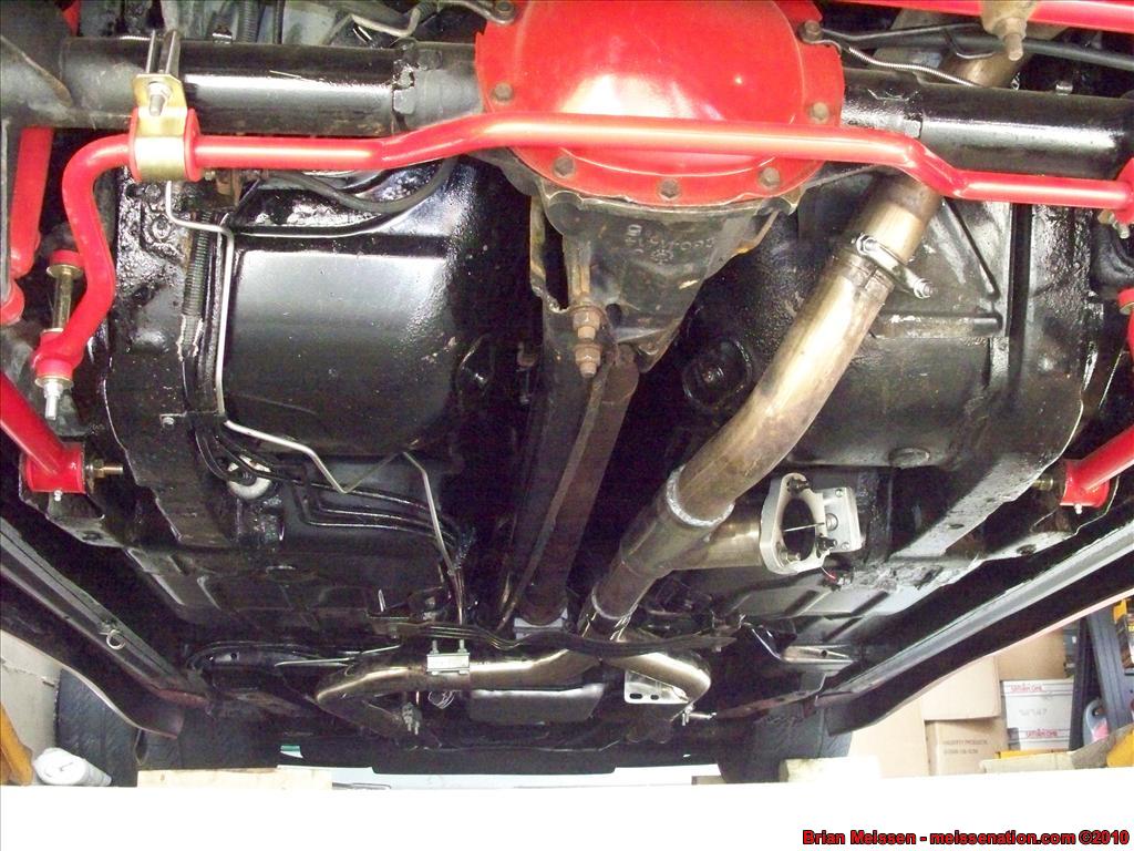

            • Well, just a little update on the car as a whole. We finally got under the car today to figure out all the rattles to the exhaust. Turns out both of the clamps for the headers to y-pipe were loose, and both of my O2s were loose... Plus the y-pipe was hitting on the tunnel brace. So, we got all that fixed and now she doesn't rattle.

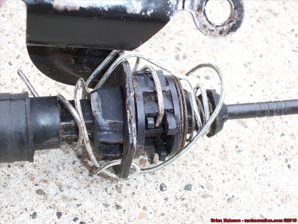

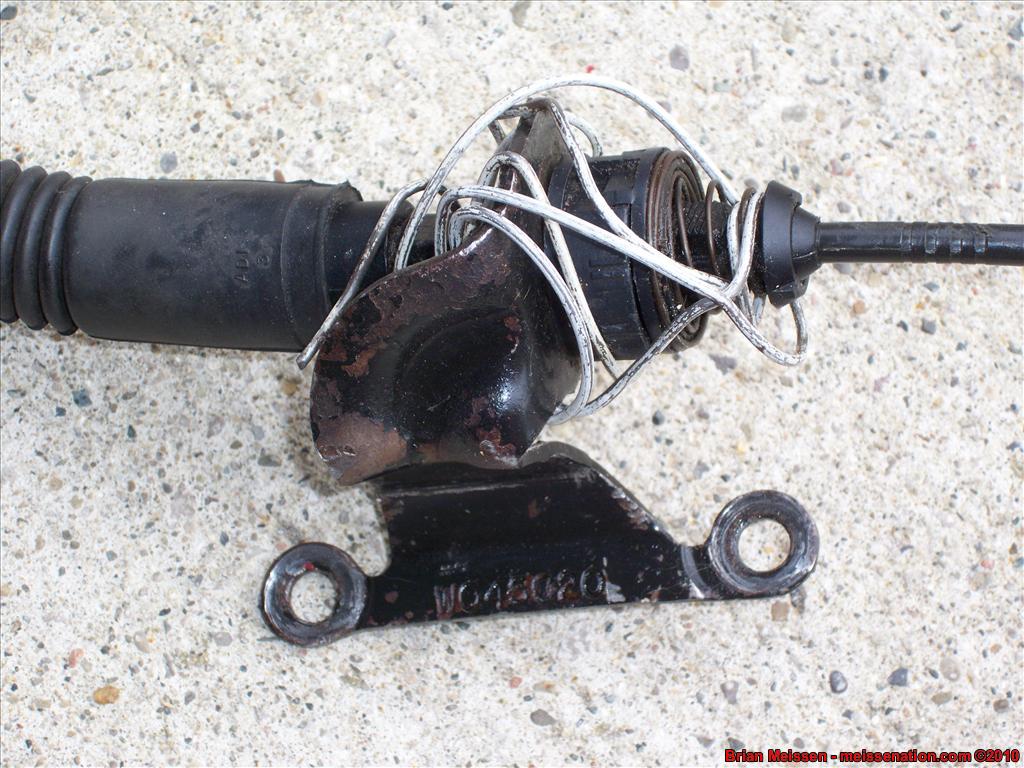

              And here's some more pictures of my awesome ghetto rigging to the shift cable. I got a replacement cable from Dan last night out on Woodward (THANKS AGAIN, DAN!!!) - apparently they really upgraded the cable in 1997 compared to the '94 and '95 cables that we had.
