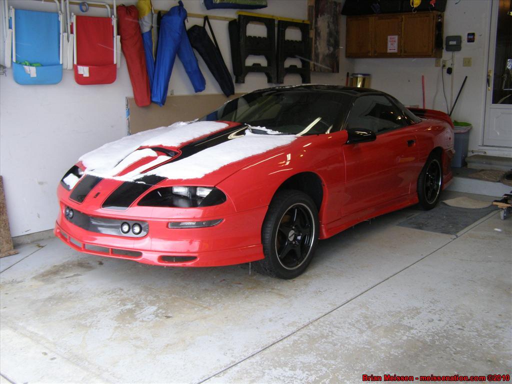

    And on a positive note, once we finish eating some lunch, it's time to move Red Alert back into the garage!

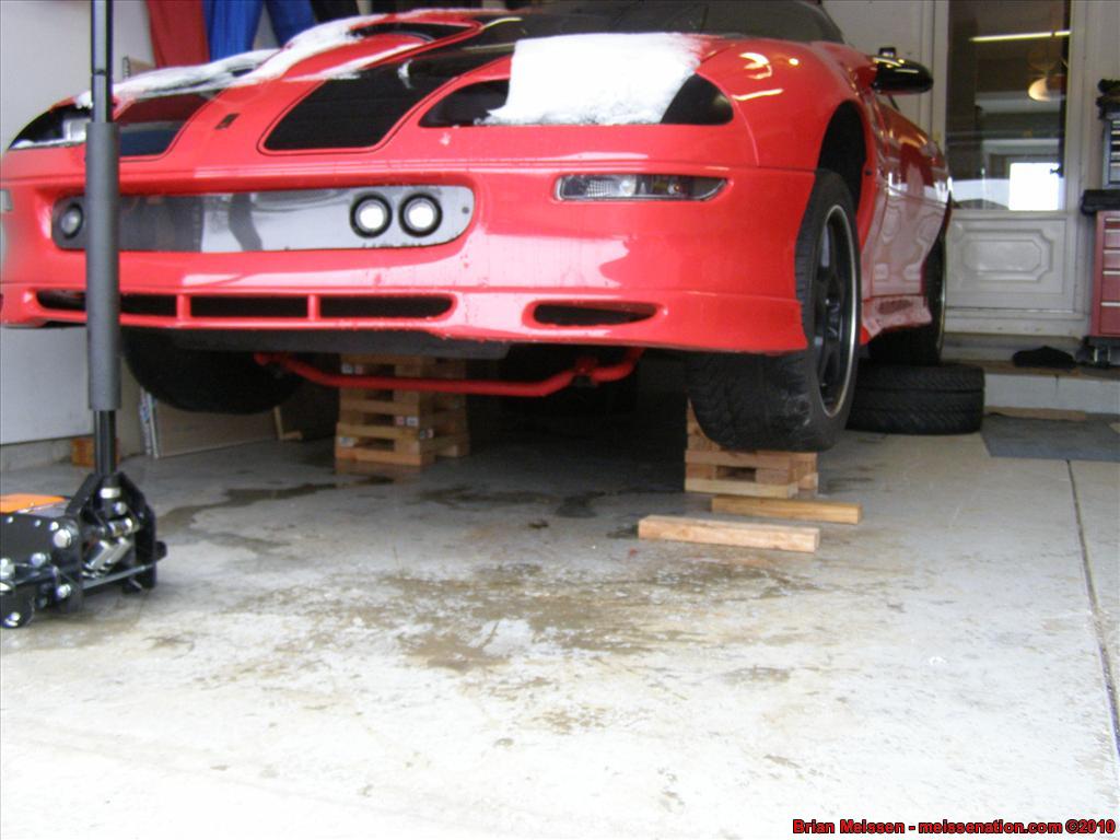

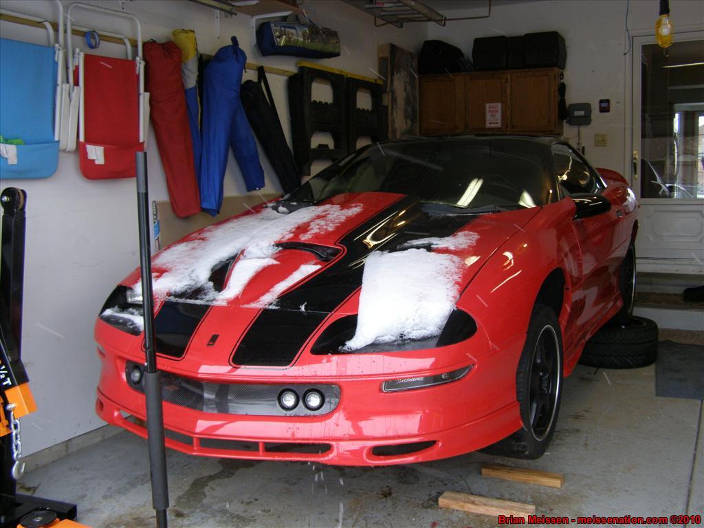

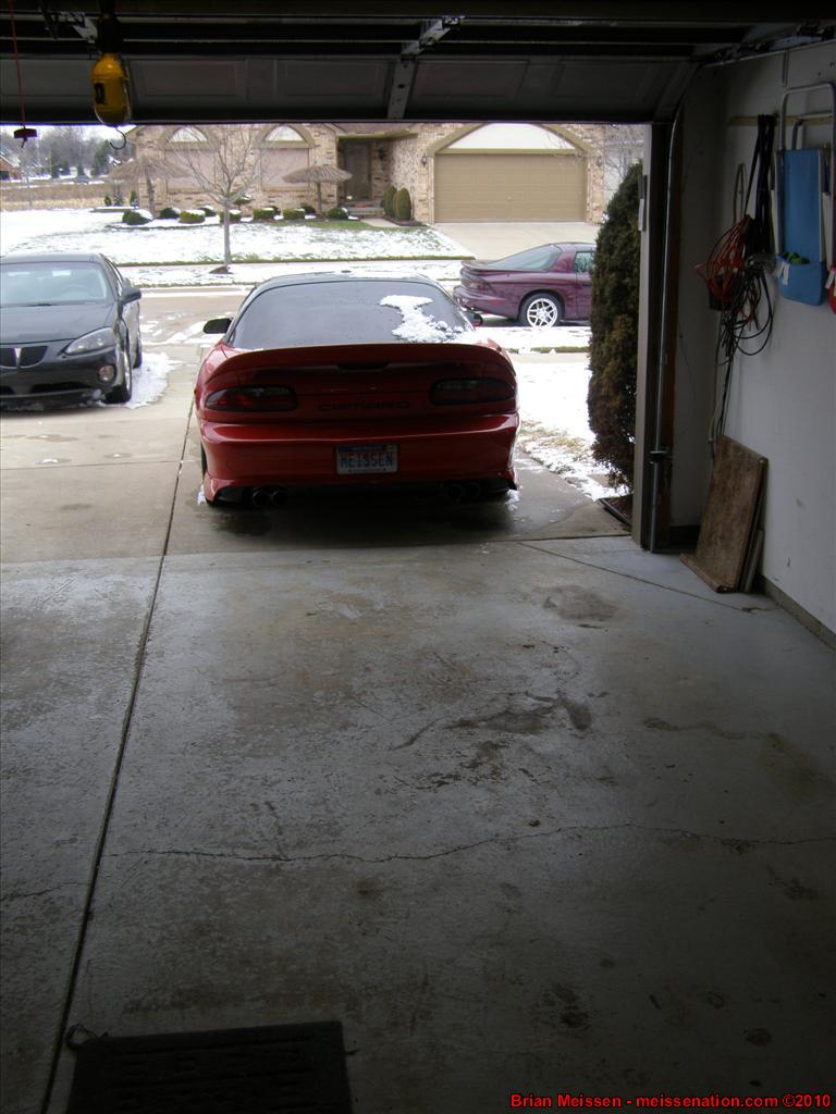

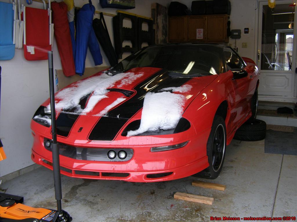

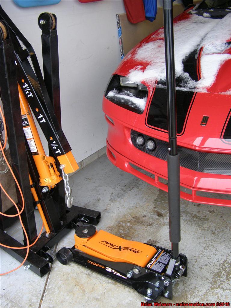

            • Work's been done! I'll let pictures speak for themselves and give explanation at the bottom...

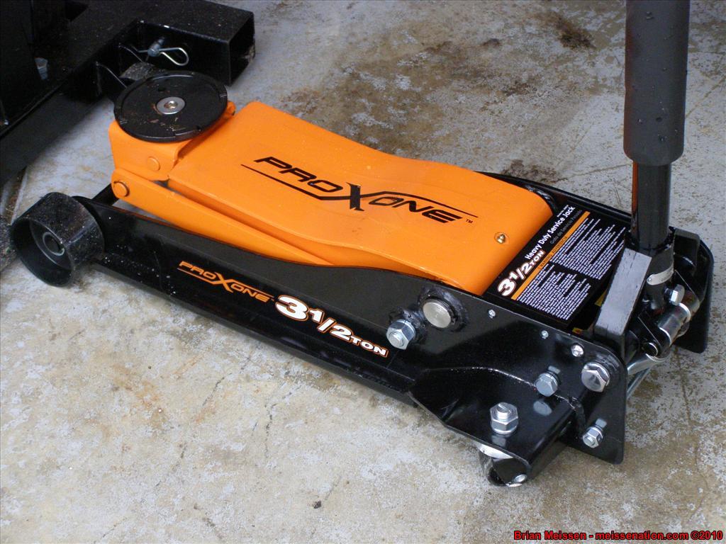

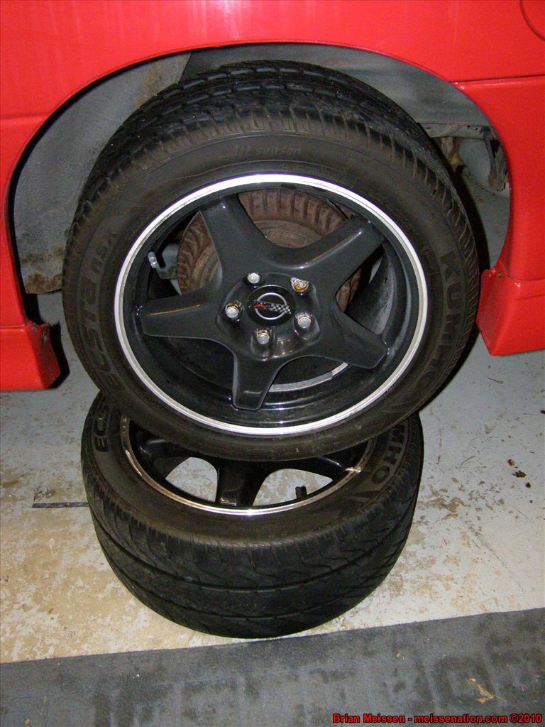

              Here's the jack we bought at Murrays at 24 and Hayes. It only cost $130 including tax but it's only 4" high so it goes under the car to the jack position with no problem (right now) and it raises up 23" so we were able to jack the car all the way up and get the rims under the tires without having to use any blocks of wood (if y'all remember one of the first progress posts in here)
              Otherwise, everything went really smooth. Current progress plan:

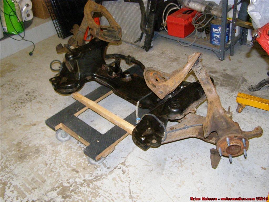

              Monday-Friday - Get the shocks, springs, and motor mounts all put onto the v8 kframe. Drop the v6 kframe and get the steering components put onto the v8 kframe. Mount the LT1 onto the kframe. Roll the kframe and the LT1 under Red Alert to just store it while we're not working on it. Get v6 kframe out of the garage. This will then allow my mom to go back into the garage - which is a political move.

                I coulda used one of those jacks...then again, mine cost $29.99 with two jack stands, haha.
                      x2, I have to drive up on two 2x6 boards every time I want to jack the front end up by the K-member. Looking good B!! I knew you would make some sort of a schedule for it, lol.
