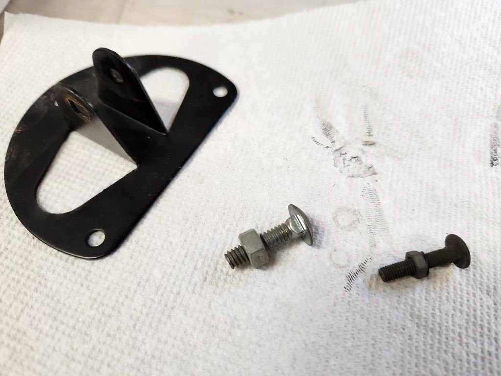

                              Can't recall if I mentioned this either...a small side project to clean up the factory Goodwrench alarm install. The horn bracket was a little rusty, had a broken mounting screw in it (when that one broke off, the added another), crimped connectors with electrical tape that had long since unraveled, and wires run here and there with no real attempt at neatness. The bracket had a little rust, and the carriage bolt holding the horn to the bracket had a ton. Removed the bracket, and put the corroded fastener in an acid metal prep bath. The between work, the holiday, and family, I forgot about it. When I cleaned it off, it was hopelessly eaten away and undersized. This bolt is close, but will have to have the square area behind the head reduced in size a bit.
