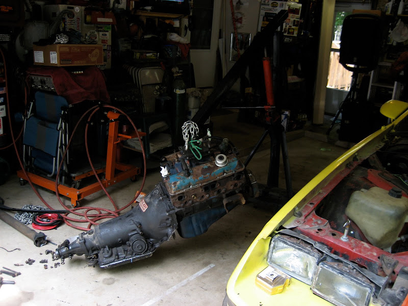

Trying not to post too much about our setup online, it is a race . Its more of a generic question trying to find some inexpensive ideas on how to keep a SBC alive. Its basically a older pre 80s 350 with mild cam and a quadrajet. We are heavy on cooling radiator. We have a external tranny cooler.
