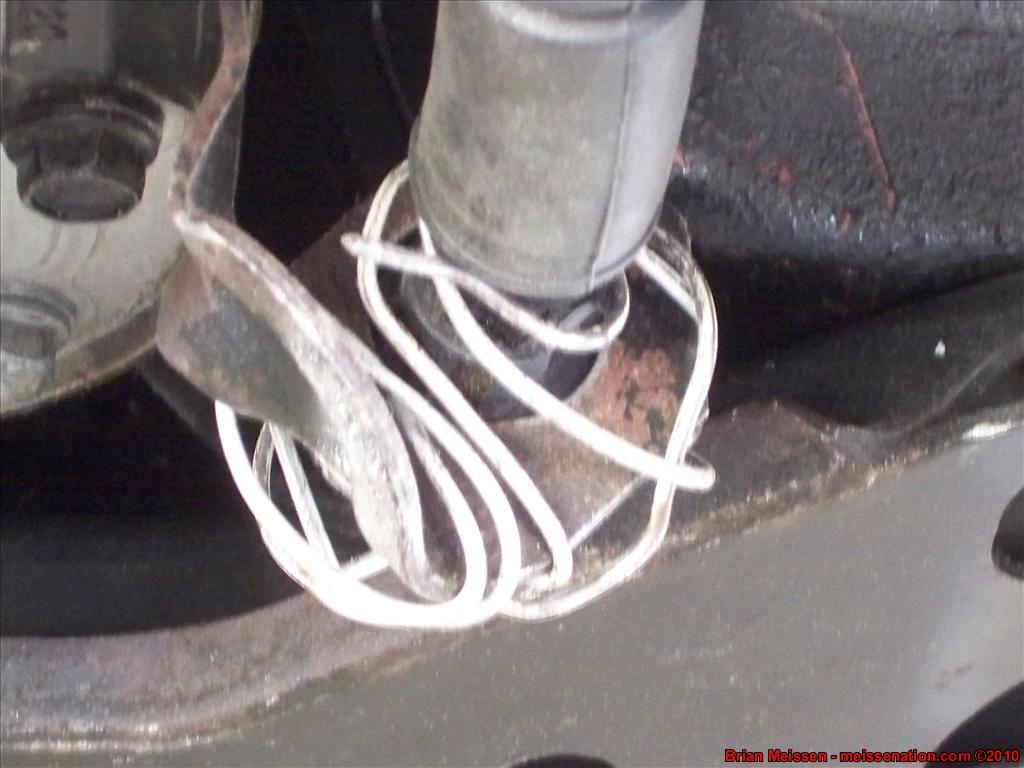

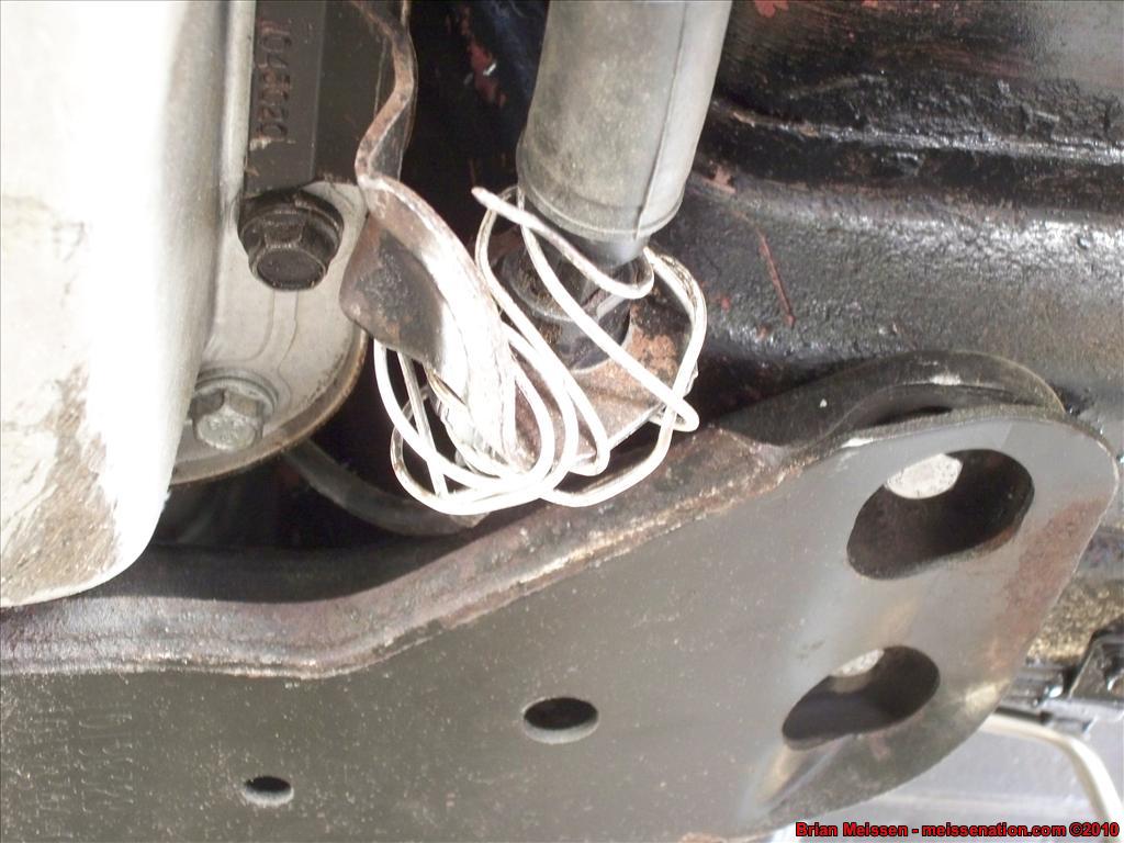

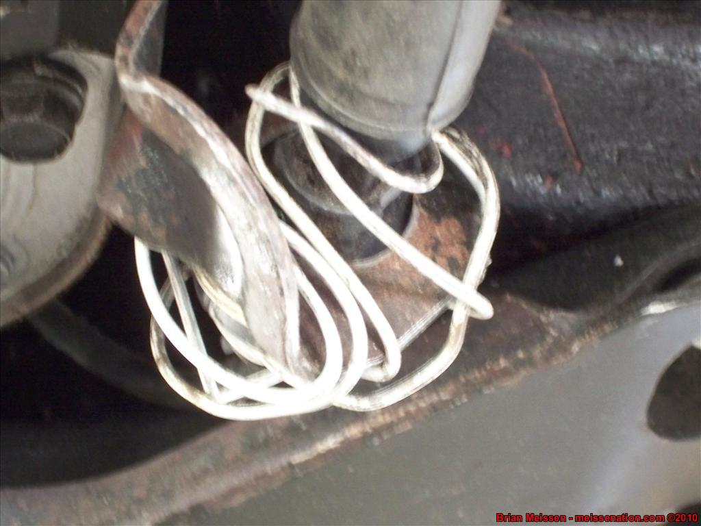

    Was changing my oil tonight (250 mark) and not only did my dad and I make some discoveries but I also took some pictures of my awesome ghetto rigged shift cable bracket.

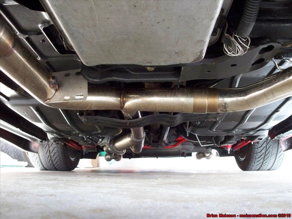

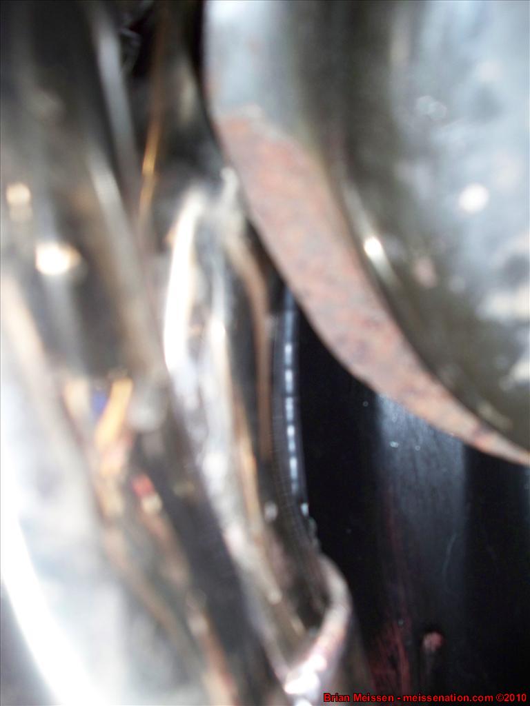

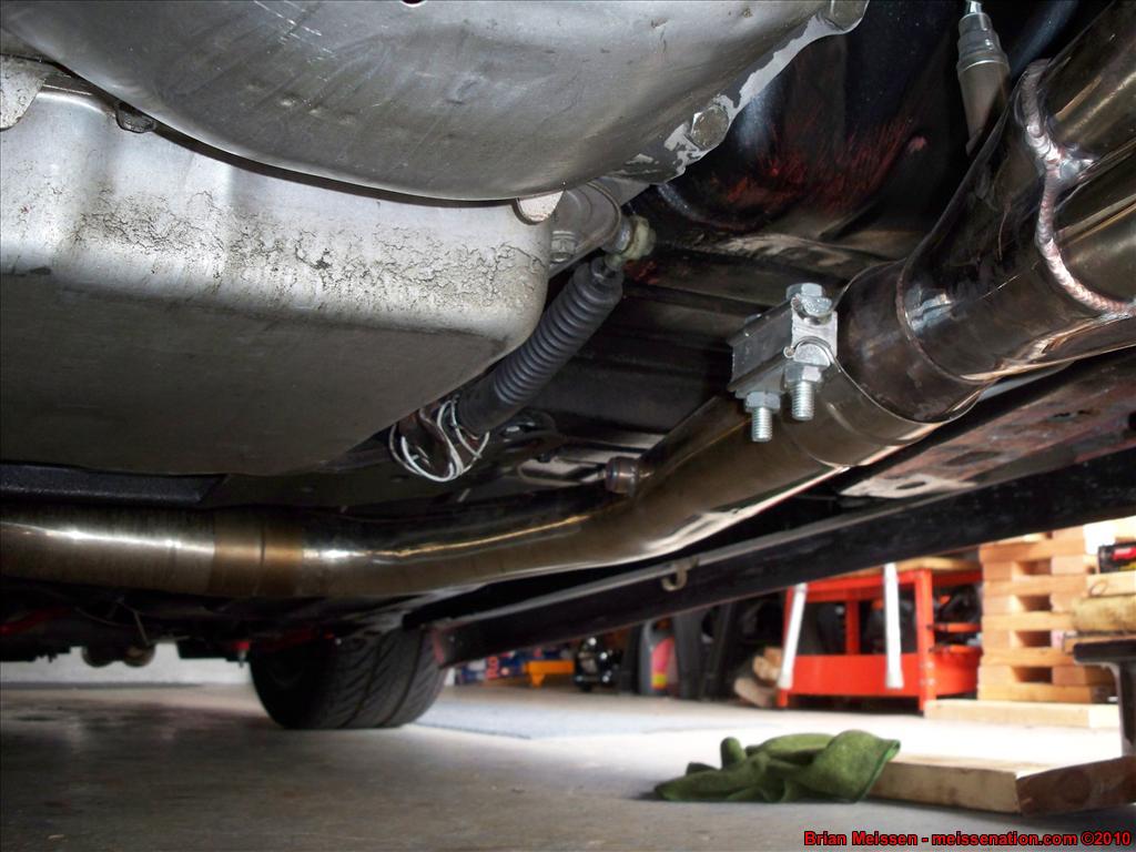

    ALSO - Kyle and Mike you'd be VERY interested to see the pictures too. When we installed my headers I don't remember noticing any issues with clearance but now that my engine is bolted in - I've got less than a quarter of an inch between the headers and the k-frame on both sides. I'm absolutely dumbfounded how there can be THAT MUCH of a difference but the proof is in the pictures. I just wish we knew what we did the first time around that caused the headers to have so much clearance. Whatever it was, we didn't do it the same way the 2nd time around but I think that all the people who had issues with clearance have something to do with the same thing.

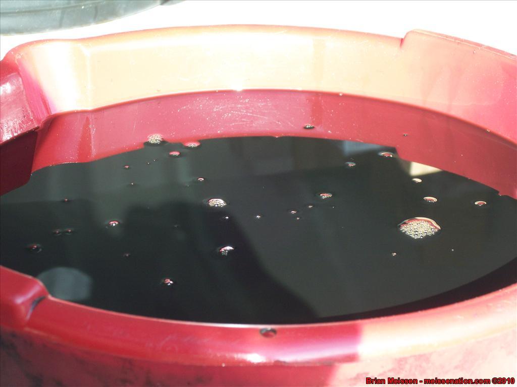

    So our biggest discovery - look at how much oil is in the red pan. My dad can't remember if it's a 5 qt or a 6 qt pan - I'm guessing 6 - but what we do know is that when we drained the oil after we spun those two bearings ... we had the red pan filled to the point that it was ready to overflow and then had about a half a quart that emptied into our other pan that we have. That means we had about 1 to 2 quarts of PURE GASOLINE in our oil when we spun the bearings... NO WONDER it only lasted 80 miles!!!

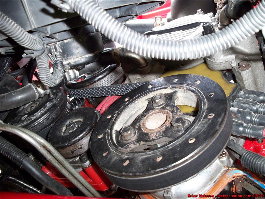

          nice but you scratched all the paint off of the pulleys and stuff. Gotta take them back off one day and paint em.
            That looks about right with the oil B.
            I have one just like that and it fills to about 1" or of the top
            Ya, those headers are VERY close but the main thing is that they are clearing.
            I wonder if you got your mounts a little different the 2nd time??

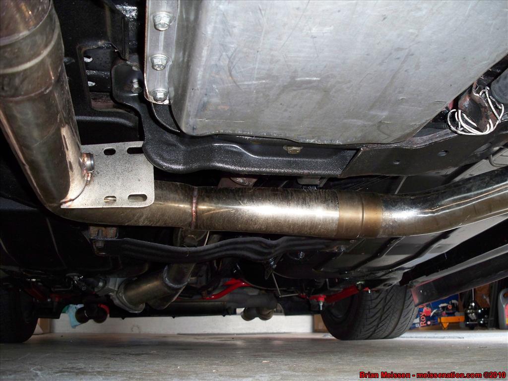

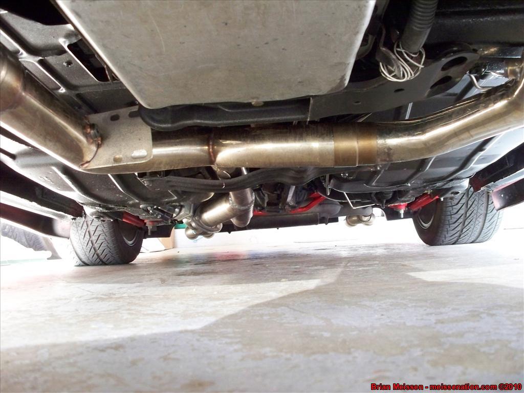

              The merge on that Y-pipe looks terrible. But other than that the car/build turned out great man!
                Meh, the pulleys are the last thing I'm worried about - you can't even see them with all the garbage up top on these cars.
                Yeah - but I bet with a little bit more of whatever caused me to lose as much clearance as I did that I'd lose even more clearance. I'm wondering if it's the exhaust that pushes down on the headers. My y-pipe was welded to the intermediate pipe.. kinda sucked, but it wasn't too bad since we can just remove the intermediate pipe from just before where it goes up and over the axle. When I put the y-pipe/intermediate pipe back in it was a fight to say the least. I noticed as I adjusted the intermediate pipe that my tailpipes significantly changed their angles so I'm pretty positive if I would have paid attention I would have noticed the same change in the headers' clearance. At some point I have to get back under there to adjust the exhaust again because it's rattling against the panhard bar - when I do, I'll report back what I find. I posted up on LS1Tech's LT1 section with my comparison pics for clearance... I think whatever I did the 2nd time is what is causing the fluctuations in clearance.
                      On the 2nd engine removal I took the bolt out of the motor mounts not removing the part on the k frame. Only diff is after block machined and cleaned is the paint and reassembly of motor mounts on the block. ???
