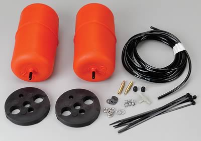

                I personally would just go with a set on these rather then air shocks.
                They work Great. Several Members of WMCC are using these to solve the bottoming out issues caused by the Eibach drop springs.
                Air Lift 1000 Load Assist Rear Spring Kits
                Solve your suspension problems.
                No matter what you drive, Air Lift 1000 Load Assist rear spring kits can solve your suspension problems. These air springs are inflatable air cylinders made from tough polyurethane material, and fit inside your coil springs to add up to 1,000 lbs. of leveling capacity. Each cylinder has an inflation valve, so you can vary the air pressure to level your vehicle and compensate for uneven loads. Load assists reduce roll, sway, and bottoming out, and are available for most cars, trucks, and minivans with open coil springs. They come complete with air lines, fittings, brackets, and mounting hardware.

                  That looks like exactly what I need, Gary! Thanks for the link! I've never seen those before.
