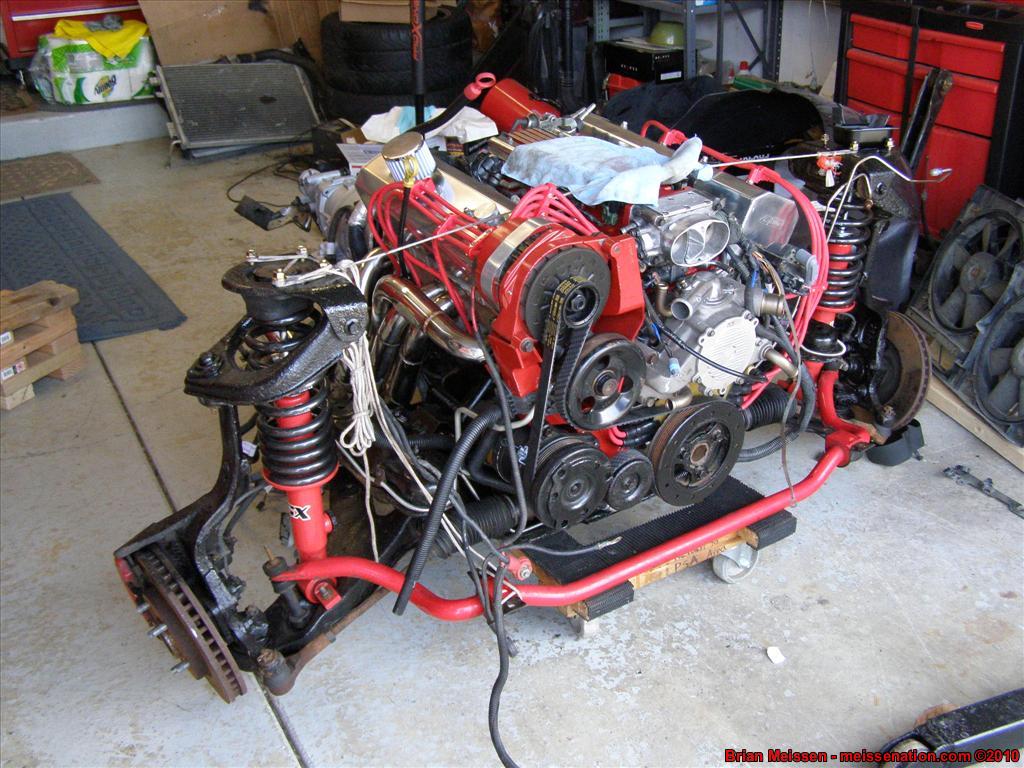

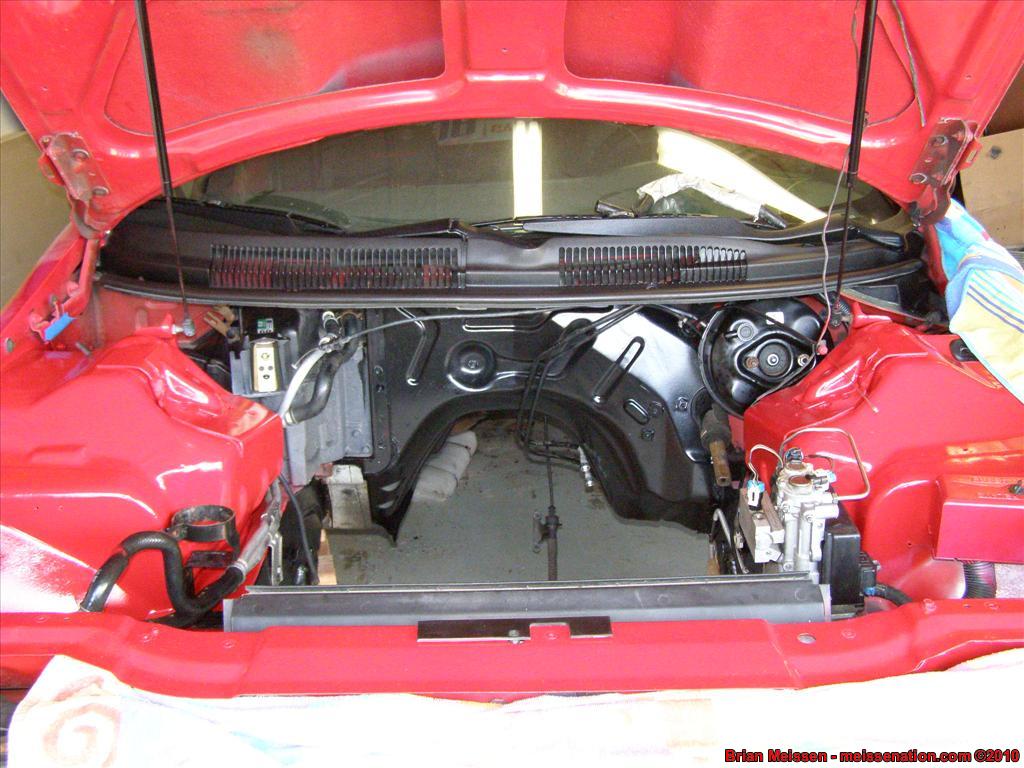

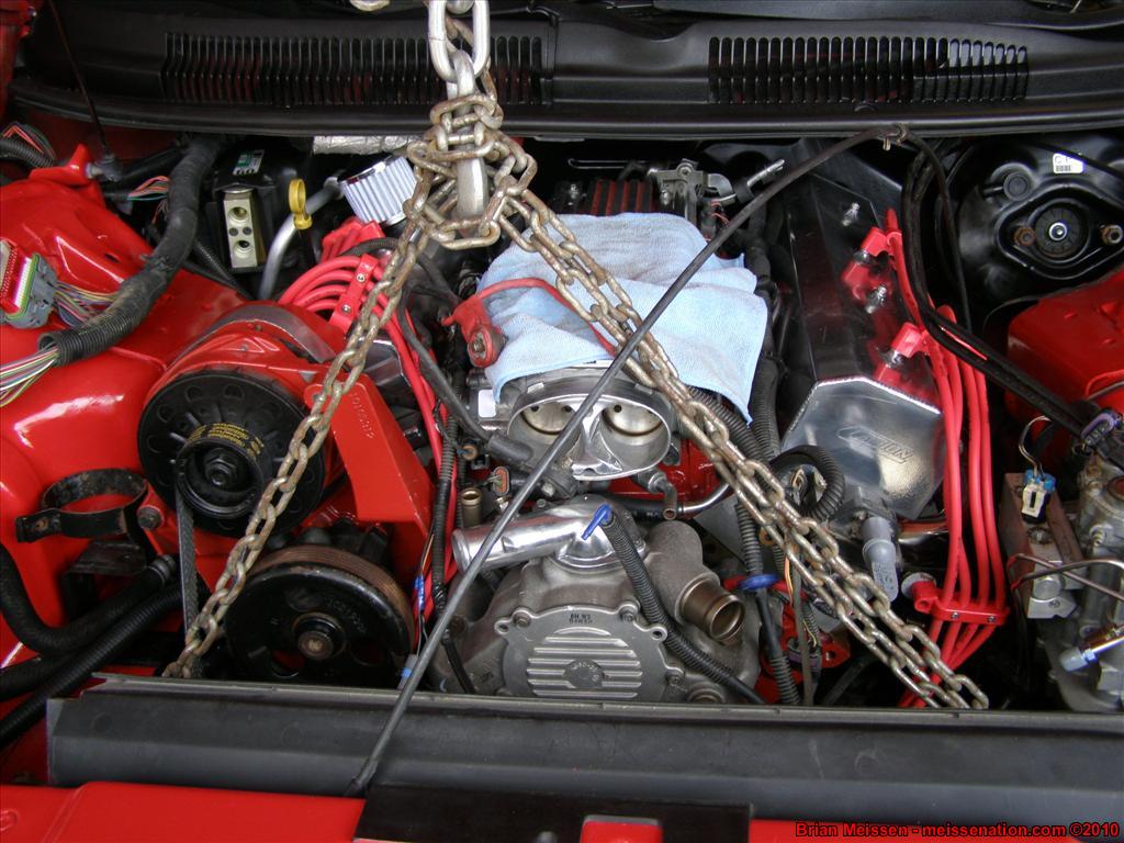

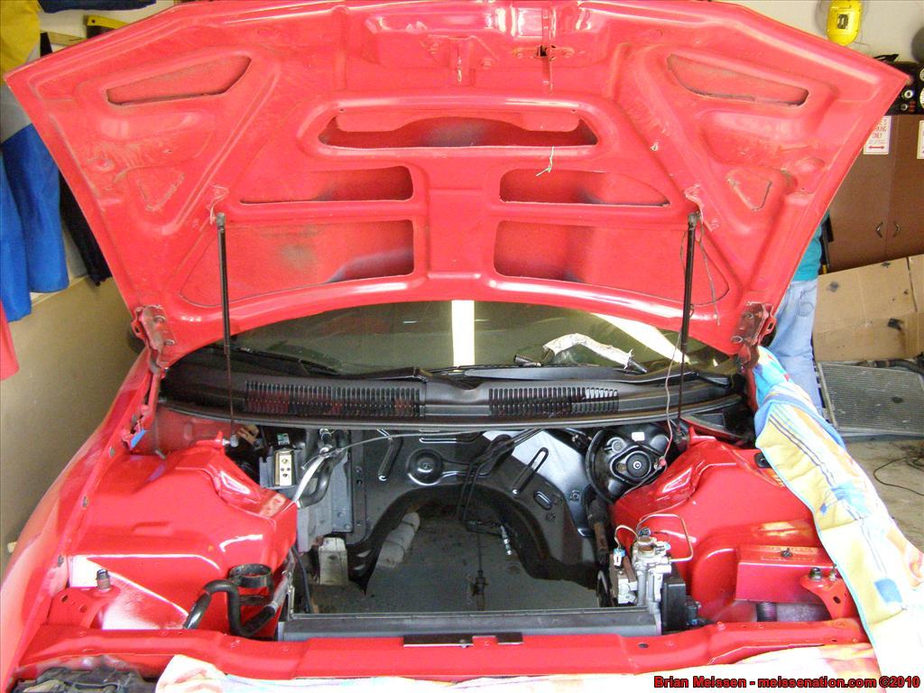

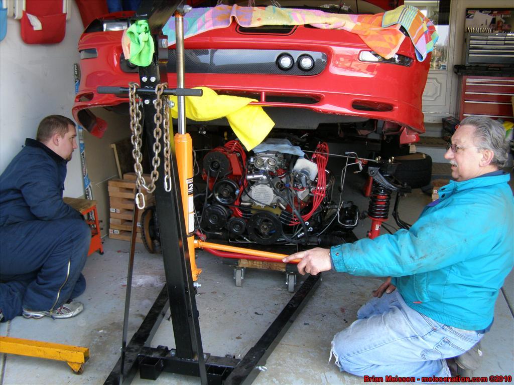

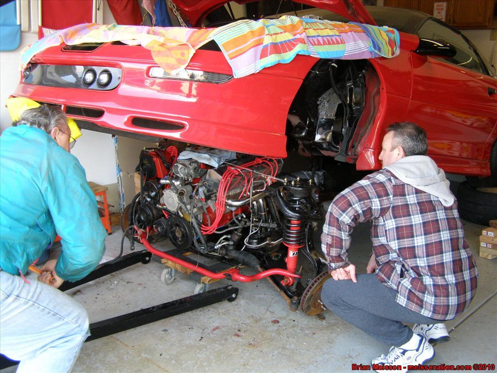

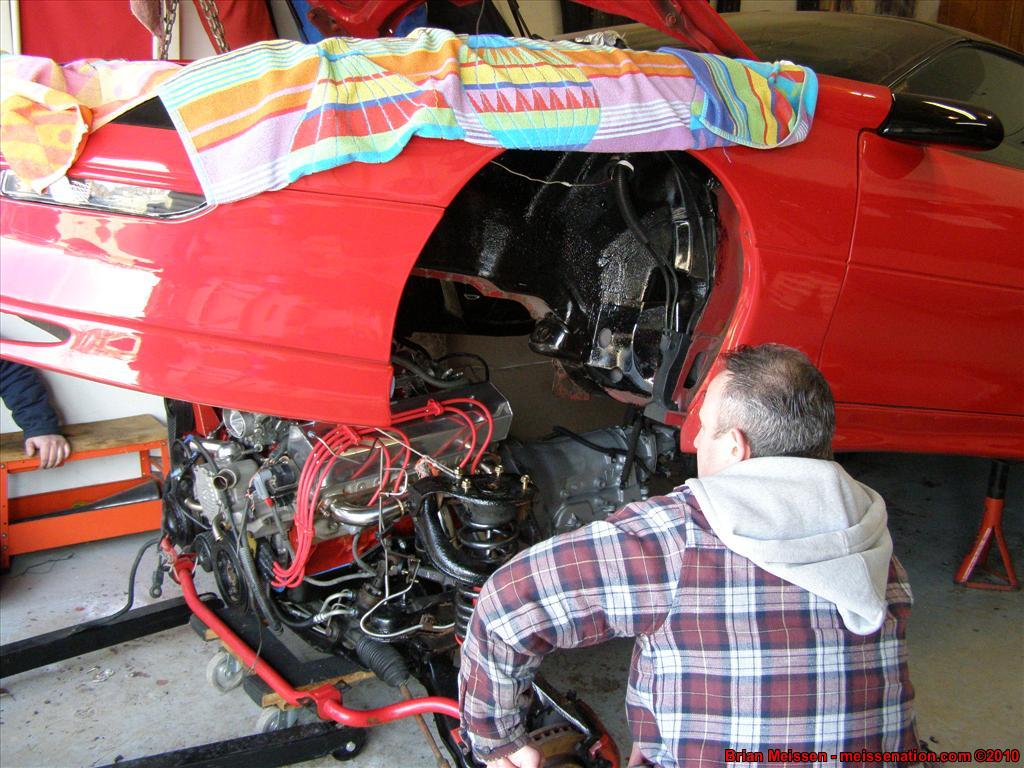

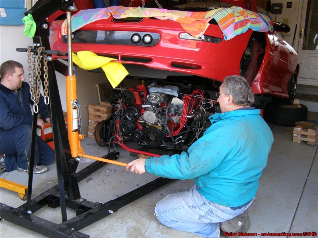

              • OK it looks like the V8 transmission crossmember is identical to the v6 but the hole is elongated for the v8 crossmember. That's where my problem was - the v6 crossmember hole for the transmission mount (directly in the center) is circular whereas the v8 is elongated. We elongated the energy suspension transmission mount's holes because the metal is thinner.

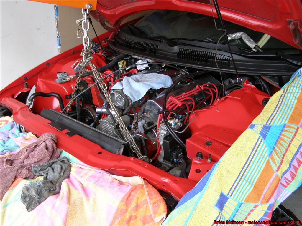

                And damn is it easier to lift the body off the kframe when removing the engine than it is to drop the body onto the kframe.
                Not in this order, but...
                We lowered it and then realized the wiring harness and heater hose tubes were not ran correctly so we had to raise it back up for that.
                We lowered it and then realized the transmission dipstick was pushed against the windshield cowl (we had to route it over the valve covers) so we raised it and fixed that.
                We lowered it and then realized the steering knuckle was kinked so we raised it and fixed that.
                We lowered it and then realized the torque arm bracket was in the way of the torque arm and the exhaust hanger bracket was cocked at a 45* angle (we ditched that all together), so we had to raise it up and get rid of the brackets to get it to work.
                But yeah, we still have a few electrical connections to figure out (wheel sensors) and then the radiator and connections for that. Plus I can't find the damn bolt for the battery tray/coolant overflow.

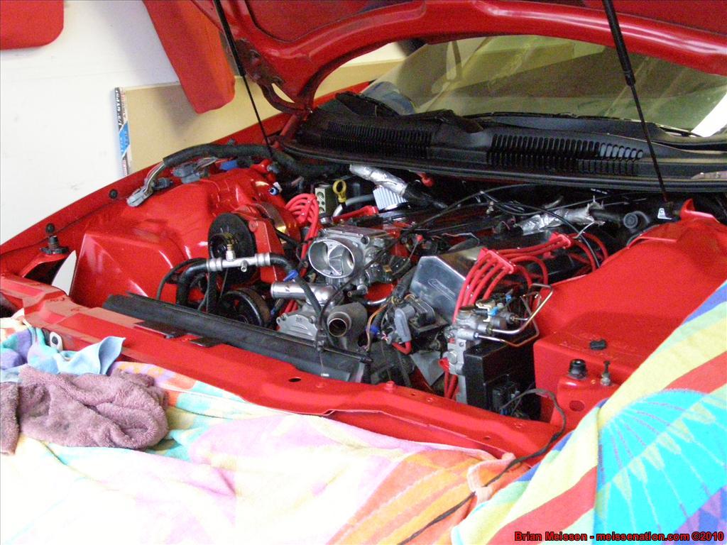

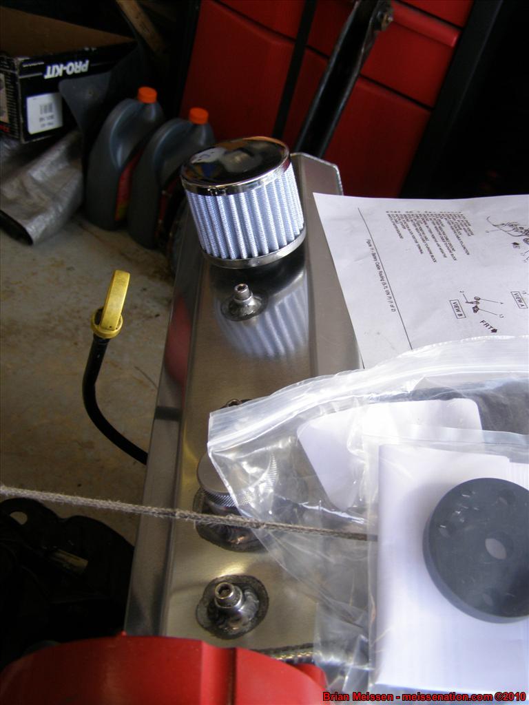

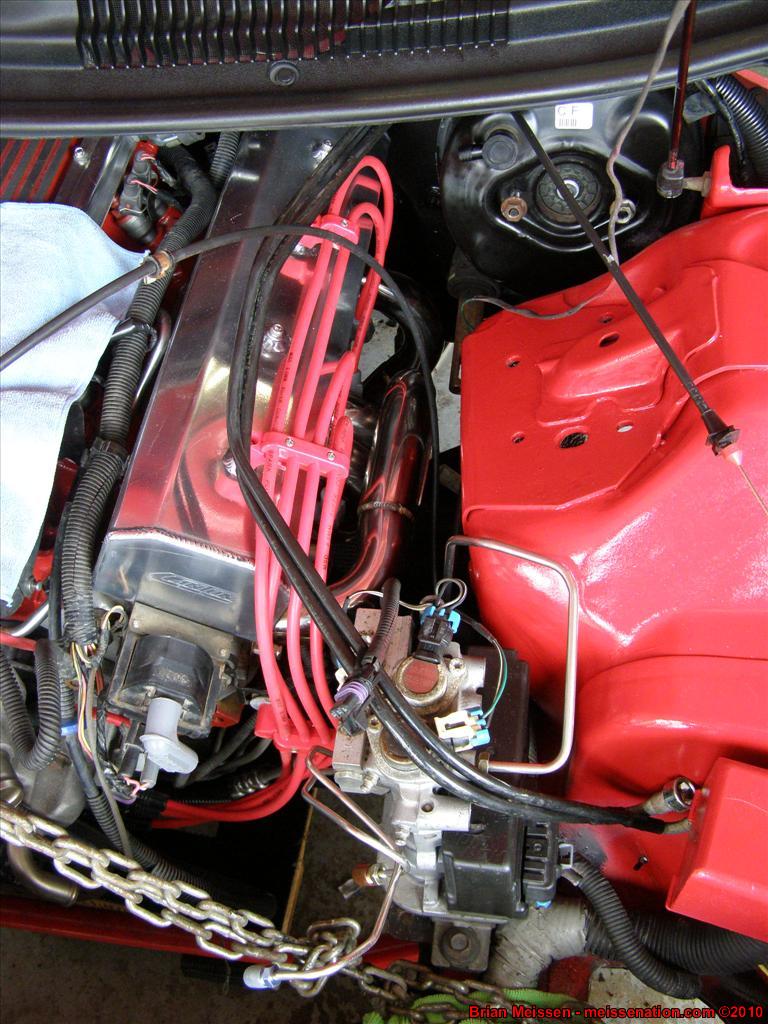

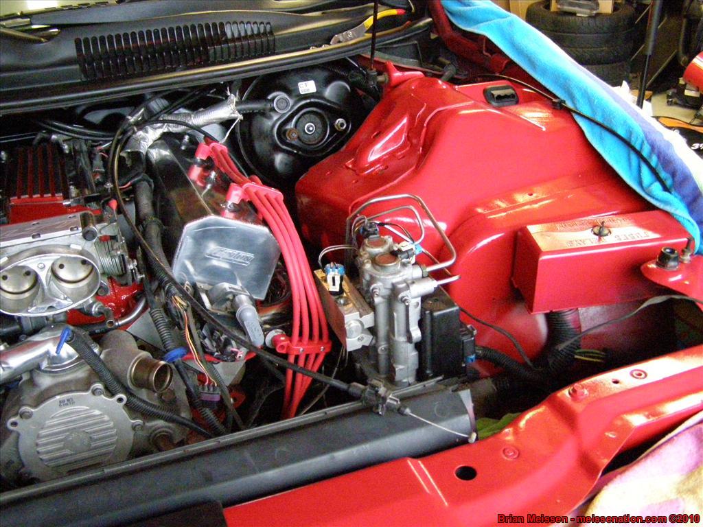

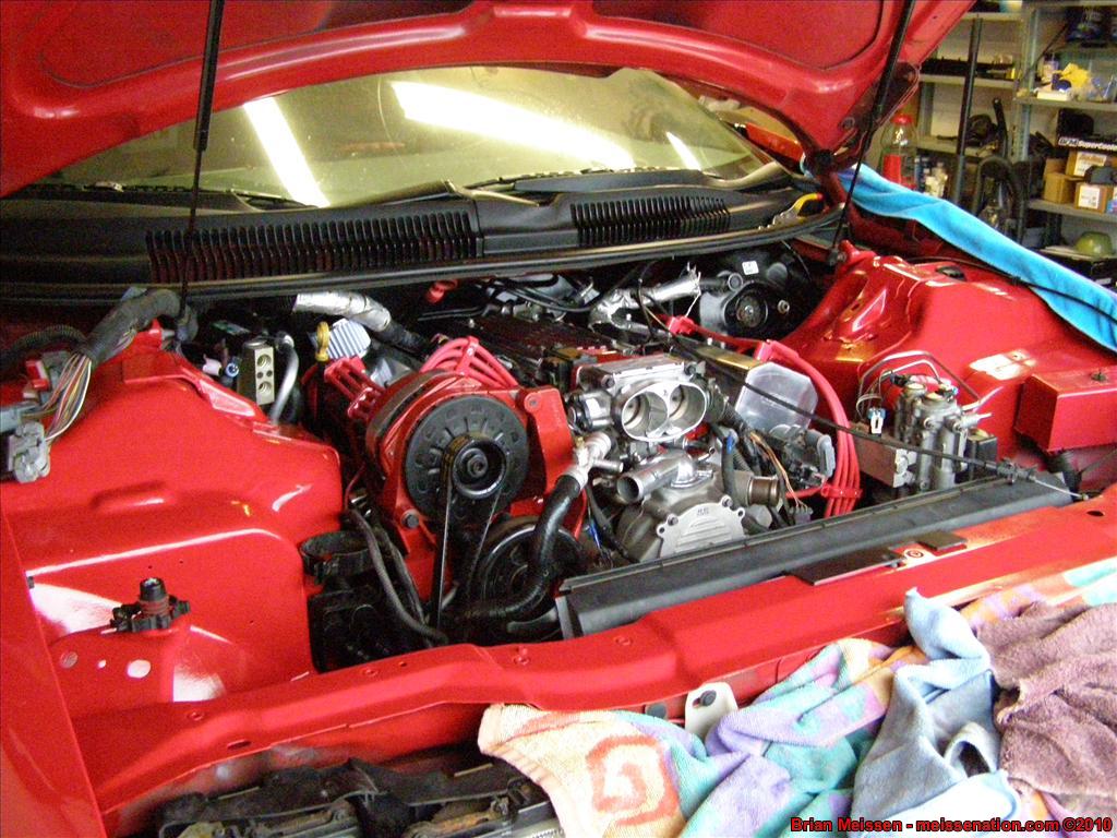

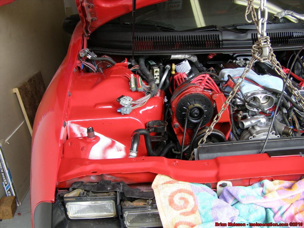

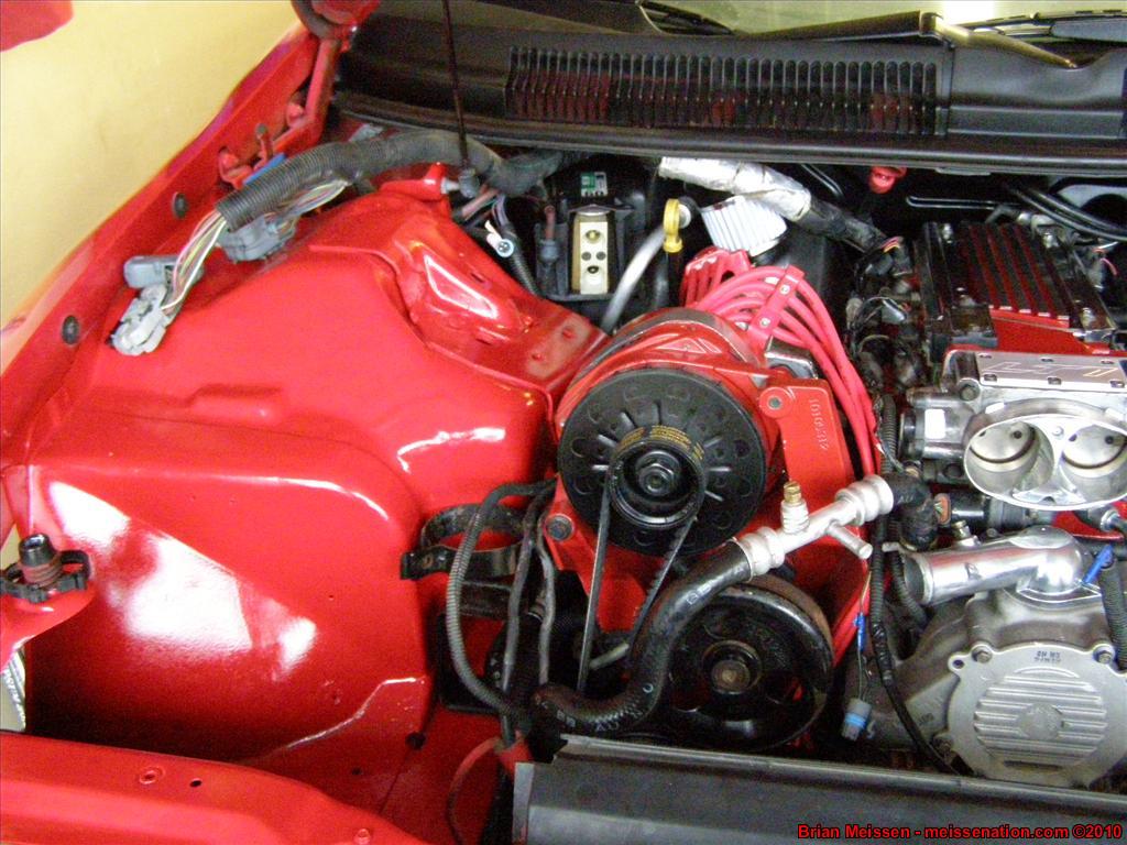

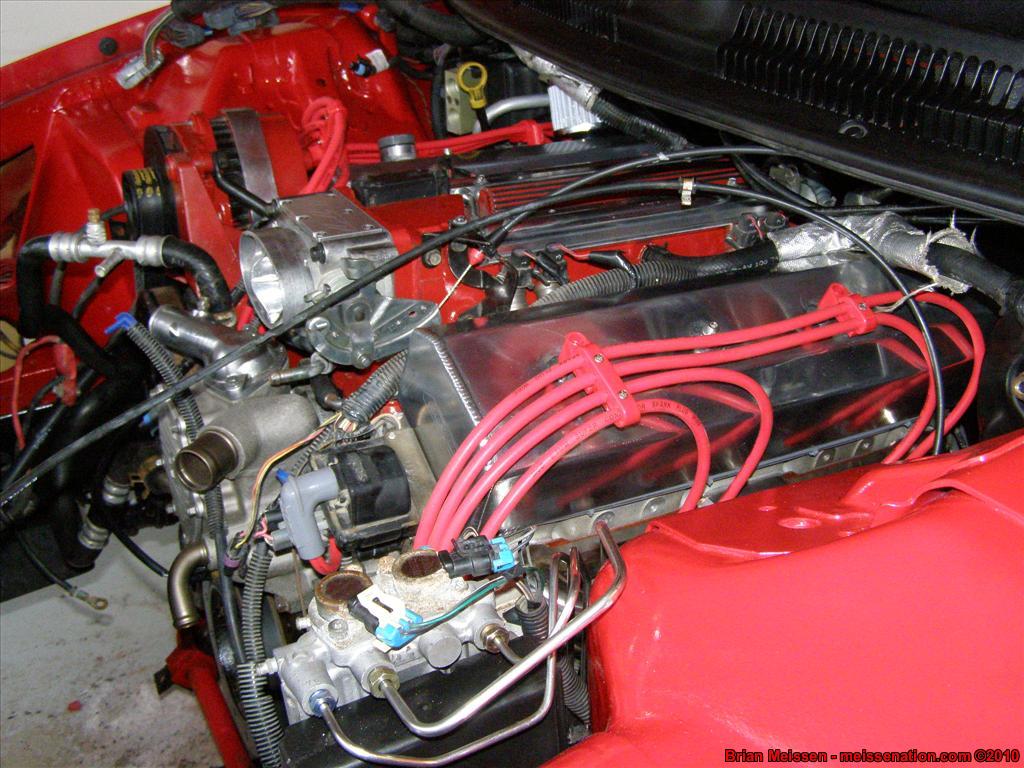

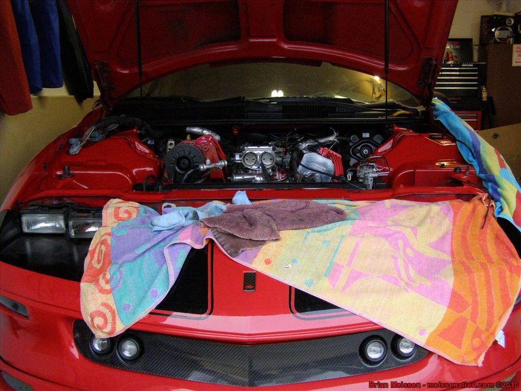

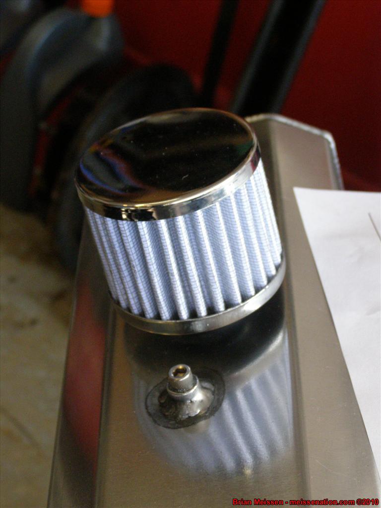

                • So I found a cheap-o breather filter to throw in, hence first pics.

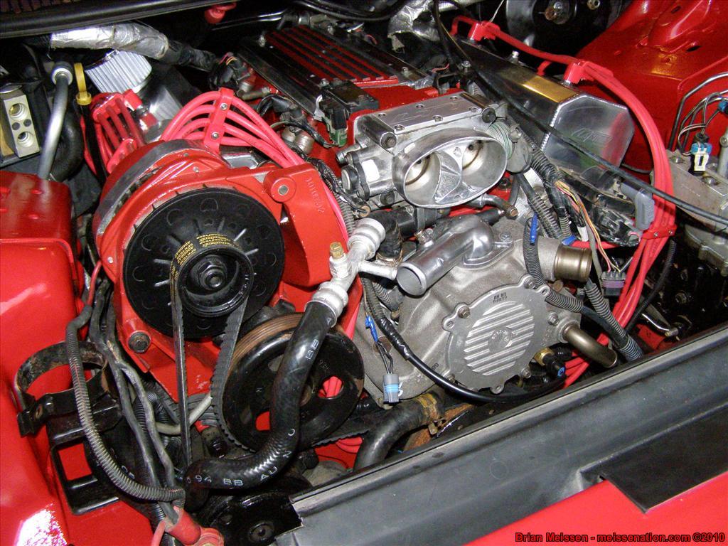

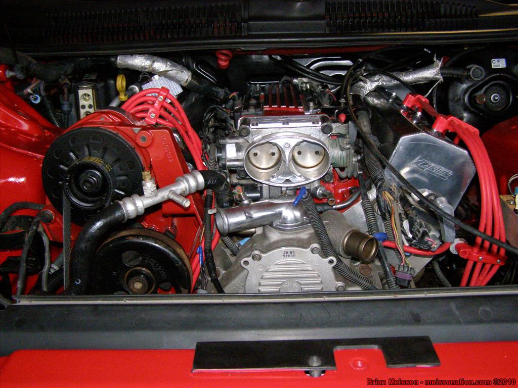

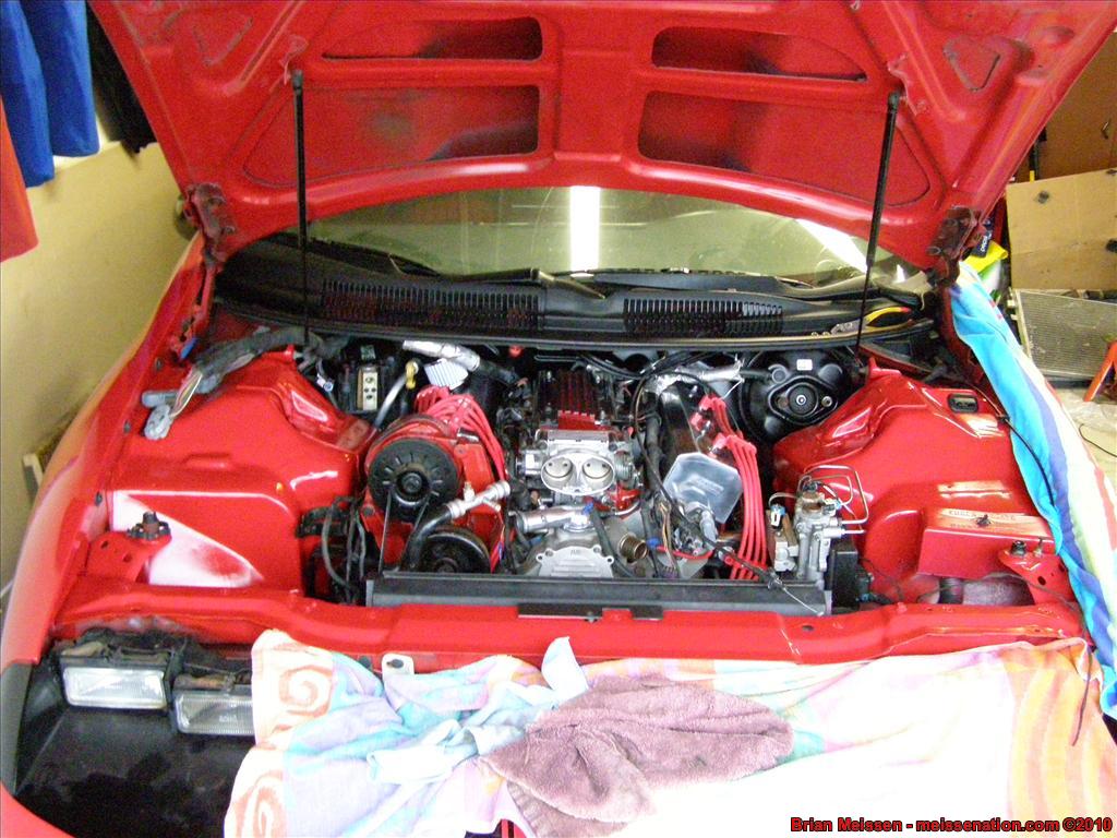

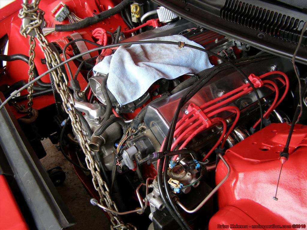

                  We went to route the spark wires in the stock location and it flat out wouldn't work. The headers were just way too close to the spark plug wires for my comfort, so we went the OTVC route. Honestly, I think it looks great and it doesn't hide the valve covers as much as I thought it would - plus it's real nice and organized.
                  If you look really close you can see the fuel lines hanging down still, gotta mount them under the windshield cowl.
                  And I have tons of clearance for the headers.

                  • Looks great Brian!!
                    2015 Silverado
                    Originally posted by JoeliusZ28
                    If you need 6 and half grand to break your tires loose you shouldnt be attempting a holeshot.

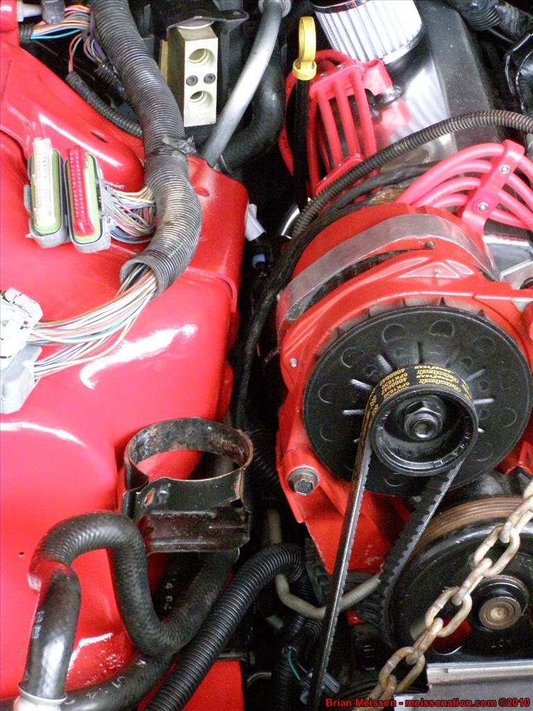

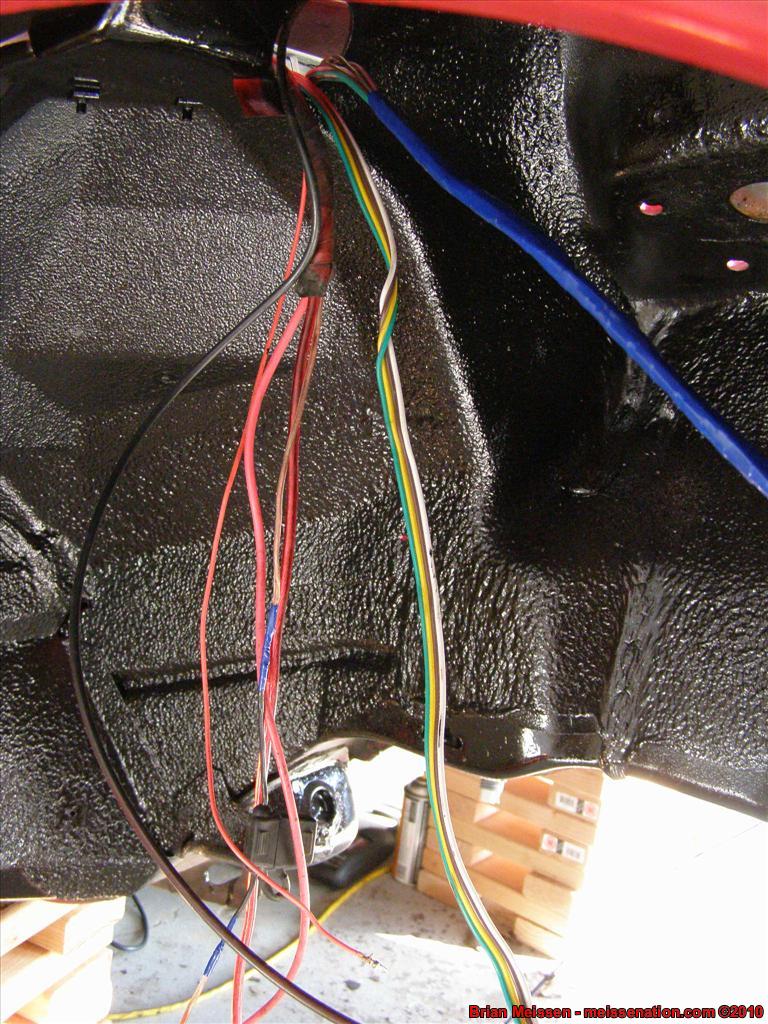

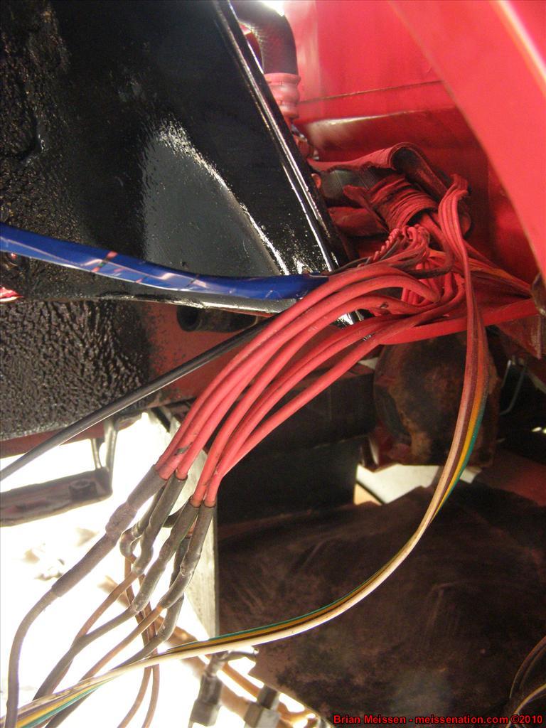

                    • Awesome progress! Gunna look WAY cleaner than mine! But what is that mess of wire in the pass fenderwell? Im doing the !wire mod also, but I didnt cut or strip anything?
                      • looks clean and amazing going to be great to see it in person
                        • I got a lot of work to do on the passenger side. There's a mess of wires that go along the battery tray, and then the !pass wire mod I undid the wire wrap when we pulled the v6 out. I'll have to buy new wrap and put it on so it will look OK.
                          • Any reasoning to undoing the pass side wire wrap? Is it different for the lt1 cars?
                            • Looks AWESOME B
                              • Just from the pics alone it looks bad ass! Really makes it worth all the hard work you guys are putting into it.
