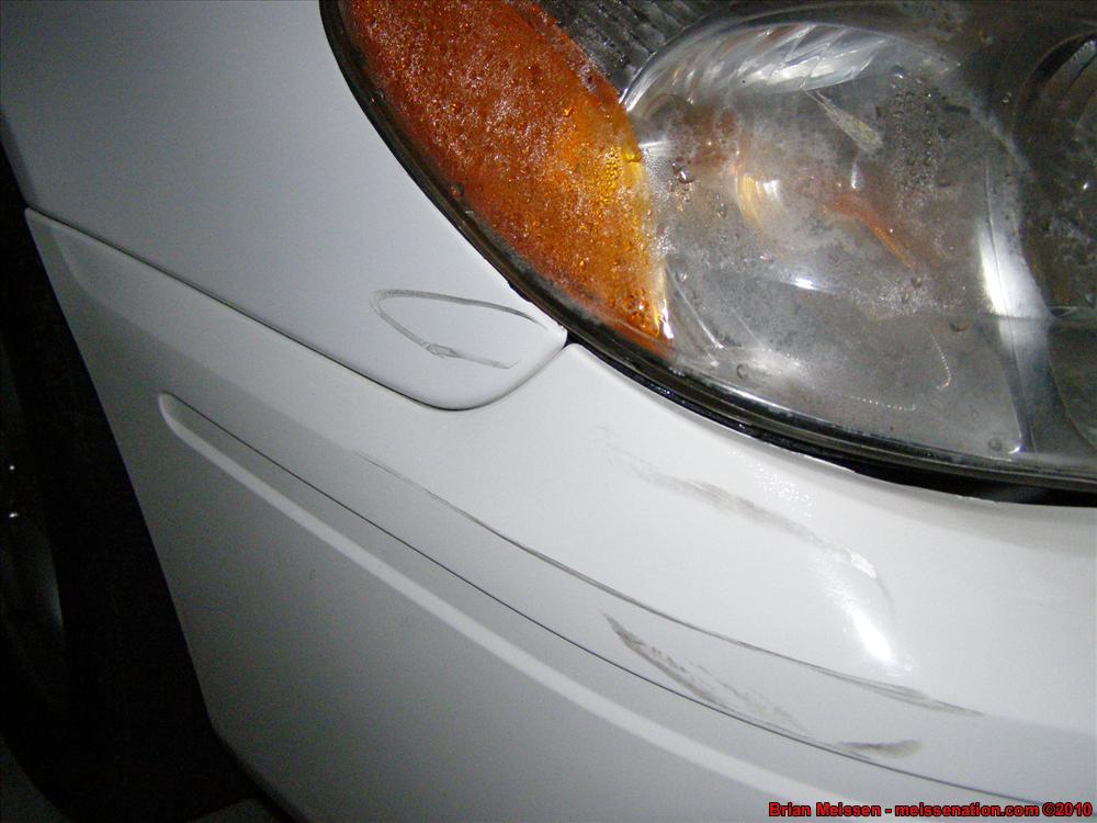

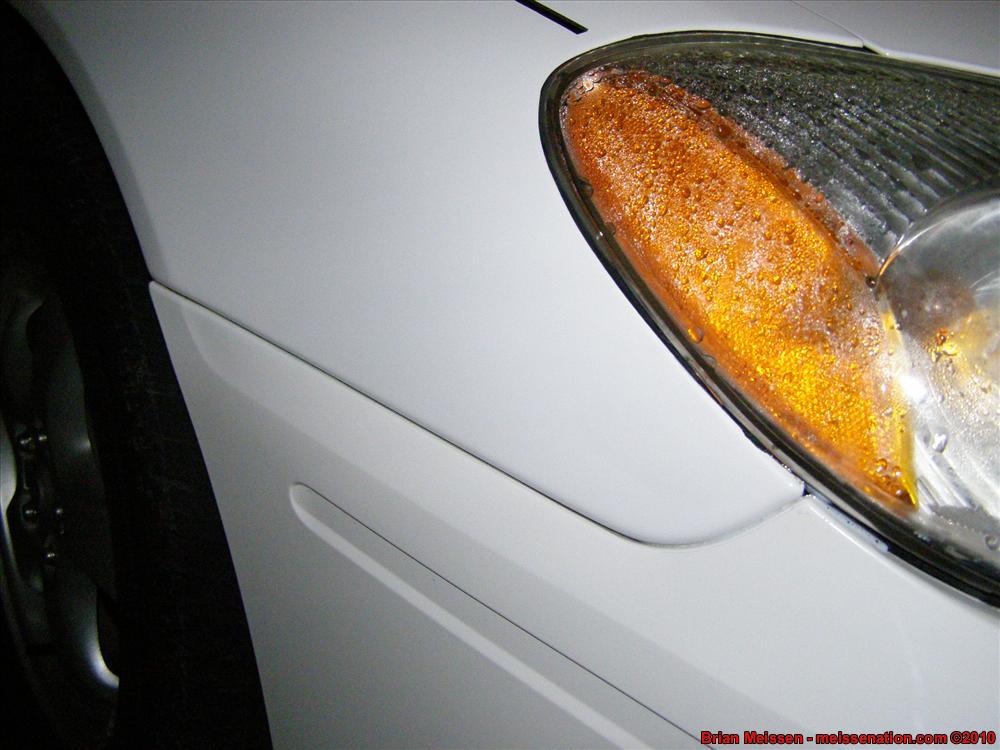

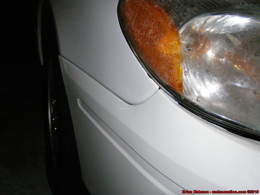

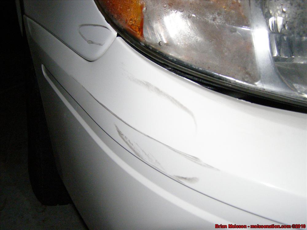

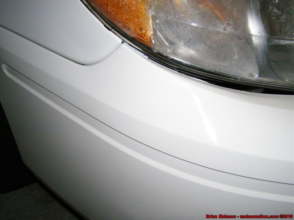

    Anyway, Ang was driving to work today and when she went to turn her car kept going straight... right into the dousche that parks on the corner. She just skimmed his car's bumper, no damage on his car. Her bumper had a few scuffs, pretty superficial. The "before" pictures were taken after buffing it with Meguiar's Quick Detail spray, so the scuff was kinda in there, but not dented or scratched into the paint.
    BEFORE:
    AFTER:

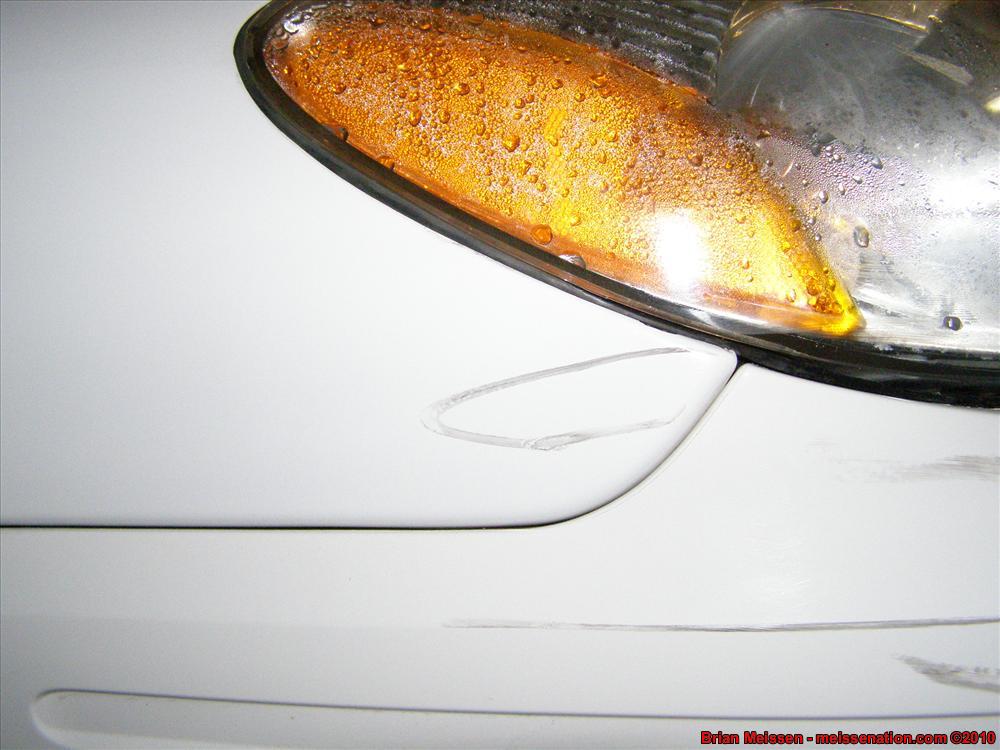

          holy condensation in the headlight
          nice job with the clay bar
            When I first got the car I didn't know the passenger side headlight did that until it rained. I am going to have to get it looked at.
              x2...lol...
              One potential fix for this is to drill two small holes (one top, one bottom) of the headlamp housing rearwards behind the reflector...not a perfect cure, but it may help. Have seen it done on other cars with some success.
                hmmm, looks good. I guess the ICE Liquid claybar does a decent job. I wanted to try it but I always thought the actual claybar was better. Maybe I'm wrong from these pics. Glad you and your car are both okay.
                  How long did it take you to get that out lol
                    less then 5 mins.
                      About 45 seconds.
                        HHmmmm, I should try that on my wifes rear bumper this spring since we traded some paint with an old lady in her Grand Am.
                          yeah I like it too. Awsome job! Quick and easy.
