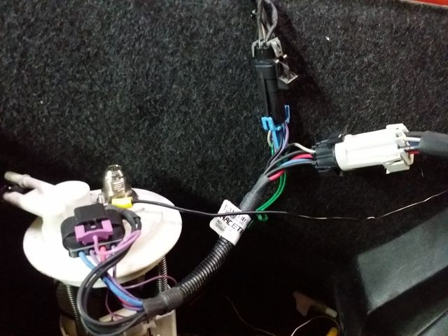

No power out of 4 pin connector for fuel pump

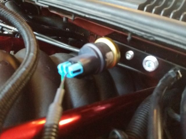

    Are the wires going to the crank sensor ok? They like to burn on the headers.
      Yes. Car never had a problem until i switched to this set up. Trying to make this sound less confusing as possible im terrible at wiring lol.

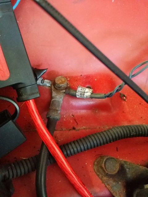

        do you have a pic of the hotwire kit used? where to the two sets of black wires that are on the stud come from
          Yea ill get them later today.
            Grounds

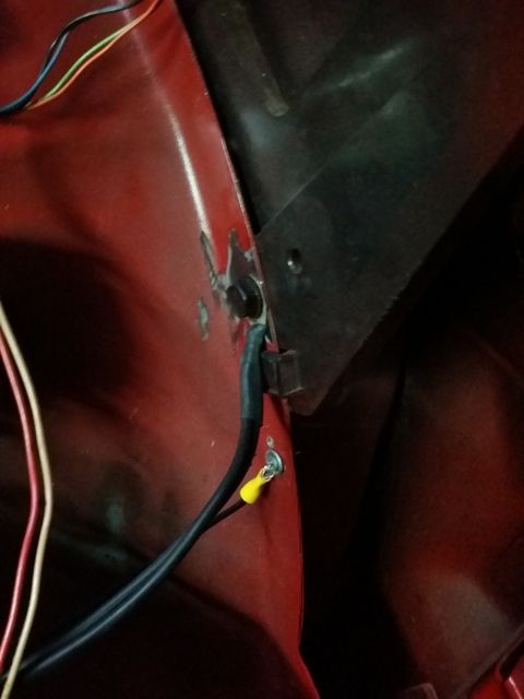

            Front ground

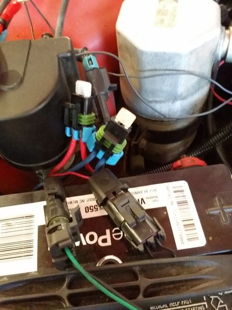

            Fuses

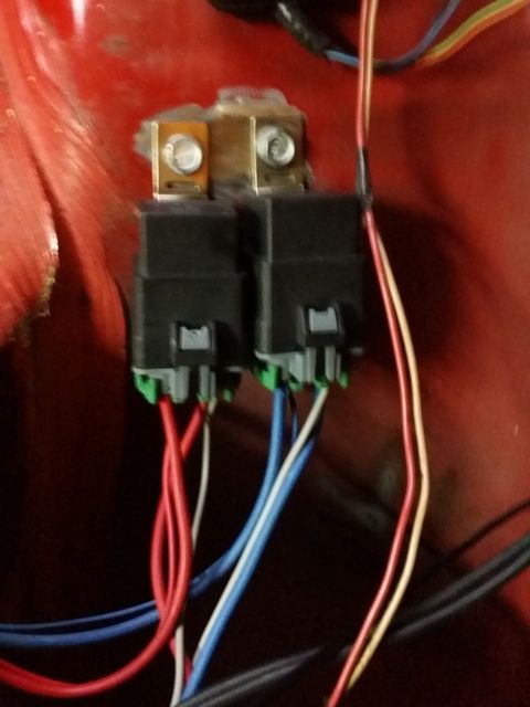

                Where do the two grounds (grey wires) I Believe at the relays go? Did you add the little ground from the pump to body?
                cant tell from the pic but in the white connector at the Y- it kinda looks like the red and blue wires are in diff spots at each side??
                  The photos are all labeled wrokg idk why they didn't post in order. I added a extra ground to the pump to the chassis
                    Threw the stock pump connectors on thr stock pump and wallah power to pump. So obviously its something in the racetronix kit. Thinking relays.
