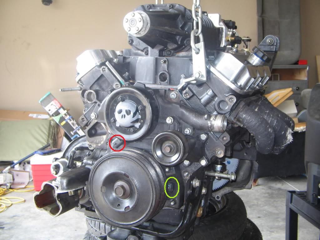

            CKS is on a plastic collar on the right side of the engine (looking @ the pulley) Cam is in almost exact same position but on the left (rear) side Ill try and post some pix in about 15mins or so...

              as promised
              Red is Cam (CPS)
              Green is Crank (CKS)
              to replace the CKS, youll need to remove the balancer and the palstic collar (15/16")
              the cam you can USUALLY get out w/o remocing anything aside from the belt and water pump pulley (4 x 8mm bolts.. i think they're 8, they may be 6mm)
