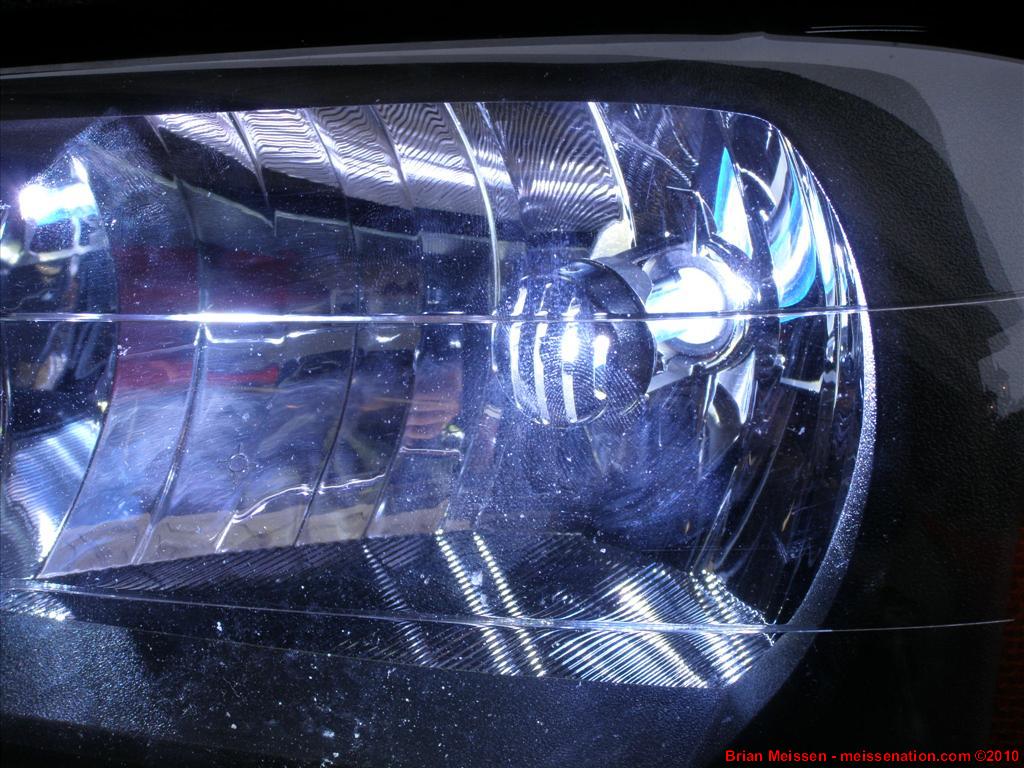

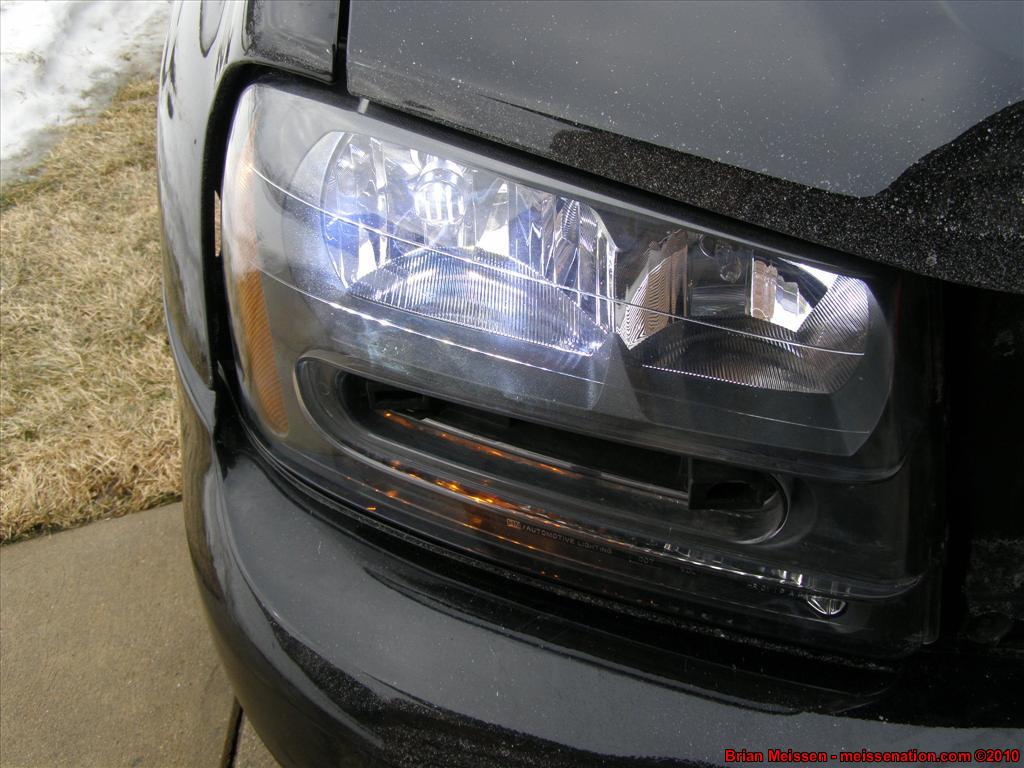

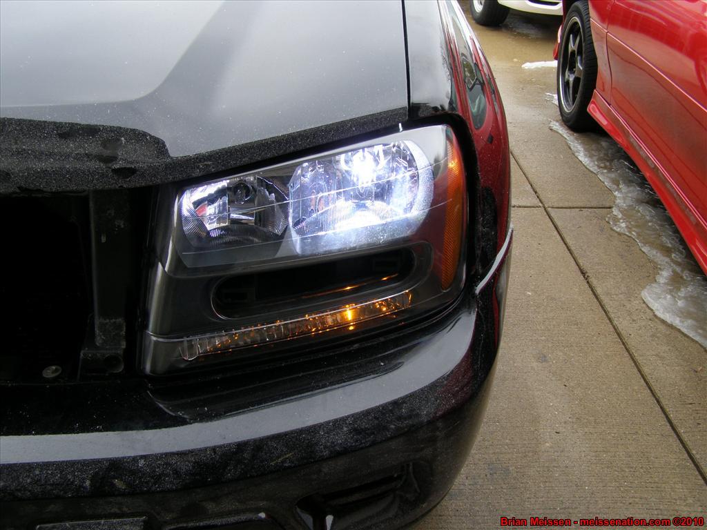

    I can't wait till tonight to see how much brighter these are!!!!
    Before:
    HIDs:

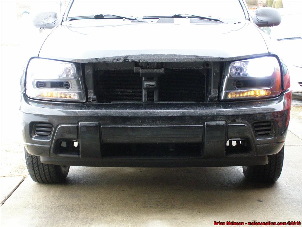

                        I would estimate about 2 hours taking a very relaxed slow pace. Took my grill and headlights out before Angie got home, then we ate dinner and watched Wall-E on TV, then a little later I went back to work on putting the HID bulbs into the headlight housing and getting it all wired up. Then this morning I installed the ballasts and the relay I needed, installed the headlights while I plugged it all back together, and then reinstalled the grill.

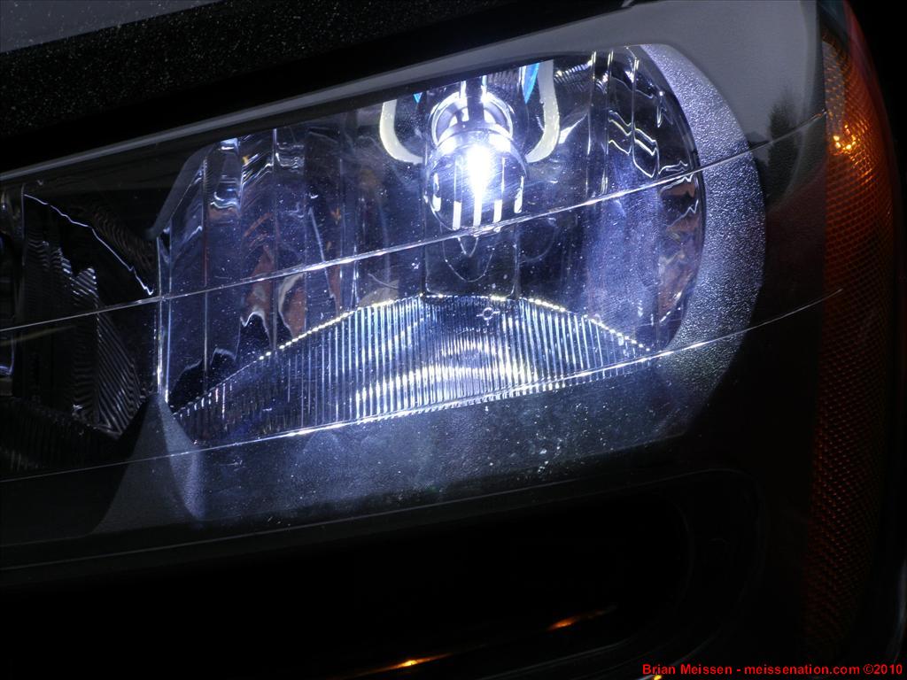

                        That said - for us FBody guys, I think this should be an extremely easy install... just need to find a spot for the ballasts. The stock 9006 bulb plug plugs into the ballast and then the ballast has a cord that plugs into the HID bulbs. So when the car gives the power to the stock plug harness, that powers on the ballasts which turns on the HIDs. The trailblazer was a little more fun because I had to have a relay wired in with it.

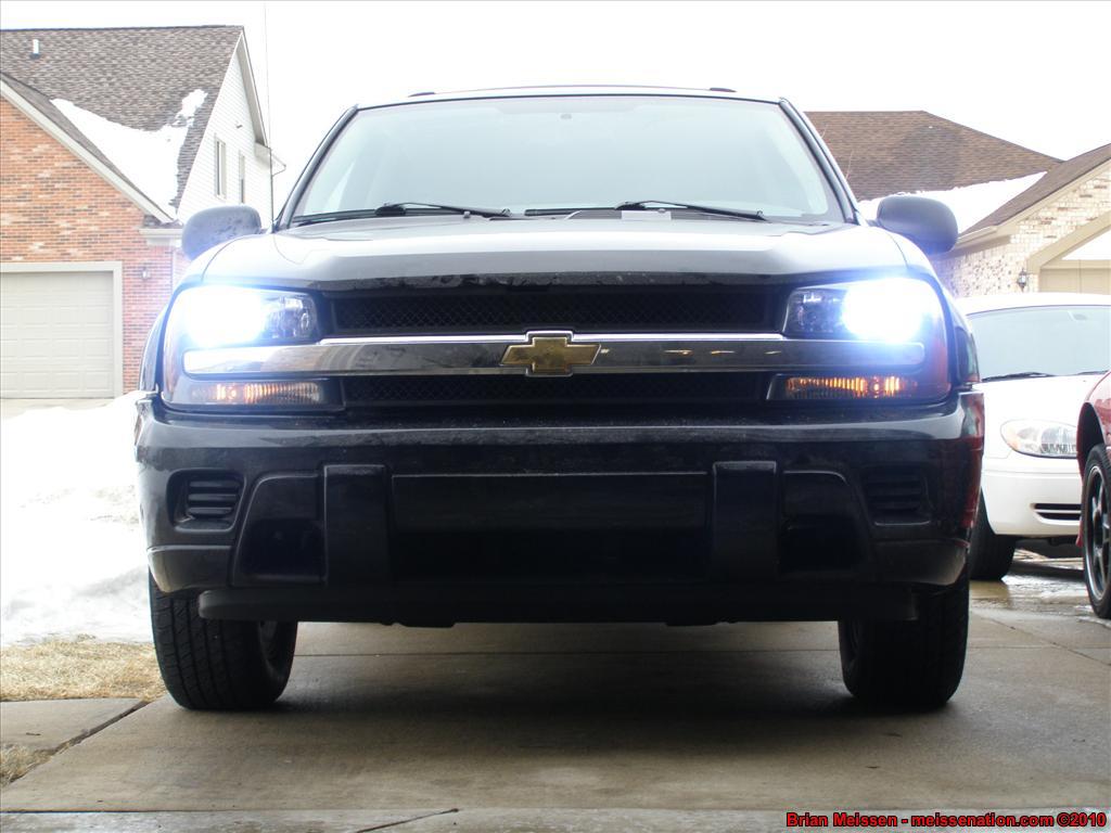

                            Yeah, tonight I'm going to adjust them the best that I can so they're not blinding. But man at dusk driving around with these on they look freaking sweet!
