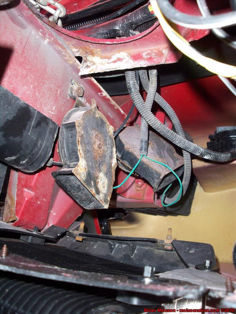

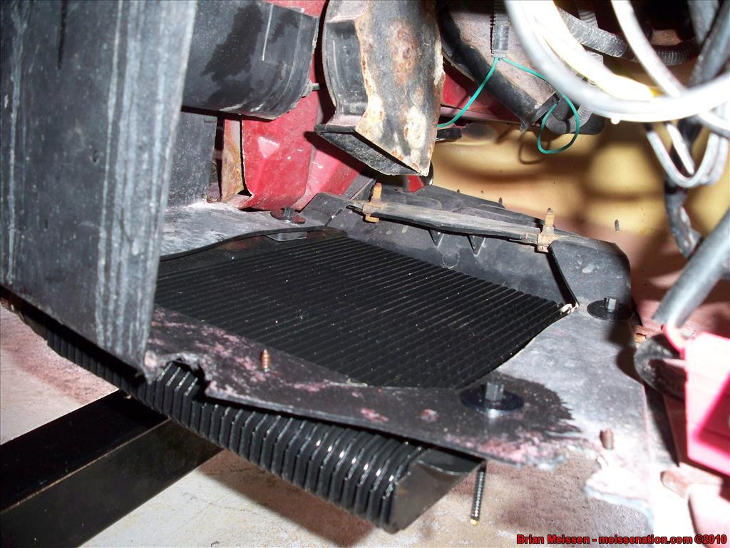

                              While mine is an LT1, I plumbed mine in using rubber tubing right infront of the radiator. I tapped into the steel line that was coming OUT from the radiator back to the transmission and diverted it into my trans cooler, then had the OUT line from the trans cooler going back to the transmission steel line. I then put my trans cooler up where the air horns are but we cut a hole in the splash guard so the air comes in before the air dam through vents (when you're under there looking at the splash guard, you'll see what I mean) and then it flows down through the cooler when it comes out of the splash guard.
                              Pics:
