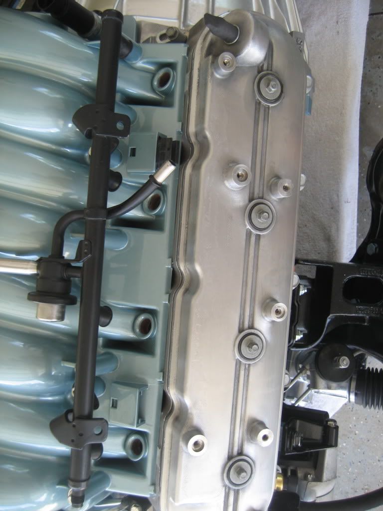

                  Now for a little modern Pontiac - The big brown truck just dropped these off and of course they will need to be modified. I already reworked the fuel rail so the fuel line enters at the rear instead of the side of the fuel rail cover. Then the GTO script will need to be removed, painted and hmmmm?

                    Nice looks as your making great progress. When you drop the body on the kframe/engine is best to have engine on 4 wheel dolly for movement and adj. 3 people are best for job, one on each side and one to lower the body and watch the front. OBTW we also had engine wire harness installed before we installed engine.
                      Larry thanks. We must think the same! The orginal 3.8 engine and trans was lowered out of the chassis on a cart and the new powerplant (as seen in previous pictures) is already loaded on that same "home made" cart.
                      I'm glad you said "3 people" because if you would have said "4 people", I would have to recruit my daughter or wife and they would not be cool with stepping into the "MAN CAVE" garage.
